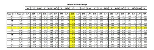

Here is the chart I have been using since he first shared this...
Post #58 of this thread is a PDF from Stephen Benskin "Contrast Index a.pdf"
EDIT: Rats. That's not the right chart. I swear he posted it here and now I can't find it.
Will follow-up when I have a link.
Found it!
Here is the Contrast Index recommendation chart that I use: Post #38
Note: Stephen Benskin is working on an update to it.
Note: This chart is based on the "0.4 Flare Model" the improvement Stephen is working on is a practical flare model which takes into account different ways flare plays when you have different subject brightness ranges.
Another Note: Far right column is 10 stops (they ran out of room and decided if you get that far, might as well jump a whole stop... and the column got mislabeled).

BetterSense,
If you get to look at that chart, it also can give you an idea of the tolerance: 0.75 is good for Grade 1 and 0.52 is good for Grade 3.
If you were to dunk all your film for the same time... and that gave you anywhere from 0.52 to 0.75... As long as the subject range is "normal" 7 stops you can fit on paper from Grades 1 to 3. So you CAN develop all your film the same time.
But there is a trade-off...
For roll film, you use paper grades to accommodate varying subject brightness ranges. If you choose to be careless with development time, you take away from this tolerance. Normally you develop film to 0.62 and you are covered for brightness ranges of 6, 7 and 8 stops (you are safe for N-1, N and N+1 in Zone System terms). Examples: If subject has 6 stops brightness range, Grade 3 will fit... If it has 8 stops brightness range, Grade 1 will fit.
If you develop a particular film to 0.75 and it happens to be 8 stops subject brightness range... You'll need Grade 0.

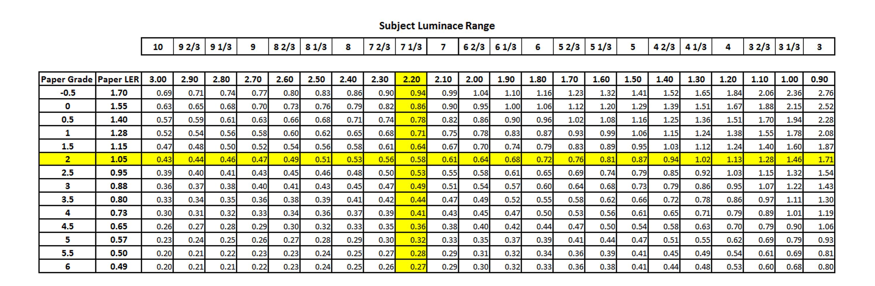

Here is the table Bill was talking about. It does reflect the my practical development model as explained in my paper "What is Normal?" While you can use the LER for any type of light source, the placement of the grades are based on contacting / diffusion enlarger. The equation to determine CI / Average Gradient is:
Paper LER / (log Subject Luminance Range - Flare)

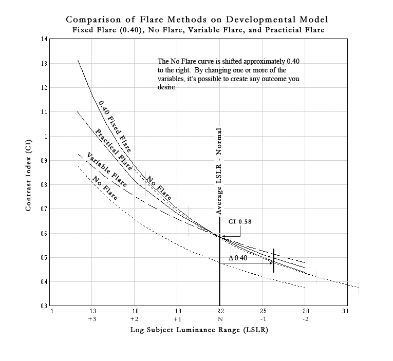

It's 0.615 for those conditions, the ISO standards contrast parameter measures the curve differently than contrast index or average gradient. With short toed curves, the difference is minimal, but longer toed curves can have CIs and average gradients higher than 0.615 even though they fit into the ISO parameters.
The table is a spreadsheet. The difference is the flare model. Without going into detail, I've never liked how either the fixed or variable flare models work in the more extreme Luminance ranges. Here is a comparison between different flare models.
