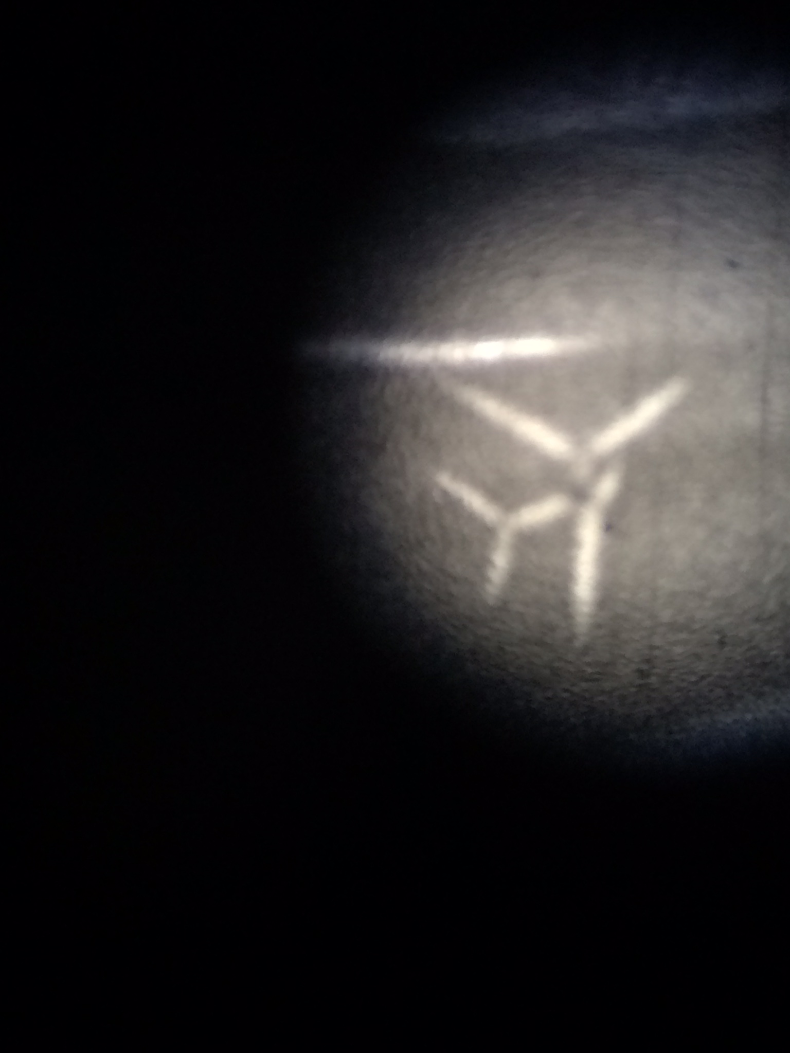

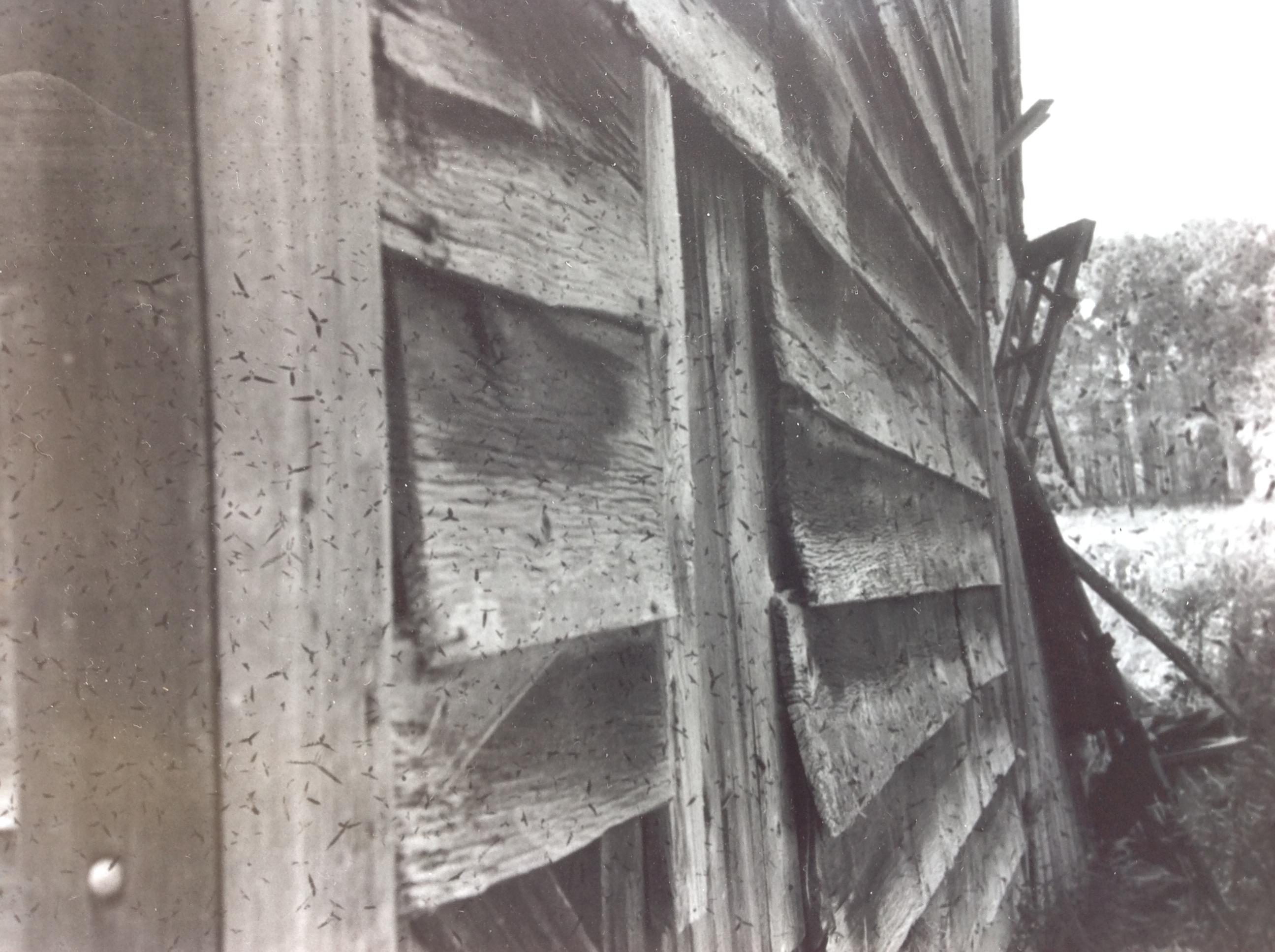

We are still having troubles here. Freestyle is convinced that it is NOT the film. I'm still not sold. I've tried many different methods of mixing/cleaning/straining the D76. The print dryer points are excellent - it is a tight spot, especially for the row by the wall. I have had some stick at times but only resulting in the stuck emulsion marks, not these. There has been random results with the location of the film hanging too - some have hung alone and still had the Ys.
For what it's worth...here are some close ups of the negs and a new print. She thought it was cool...looking like an attack of birds! At least a happy outlook. Not from me...
photo 1-1.JPGphoto 2-1.JPGgranted, there there are some extra smudge/scratches, but no evidence of dents to emulsion or other marks. If blown up you can definitely make out the Ys
photo 3-1.jpg "Attack of the birds"

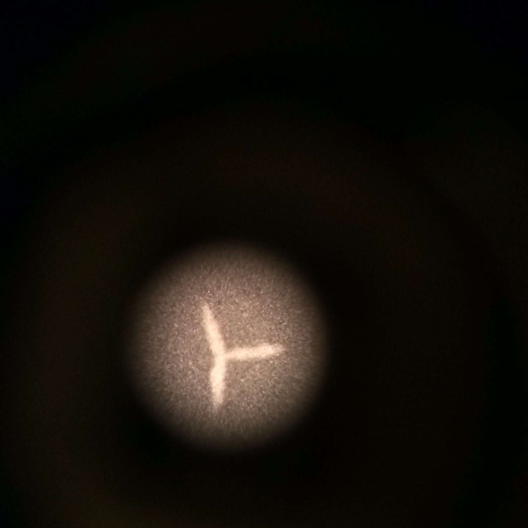

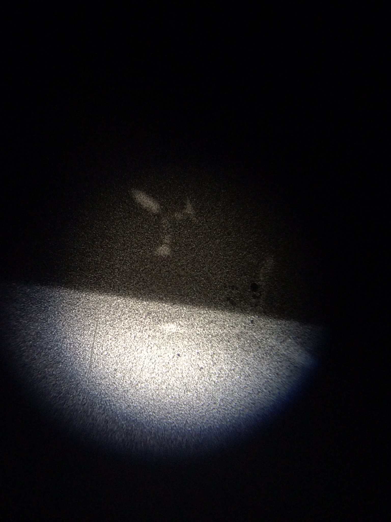

Here are some microscopic images of the negative photo 2.JPG photo 1.JPG photo 3.JPG this last one shows the Ys going out of the frame (in between neg images)

They almost appear to be where hot emulsion cooled rapidly leaving small tears.

It has nothing to do with the drying process. My money is on a chemical contamination or precipitate problem in the developer, or related to the developing process or technique. For example, crud sticks on the film pre-development or during the development, preventing development, then fixes out as clear specks, printing black on the print, as shown.

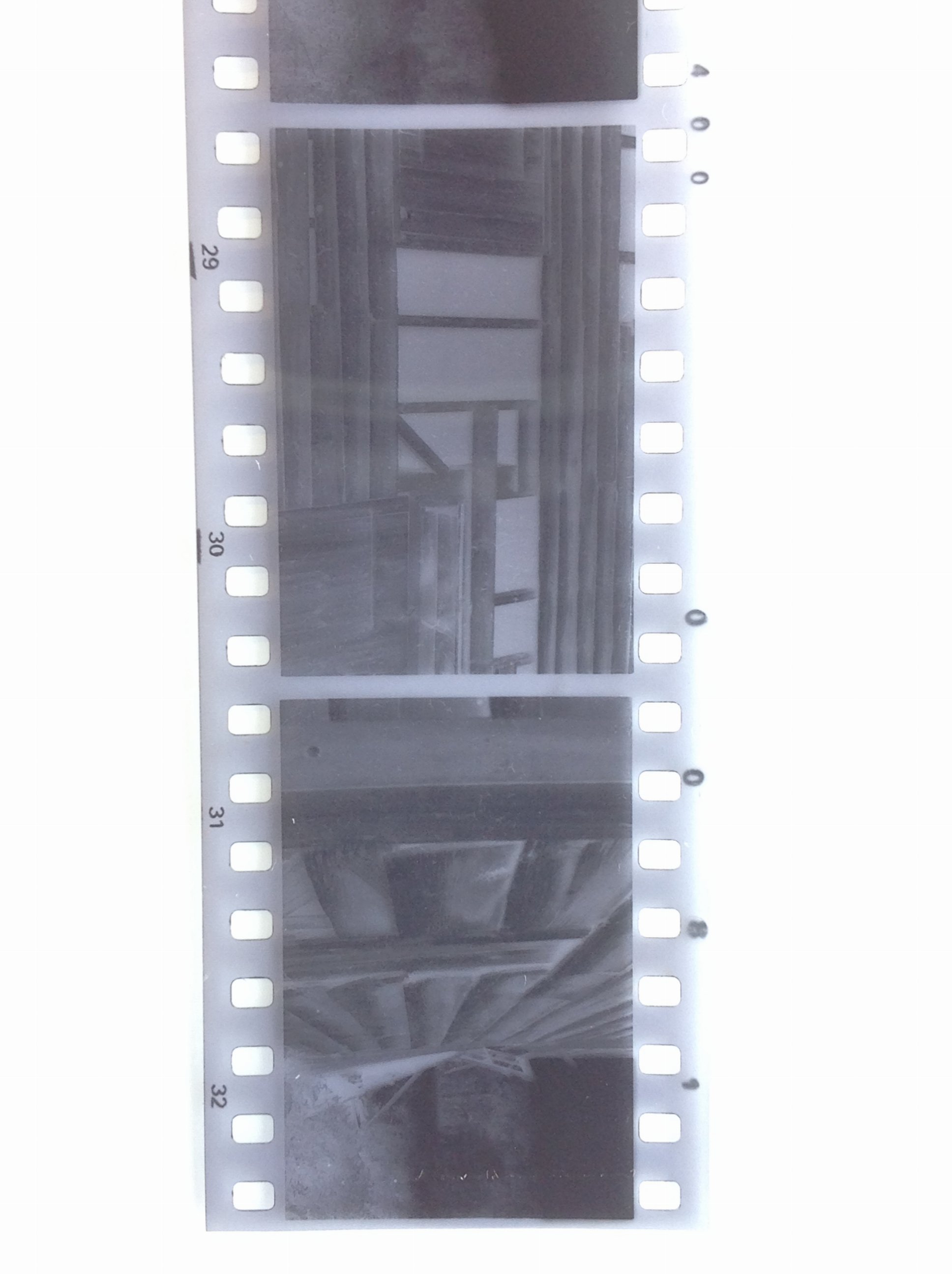

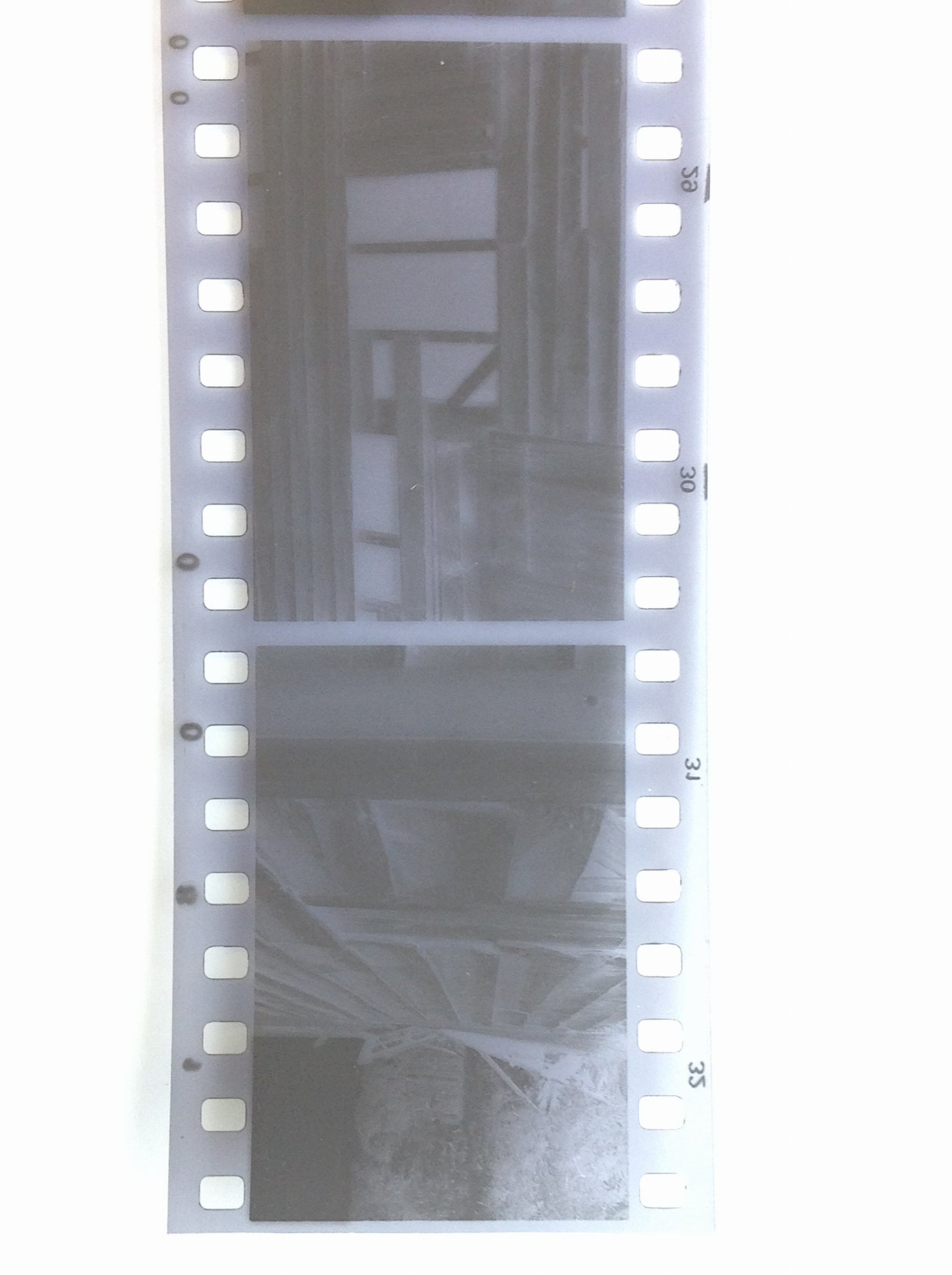

The full negative scans show poor process techniques and rough handling.
Look to the right of frame #32 and you see a scratch that runs full width. See the black half moon? That is kinking. See the bright halos around the sprocket holes? That is bromide drag from bad agitation. You have just about every problem here that a beginner can experience!
I said earlier that it is not the film as you are using 2 types of film. I am less inclined to think it is the chemistry as well. I am now inclined more than ever to think it is in the handling of the film due to the handling defects I mention above and saw in the scans. Where and when it takes place is still a mystery to me. If, with a jeweler's loupe, you can see tiny fractures in the emulsion on that worst sample, then it was somehow induced by a rapid change in process condition, most likely temperature. If you cannot see fractures, then I start over. BTW, what film was that terrible example?

Looking at the microscope photos, it does appear as though the gelatine is intact and that the silver is "not there" in the Y-shapes, but as they are neither sharp or with alternative top-lighting it is not 100% clear. It does make the ideas of mechanical damage more confusing though.
