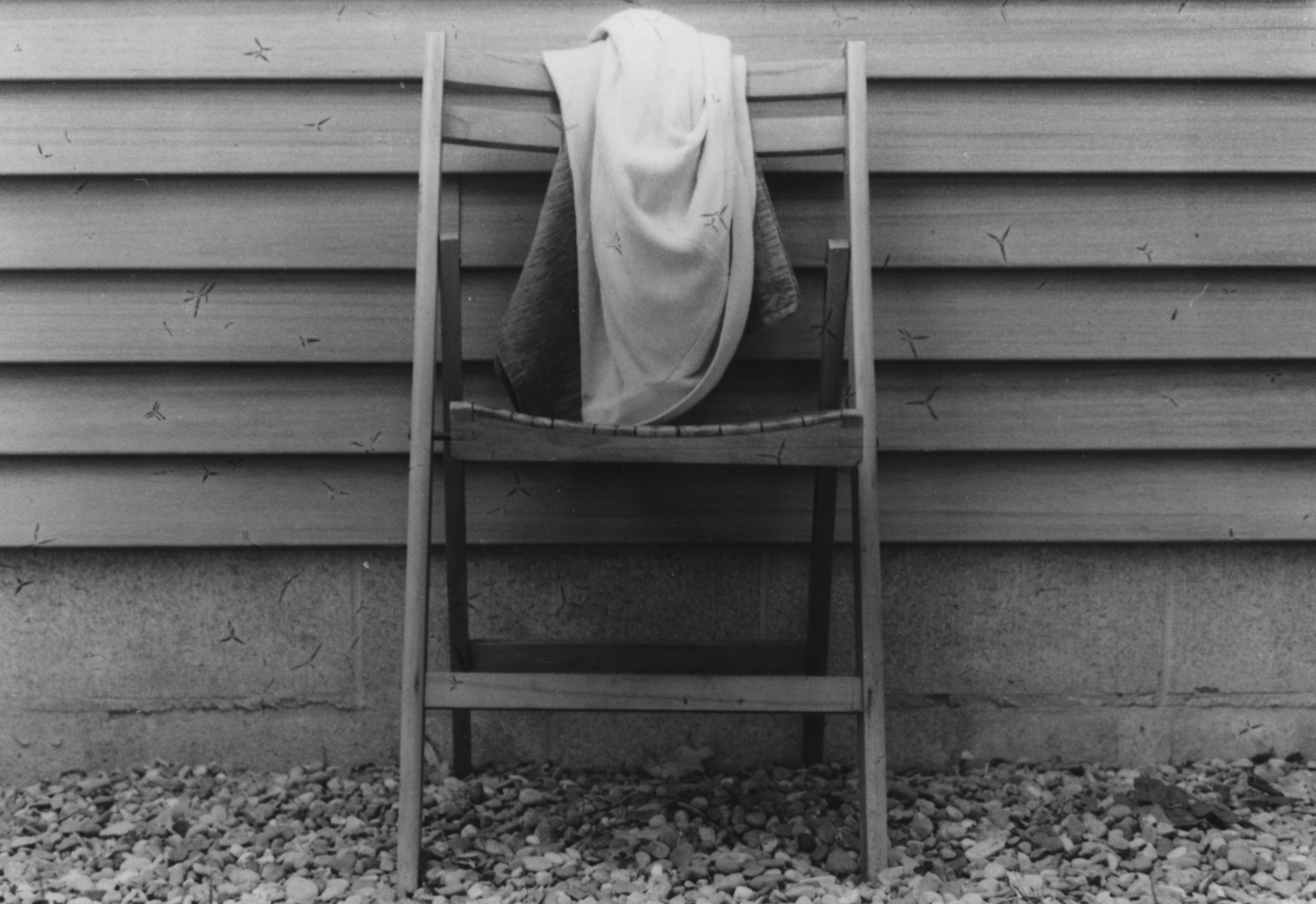

My photography classes are processing and I've experienced these Y marks on the negatives. What causes this? I have multiple students using the same chemicals, film, timing, etc. NOT everyone, but certain rolls are getting these crystally Y's on them. FRUSTRATING! Too cold of stop bath/water? It's room temperature. Static marks? HELP! Tri-x 400 and Arista EDU 400, Kodak D76, Kodak Fixer.
Surely it's a form of very localised reticulation? A temperature shock at some stage in the processing is the likely cause...? My guess is too much heat during drying. The Y marks were maybe the sites of droplets?

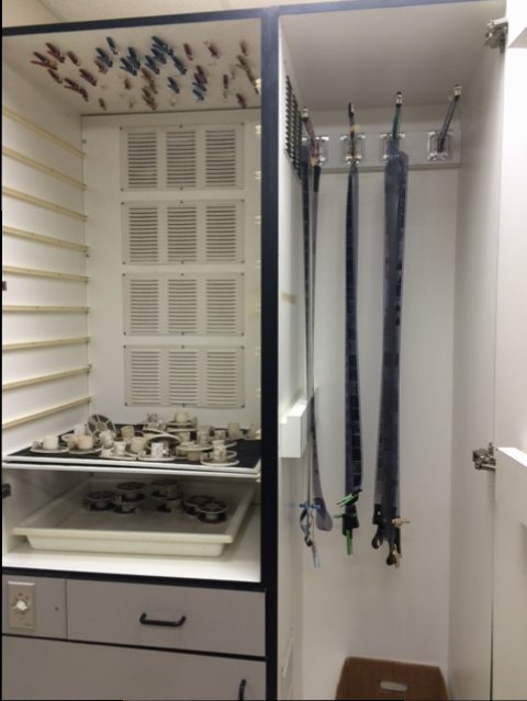

The film is dried in a tall cabinet. Film is clipped at top and weighted at the bottom - fan comes out of the unit on the left and through a small vent into the tall cabinet just to circulate the air. It does not have any heat at all. IMG_4333.JPG

Ys on image.jpg yet another one! :sad: I have had several students that this has happened to. We have filtered the D76 through coffee filters/colander to reduce sediment but no luck.
