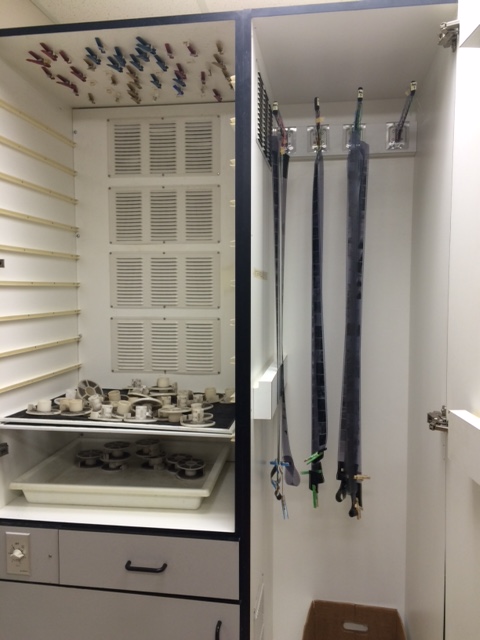

I went looking for the post and found the attached photograph of the cabinet.
To get film dry in only 45 minutes with no heat one assumes the fan is blowing strongly...
In the photograph there seems to be some contact being made by some of the films against part of the wall of the cabinet. What is the surface of the cabinet wall like? Completely smooth or with some texture?
Might it be that the few films that have made contact with the cabinet wall are the ones with the damage? Is sticky emulsion being momentarily tacked to the wall then blown free by the fan to leave tiny raised and split portions of emulsion?
If I was one of the students my film would never be hung on that left hand rail!
RR
RR
RR I manage to dry film in 45 mins or less in my cabinet without any heat but you may well have something in the points you make about the way of hanging and films' proximity to the left hand edge of the cabinet especially

I agree that after looking at that picture it makes sense to see if any physical harm is done to the film at any point of the process, particularly in the drying cabinet where the film touches the side wall brace.
It would also be good to see a picture of the damaged film, on the base side, if there is any physical damage to the film base due to kinking in the film reel loading process, etc.

The pattern of the "Y"s looks like a grate.

Getting film dry in 45 minutes is fast, I use a film squeegee and it still takes 5-6 hours.
If you want or need 45 minutes you need to use the techniques the newspapers used for stop press photos.
