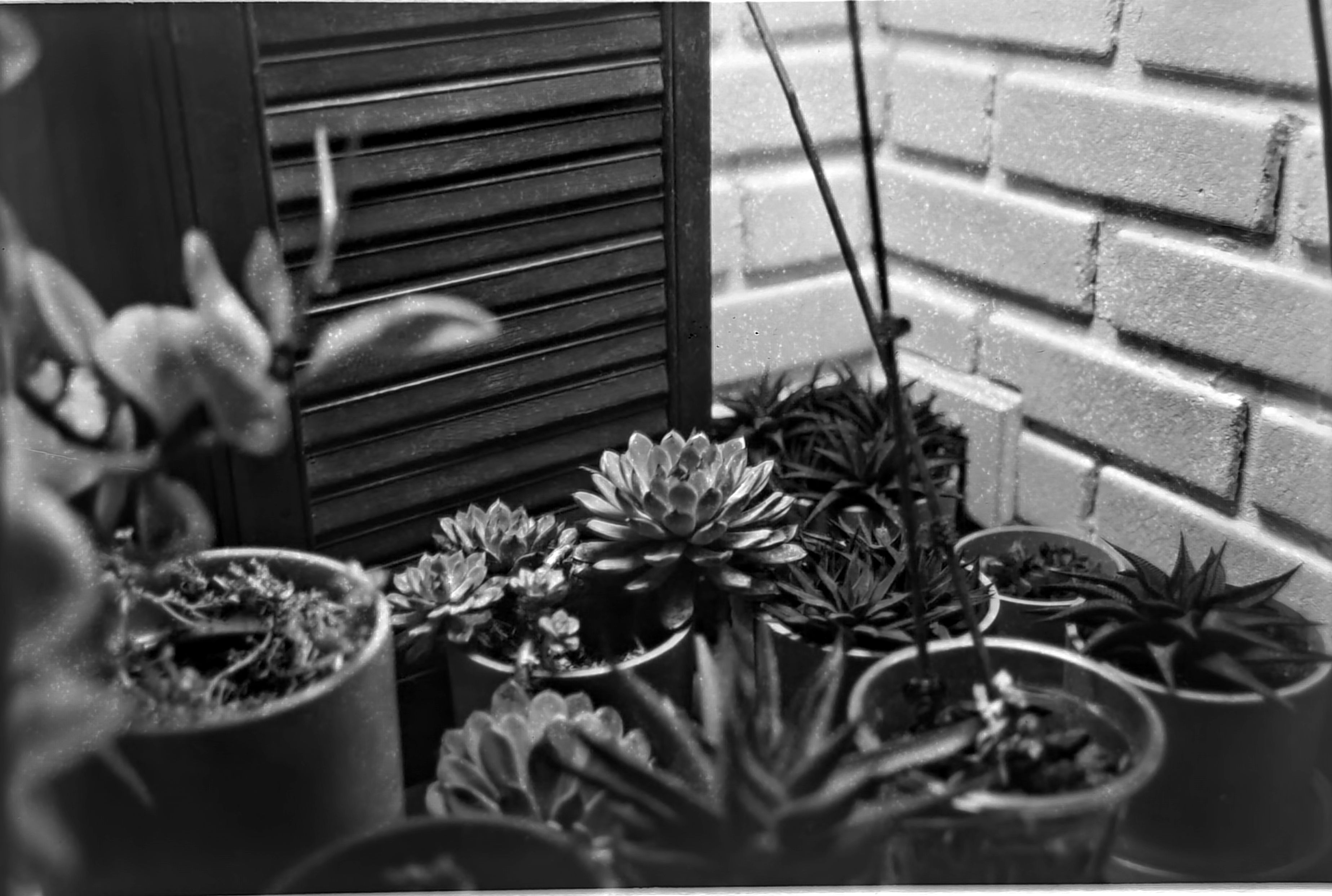

A roll of 2465 popped up in my eBay recommendations this week and I bought it so I'll try and contribute my experiences with it. Gonna try and cut up some 4x5 sheets tonight
Okay so rodinal does not agree with this film. brought out a lot of base fog even at 1:100.
I exposed a shot at ~iso 25 and developed in hc110 in dilution E for about 6 minutes (was developing in a tray by eye) and got pretty acceptable results. The emulsion does have some weird speckles throughout but there's minimal base fog with hc110. I'm guessing shooting at iso 12 and maybe developing with an even more dilute ratio will probably improve things.
As someone with an excessive amount of this film, that's a good looking shot there. I'm gonna have fun with this stuff.

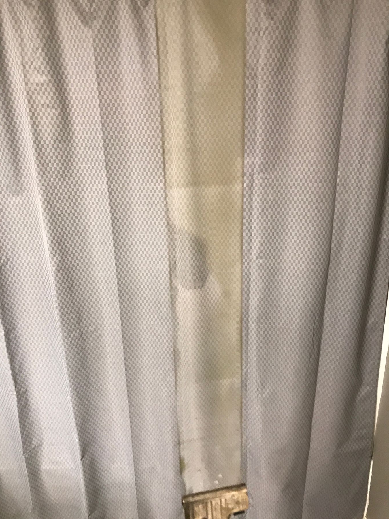

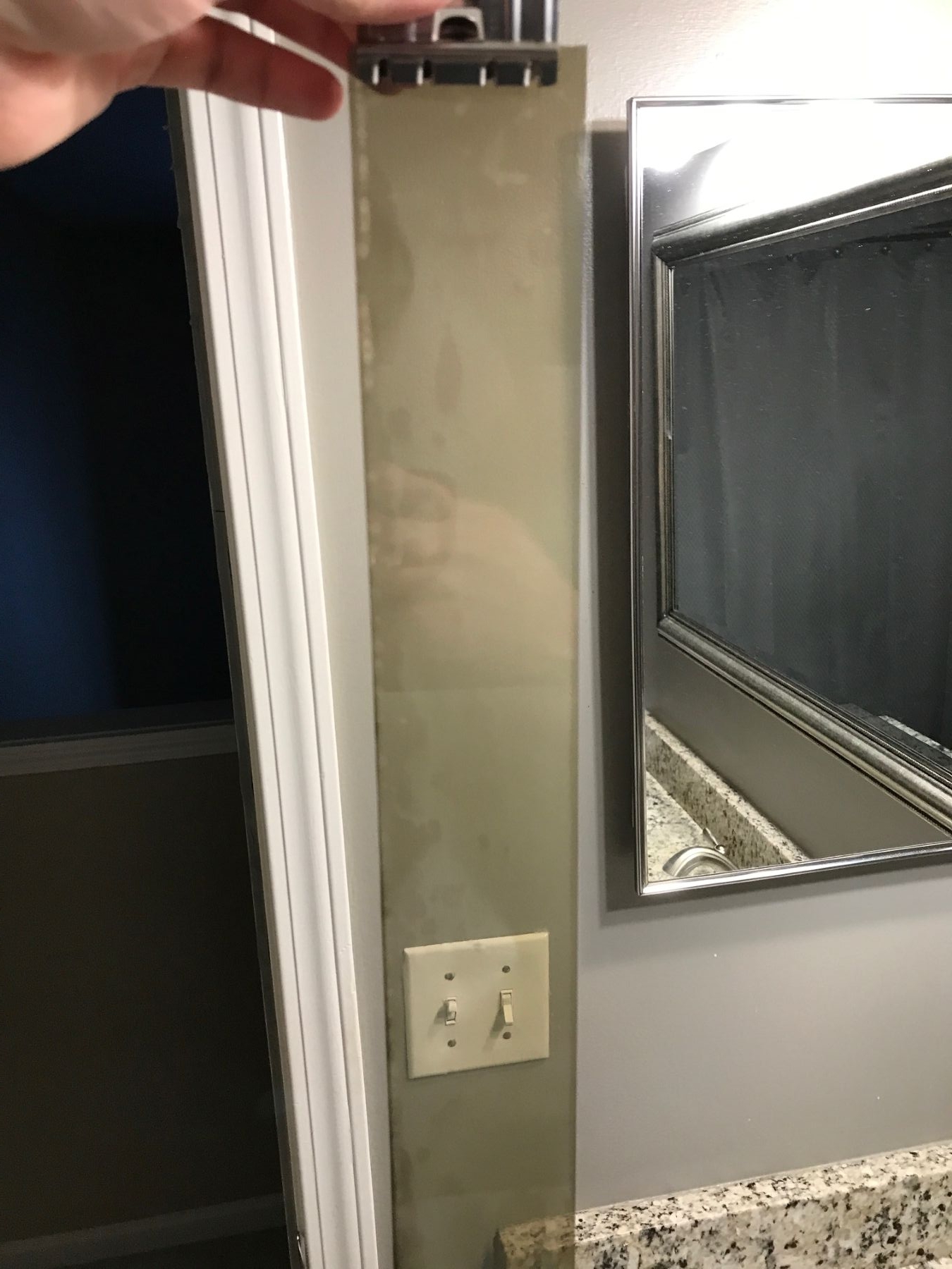

I tried developing a roll of this today with very poor results. I shot a roll of 120, 3 scenes each shot at EI of 6, 12, 25 and 50.

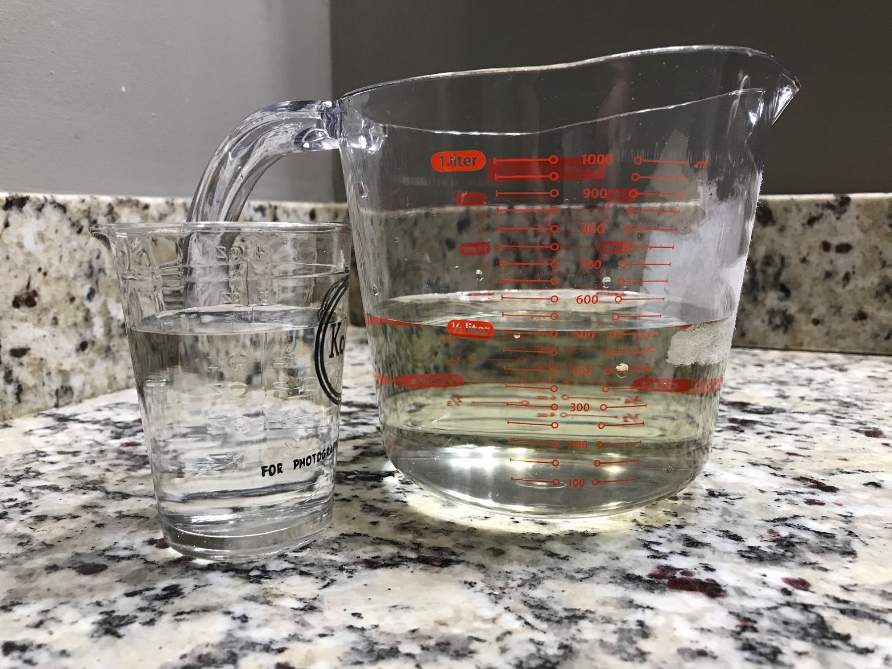

I developed this in TDLC-103, which is composed of:
1g Metol
5g Sodium Sulfite
10g Sodium Bicarbonate
Water to make 1000ml
I developed this roll for 10min at 68f, 30 sec initial agitation, 3 inversions every 2 minutes thereafter. (10 minutes is the recommended starting time for document, copy and microfilms)

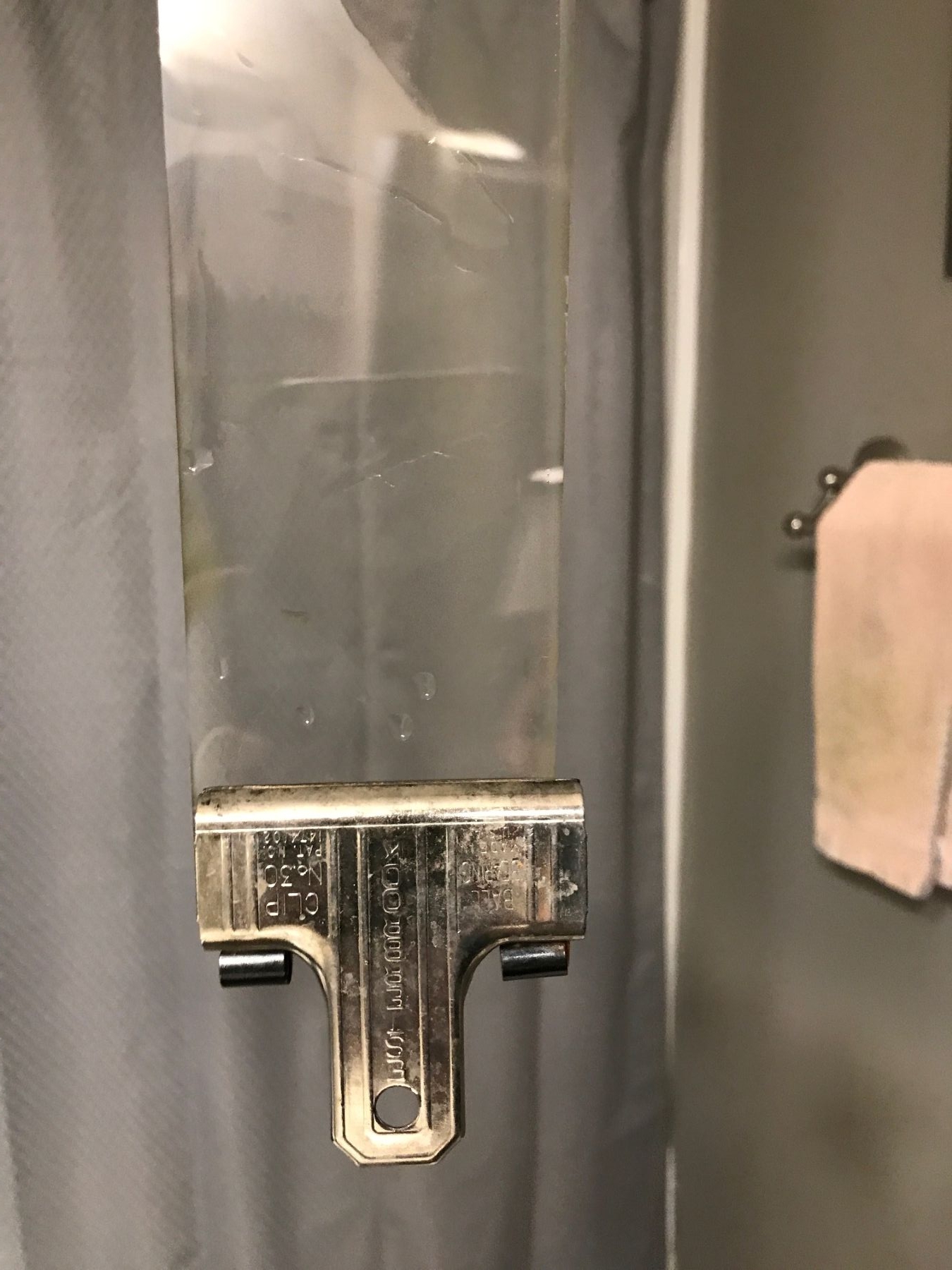

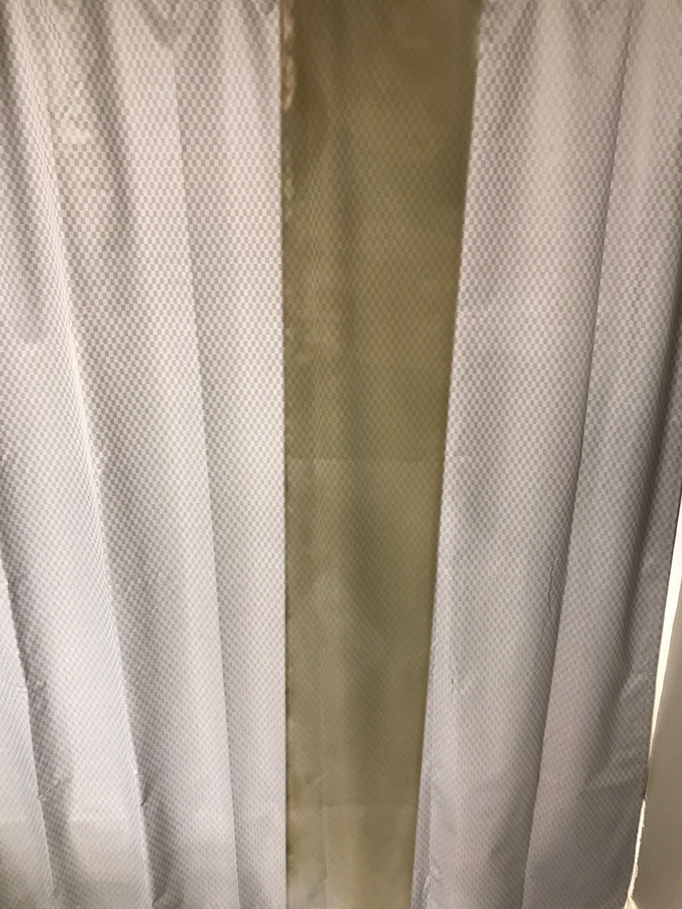

First off, it turned my fixer yellow, which hopefully is some kind of dye and not this fairly fresh batch of rapid fixer sulfuring out because of this film. Neither the developer or water stop were tinted yellow.
Basically no development occurred, and I've used this developer formula on Kodak Plus-X Aerographic 2402 before, so I know it should work to some extent in this time range for a normal film.
Film base still has a yellow tint and strange patches of fogging. Banding that occurs every 7 inches or so and starts with a sharp line of high density that then fades to low density before repeating. Also spherical areas of low density along one edge.
Only the first image that was exposed at EI 6 was visible on the negative, albeit very faintly. None of the other images exposed at the same EI or otherwise are visible.
Next time I'll try something like T-Max Dev or D-23.
