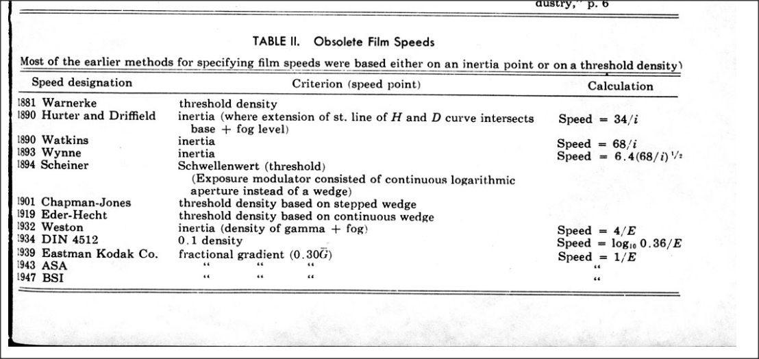

A list of obsolete Speed methods. So, if you used one of these, what would your "true film speed" be? The different methodologies between Zone System testing and the ISO standard accounts for most of the 1/2 to 1 stop reported discrepancies in film speed. FYI, only the fractional gradient speed related methods used a psychophysical approach.

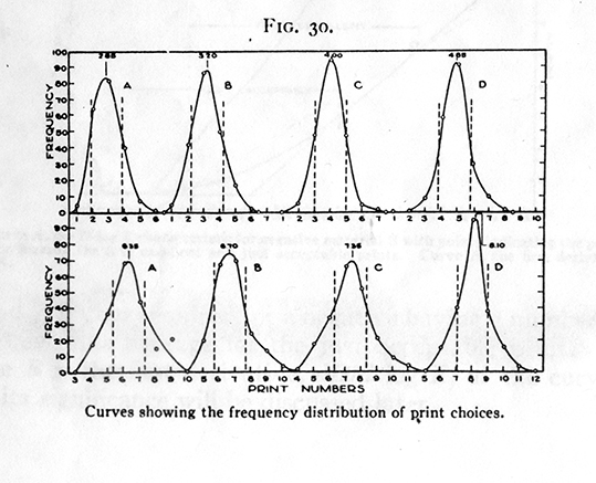

Do you know what the sample size is, approximately, in these studies. I understand the Power Test and confidence intervals but never saw the original studies to see the actual subject pool constituency. If that’s in the first two pages previously posted, please forgive me as o can’t read them on my phone. Must wait for a bigger display... thanks to presbyopia and cataracts not ready for fixing yet.
Jones used two groups of 100 judges. He notes, "there is very little difference between the average based upon thirty observers and that including the entire one hundred." It should also be noted that judging for the first excellent print wasn't the only criteria. The judges were asked to judge for "just acceptable."
If you're interested the tests are primarily in a series of three papers.
Jones, LA, The Evaluation of Negative Film Speed in Terms of Print Quality, Journal of the Franklin Institute, Vol 227, March 1939.
Jones, LA, The Evaluation of Negative Film Speeds in Terms of Print Quality (conclusion), Journal of the Franklin Institute, Vol 228, April 1939.
Jones, LA, Nelson, CN, A Study of Various Sensitometric Criteria of Negative Film Speeds, Journal of the Optical Society of America, Vol 30, March 1940.
