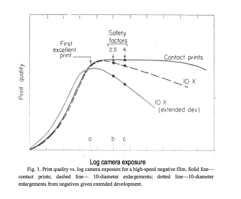

That was the reason that was officially given. Not to promulgate a conspiracy theory, but maybe the film lobby had the safety factor removed so as to give the impression that films of the era were faster than practically speaking. The pragmatists simply adopted a 'divide box speed by 2' practice, to get them back to the results they used to get before the 1960 standard adoption! And the rest is unrecorded history.
The reasoning came from a paper by C.N. Nelson in Photographic Science and Engineering in 1960 titled Safety Factors in Camera Exposures. I've attached the first two pages that covers the overview.
I was thinking that it's possible for people to decide to make an informed decision to keep the ratings they were familiar with, but they probably don't account for the whole. How about the ones that propagated the conspiracy theories. Now those can't be informed decisions. Something like that has to be associated with the Kruger Dunning effect.

So how did the '1/2 box speed' widespread belief arise, to get us back to OP question?

The First Excellent Print test is psychophysical.
My thinking would be that yes I could see it being that - but only because "the excellent print" was judged in a nominally christian society where "accurate representationarts" of the human figure was of importance for the culture.
In a society where that was not the case (eg islam or african arts where the human body was presented in abstracted term) then it is theoretically possible an entirely different point could be drawn
Secondly as photographers we can see a massively overexposed or underexposed negative made into a print and hail it as much (or even more) an excellent print as one defined by a collection of members of the public

Most psychophysics studies involve a series of “forced choice” decisions. Of these two, which do you feel is better. An example: optometrist visit where a series of “of these two lenses, which looks best” tests are used to refine the individual prescription. The answer is specific to the individual. studies to determine “population preference “ will involve a large number of subjects and statistical data processing. The results will be generally consistent (correct) but individual differences (opinions) will still exist. But overall the “answer” will be, more often than not, “correct”.
The print studies were not as haphazard as that in asking observers to choose something "excellent". If I remember correctly the observers were specifically asked to choose prints that most accurately reproduced the subject values. The purpose after all, was emulsion speed. If a print is filled with featureless black wherever light in the scene was low, while clearly such an aesthetic might be subjectively deemed excellent or not from an artistic perspective, one would expect less diversity of opinion if observers are asked to judge prints based on how "realistic" they look. Obviously it's not at all perfect.

Let me just add the findings from the First Excellent Test and others are the basis of Tone Reproduction Theory.
