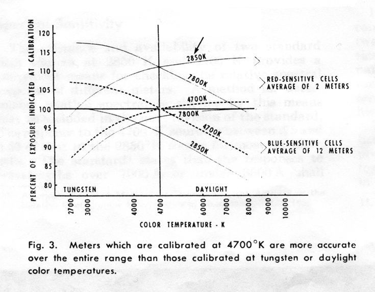

Here is a graph of the response of difference meter types calibrated to difference color temperatures over a range of color temperatures.

In a paper by Allen Stimson, An Interpretation of Current Exposure Meter Technology, Photographic Science and Engineering, Vol. 6, No 1, Jan-Feb 1962, he writes about the exposure meter graph uploaded a few posts back and it also relates to the two EIs, Daylight and Tungsten.
Calibration at 4700 K
With changes in color temperature, the sensitivity of selenium cells of American manufacture changes in the same direction, although somewhat less in magnitude, as panchromatic negative materials. Hence meter makers have urged film manufacturers to eliminate tungsten film rating for several years. K.S. Weaver of the Kodak Research Laboratories made extensive tests on a dozen of each of fourteen makes of meters to determine the feasibility of this elimination. His tests showed that two of the fourteen changed sensitivity with color temperature in the opposite direction from the majority. This confirmed other observations that some meters, which manifested perfect calibration in the laboratory (at 2700 K), differed markedly when used in daylight. A. L. Sorem showed that the errors could be equally divided between daylight and tungsten if all meters were calibrated at 4700 K rather than 2700 K. This calibration is now included in the standard. It will assure closer agreement between meters in daylight and eliminate the need for tungsten film speed for most panchromatic negative materials.
