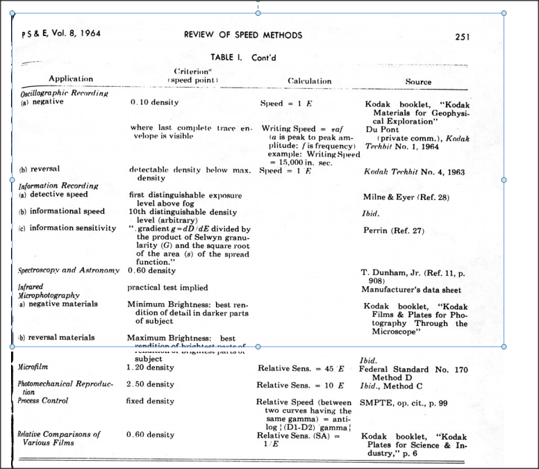

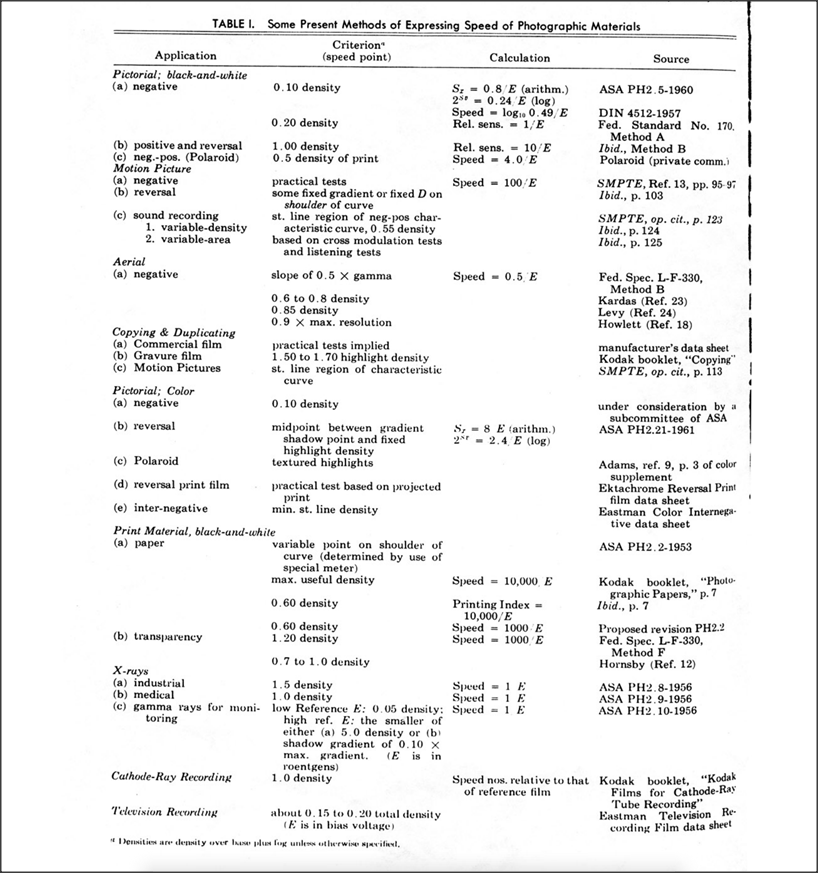

Some fun facts that might help to put film speed ratings into perspective. We are all familiar with the three main ones for general purpose photography. But there are different needs for different uses. Here are some other speed rating systems:
