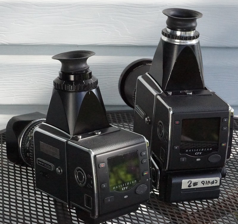

CFV16I and CFV16II by Nokton48, on Flickr
I've had this Hasselblad CFV16 Version 1, for a while and I'm really enjoying using it. From KEH along came a CFV16 Version II, very similar but with some upgrades. Since I have an Anniversary 500C/M with my CFV16 working good, tethered to Phocus too, I also figured it's a good idea to have a backup unit, these do not come up often IMO. Serial Number is 3DSR2120. Menu says Firmware Revision: 270. Files have a slight Magenta cast to them but camera is staring to wake up. Has a lot of small marks so it's been used, sensor is pristine. Anything I should do to bring this out of Coma? It's on my motorized EL/M, I got all the CFV16 accessories when I got the first back. I have a second CFV16 Acute Screen, so that saves me at least $600.I've had this Hasselblad CFV16 Version 1, for a while and I'm really enjoying using it. From KEH along came a CFV16 Version II, very similar but with some upgrades. Since I have an Anniversary 500C/M with my CFV16 working good, tethered to Phocus too, I also figured it's a good idea to have a backup unit, these do not come up often IMO. Serial Number is 3DSR2120. Menu says Firmware Revision: 270. Files have a slight Magenta cast to them but camera is staring to wake up. Has a lot of small marks so it's been used, sensor is pristine. Anything I should do to bring this out of Coma? It's on my motorized EL/M, I got all the CFV16 accessories when I got the first back. I have a second CFV16 Acute Screen, so that saves me at least $600.
