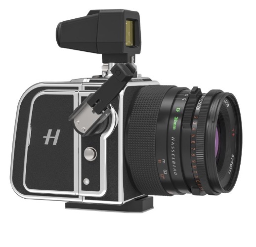

That's the one thing I want to keep, my wide angle lens to remain wide or semi-wide. I have a SWC, but don't know how compatible the 38mm Biogon is with digi backs.
Hasselblad shows an SWC with their current digital back. It just won't be as wide.
Yes, I've seen that picture, but that back is out of this world for me cost wise. I need to know how it goes with some of the older digital backs. I guess I'll have to do a search later this evening when I have more free time.
