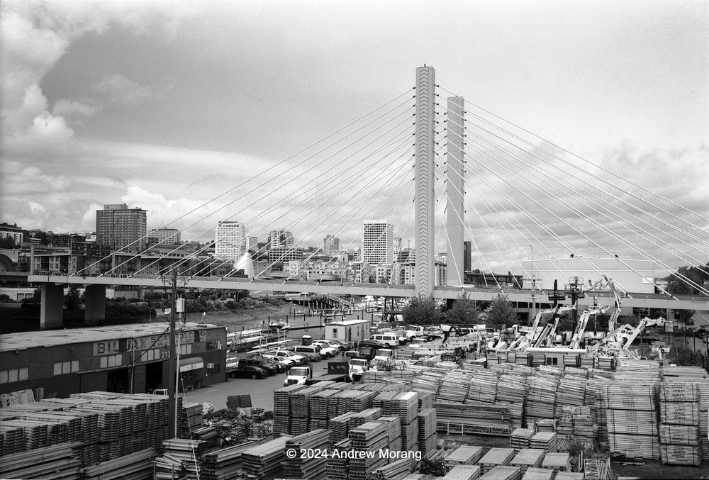

A complicated scene: the 21st Street Bridge, Tacoma, Washington, USA. Kodak Panatomic-X film, Fuji GW690II camera, 90mm ƒ/3.5 Fuji lens, deep yellow filter, tripod-mounted. Scanned on a Minolta Scan Multi film scanner as a 16-bit TIFF file. Praus Productions in Rochester, NY, developed the film.

Thank you. An elevated overpass gives you a good view of the complicated industrial scene at the Foss Waterway in Tacoma., Washington. To the east is a huge BNSF railroad yard. I took a number of pictures here with Panatomic-X and my Fuji GW690II camera.

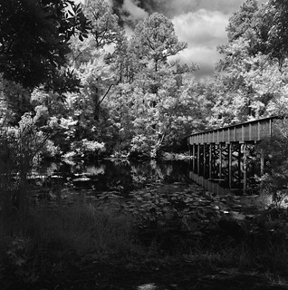

Bronica EC-TL, Bronica 50mm f/3.5 Nikkor-H, Catlabs X Film 320 Pro, shot at ISO 200, used a Zomei 82mm IR 720nm filter, developed at home using B's Processor, Photographers Formulary TD-16, 1:1, 5:45m at 20° C, JOBO 1520 tank, 3 min pre-wash, used quality volume (500ml for JOBO 1520), decreased development time by 5% per the B's guide.

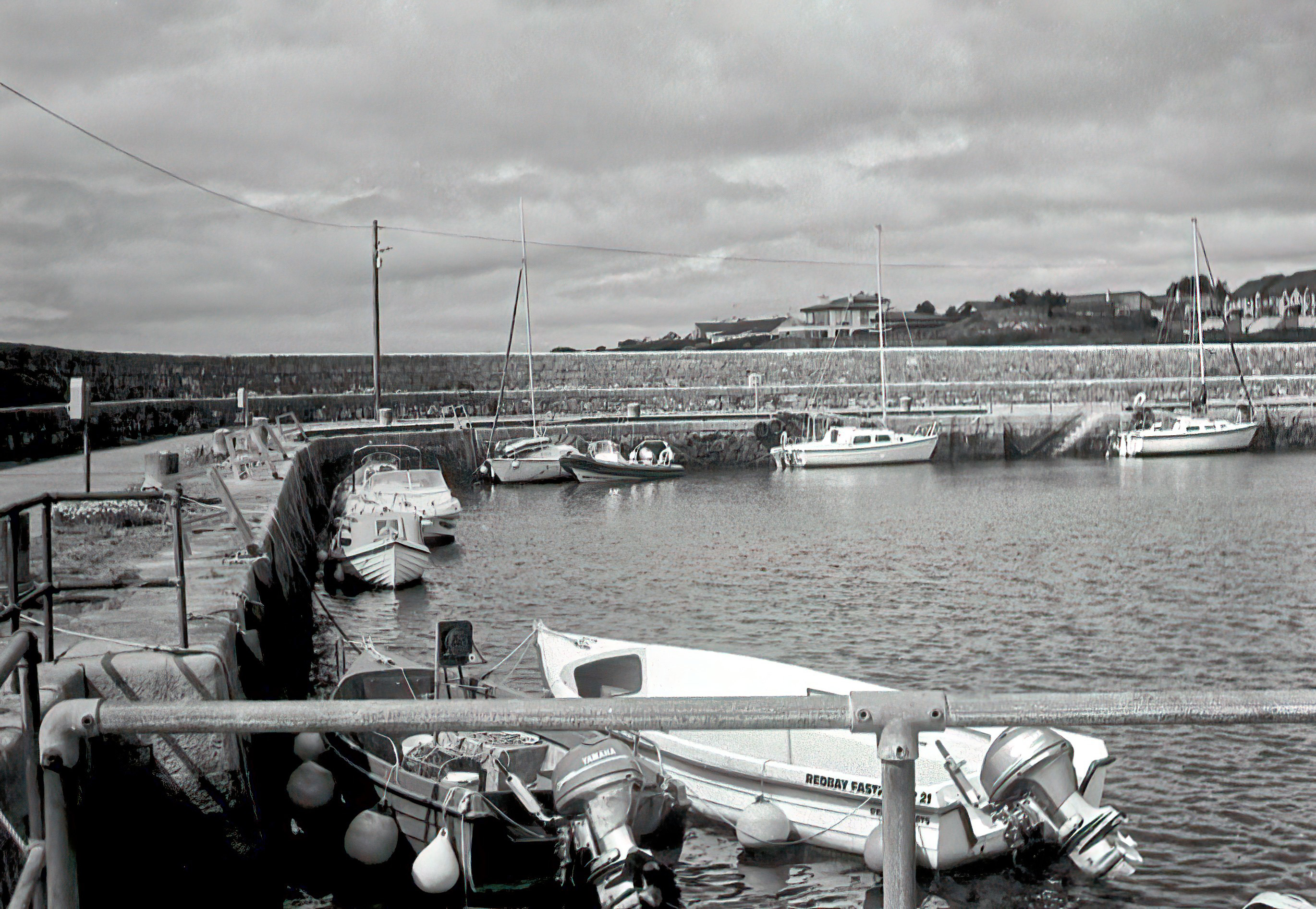

Mamiya 645, Kentmere 100, Clayton f76+, way over developed due to not checking my water temps (79 vs 68). I will be using hc-110 next time and will temperature compensate.
Some photos were salvageable, some not so much.

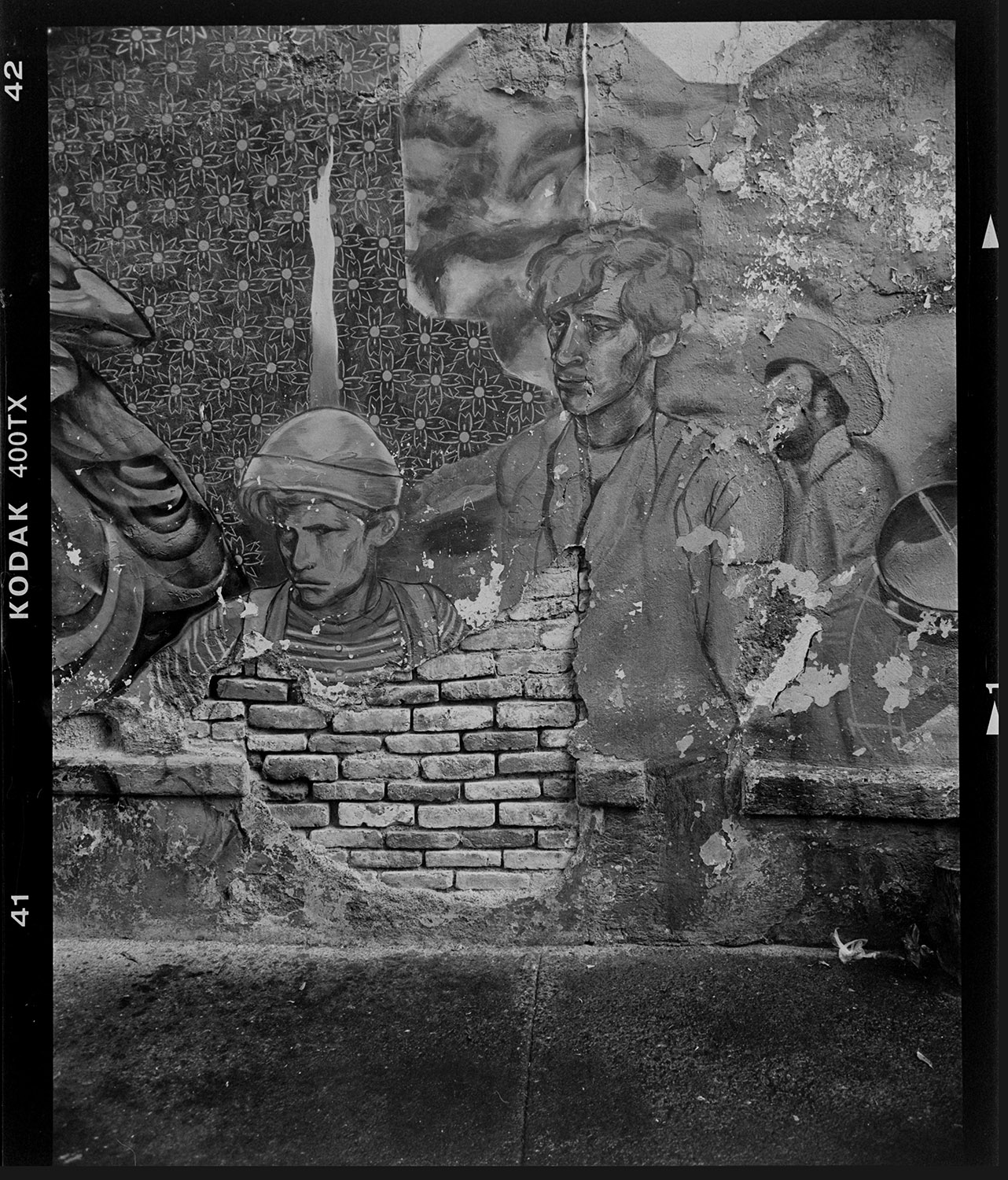

4x5 Cambo SF, 210mm Sironar, with Norman flash. TriX pan and Berger 400 developed in FX25. Will try to print today. Will try to finish copy stand this week so I can post.
I made the prints yesterday and am pleased with the results. The chinese 10 turn pots on my LED head Died and I'm back to a plain potentiometer with a % index which worked fine. I started about grade 3 and shifted to about 2.3 for the final print.

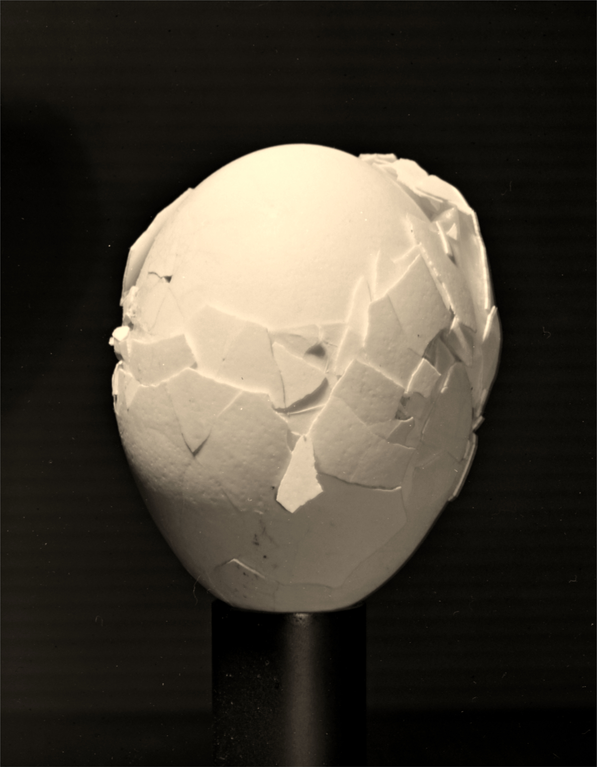

I made a scan of the film today with my new copy stand. For the First Time on Film, The Birth of an Egg!
I managed to place all the tones correctly and that was a big part of this project.

Bronica EC-TL, Bronica 50mm f/3.5 Nikkor-H, Catlabs X Film 320 Pro, shot at ISO 200, using a Zomei 82mm IR 720nm filter, developed at home using B's Processor, Photographers Formulary TD-16, 1:1, 5:45m at 20° C, JOBO 1520 tank, 3 min pre-wash, used quality volume (500ml for JOBO 1520), decreased development time by -5% per the B's guide.

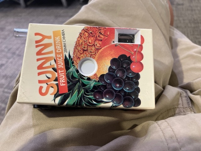

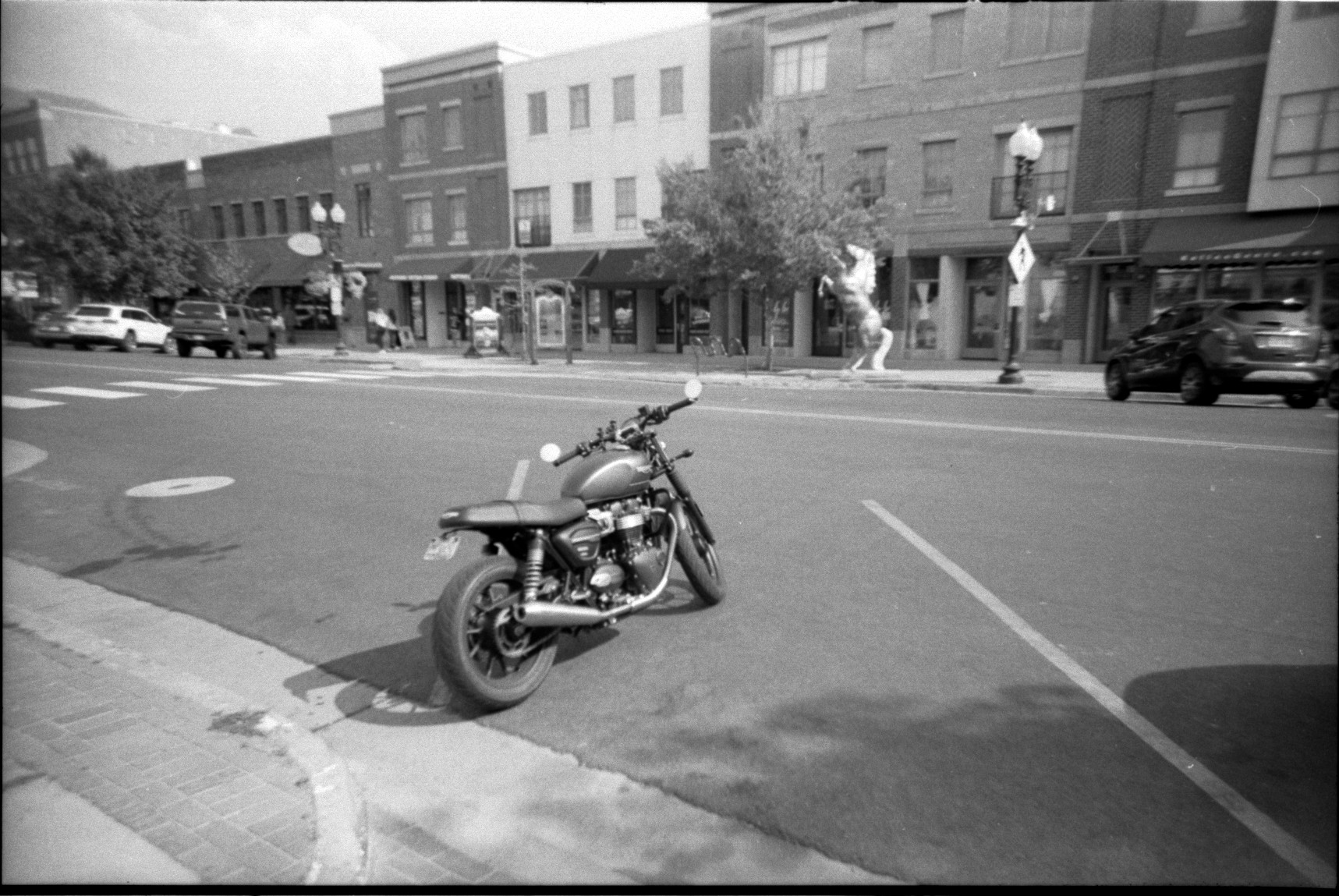

Juice box box camera -- simple plastic lens, ilford HP5. Actually does a decent job as long as edge sharpness isn't high on your priority list.

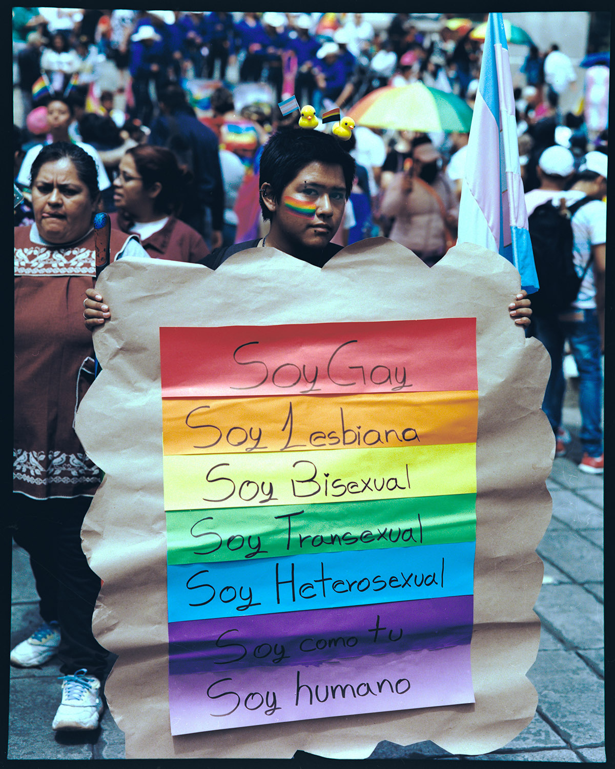

Kowa Six, 85mm f2.8, Kodak Portra 160.

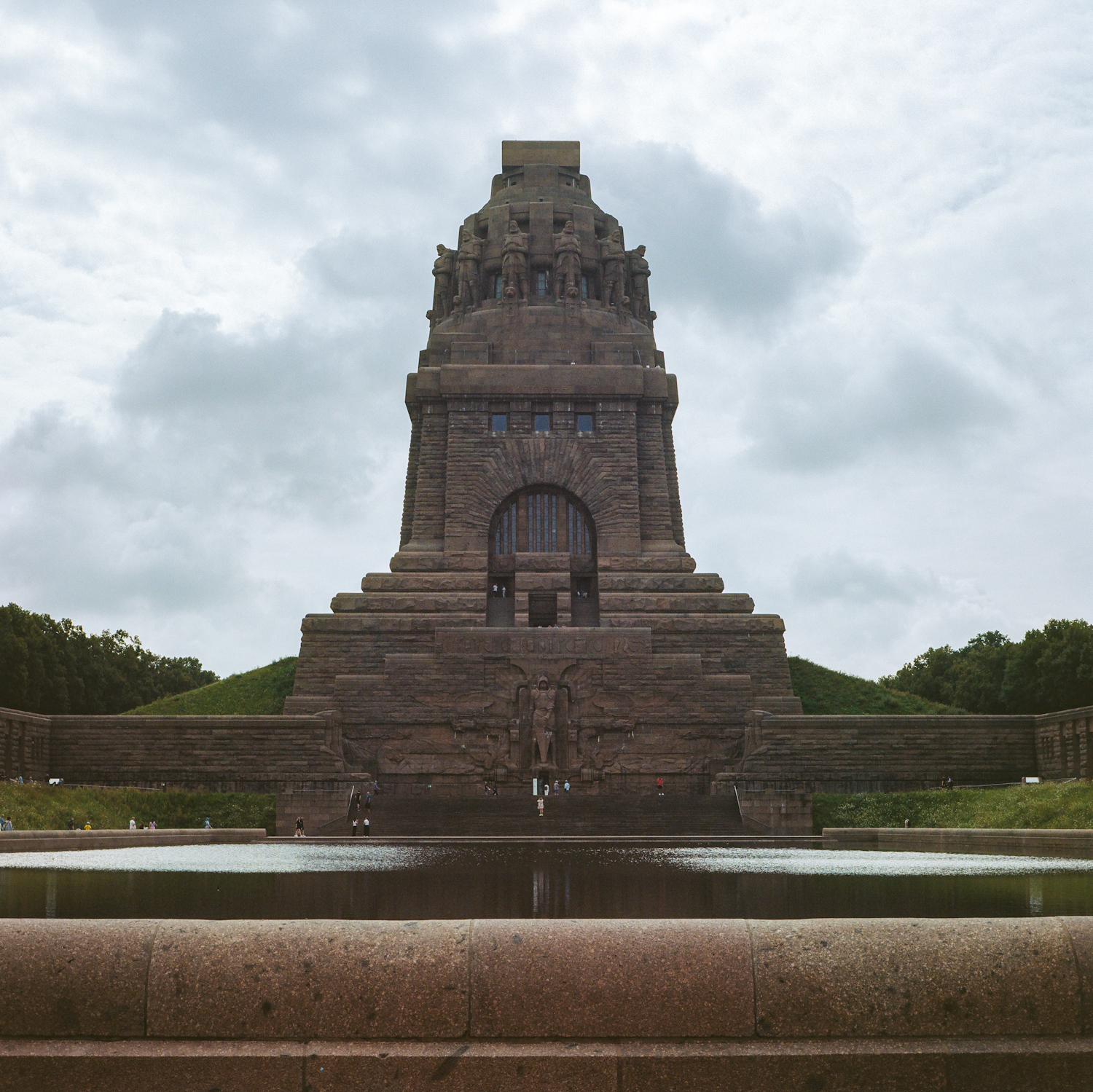

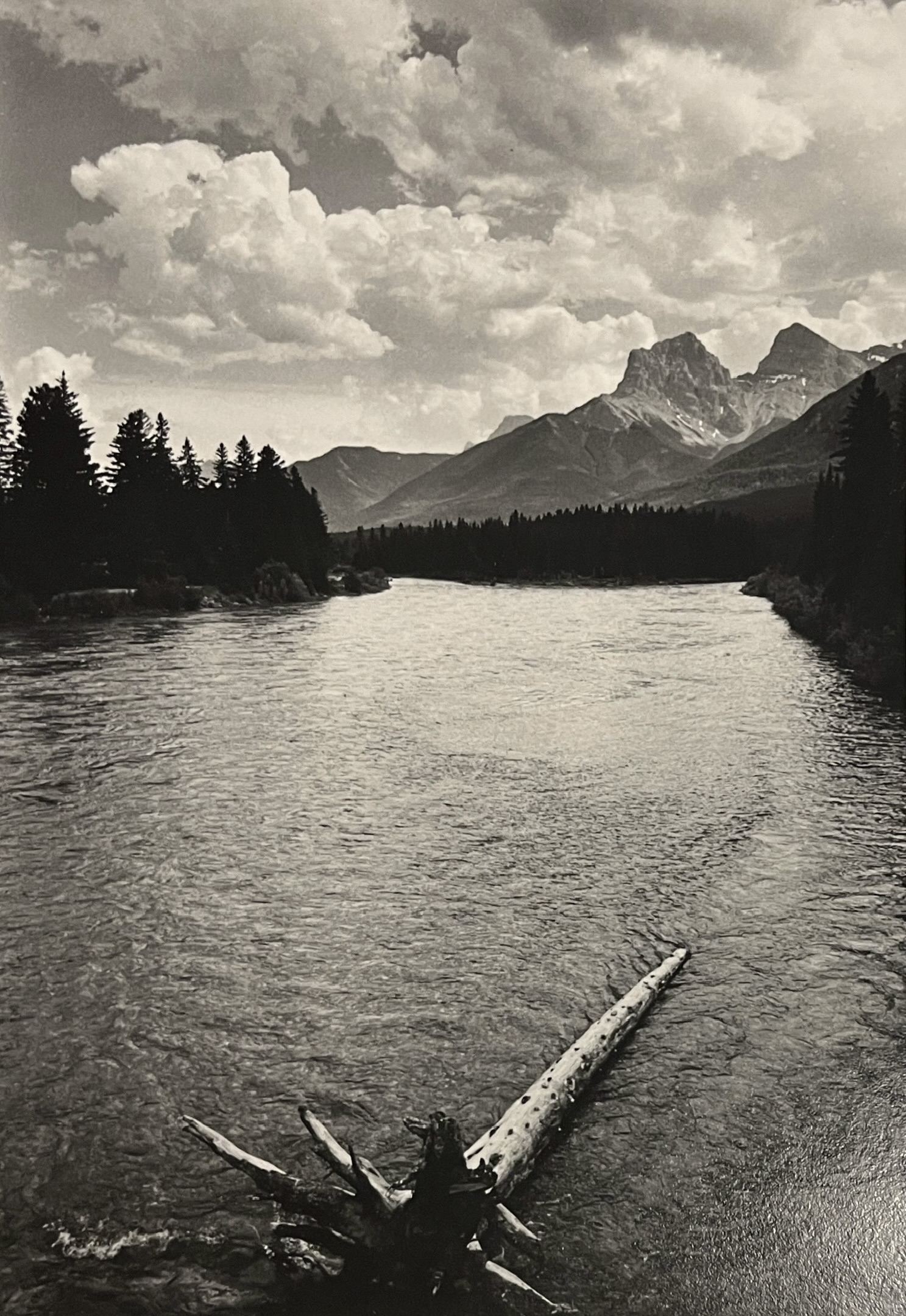

Leica CL / Canon 28mm 2.8 LTM/ Kentmere 100/Pyrocat HD/1+1+100. 8.5 min 20°C/ print on Ultrafine Silver Eagle
Checking shutter speeds & tweaking exposure/development time...before an upcoming euro trip.
