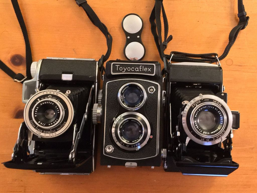

A trio of cameras actually - but the films were all developed in the same session, using replenished XTol.
Here are the cameras - A Kodak Tourist with TMax 100 respooled to 620, a Toyocaflex with TMax 400 and a Zeiss Ikon Ikonta 521/2, also with TMax 400.
