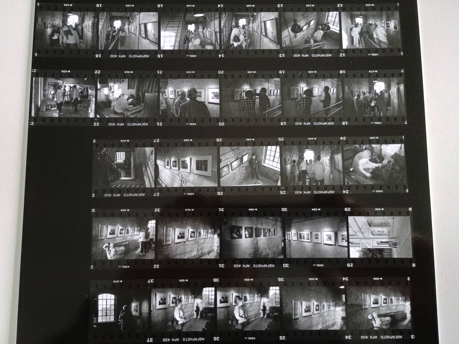

Rollei 35 T with Kentmere 400@800. Adox XT-3, 1+1, 16 Min. Images of a Vernissage in Solingen/Germany. Surprisingly good and sharp. Sorry, I can show the contact sheet only.

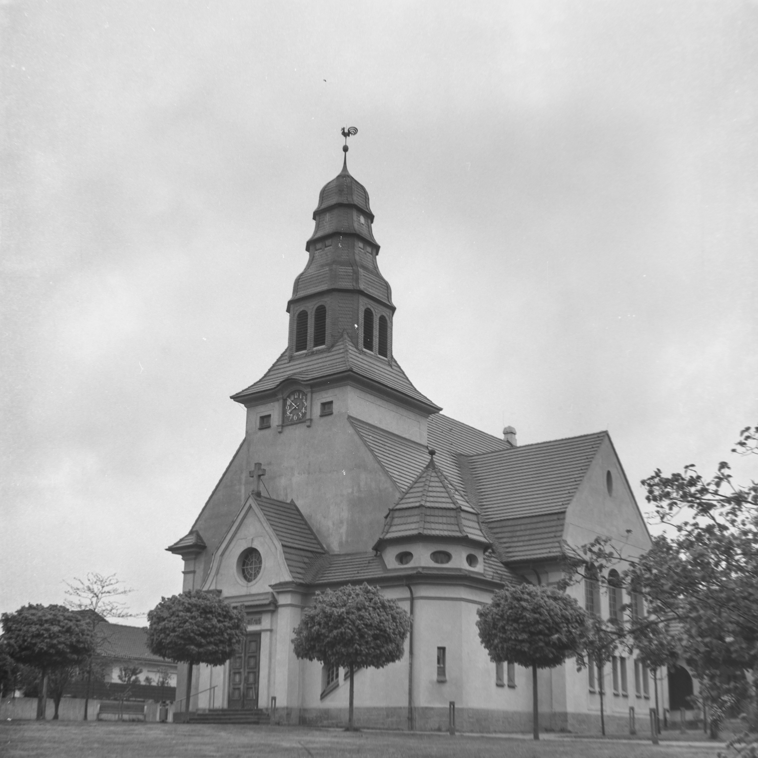

Packed my Tachihara 4x5, Fujinon 70mm f/5.6 and Aviphot 200 film @200 to do some architecture shoots on local churches. Just developed this morning with E-76. Negative turned out very good. Will scan tomorrow and if it look good enough, probably some 11x14 on my darkroom.

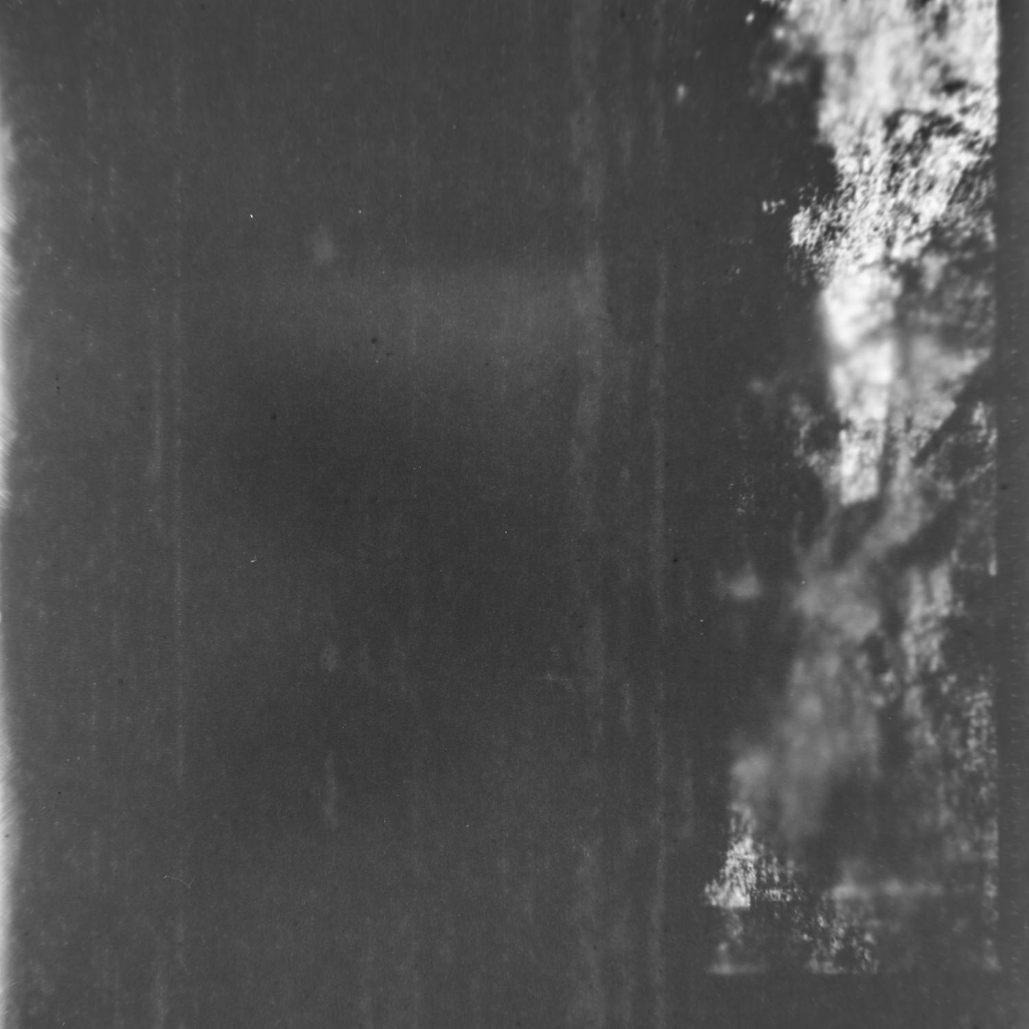

Yashica Mat 124G, Ilford FP4 120ASA, expired in 1980 (bought at a flea market). Exposed at 30ASA and developed by a lab.
Aaaaaaand.....
Nothing.
Probably stored incorrectly for many years, the emulsion had dried on one half of the film.🧐

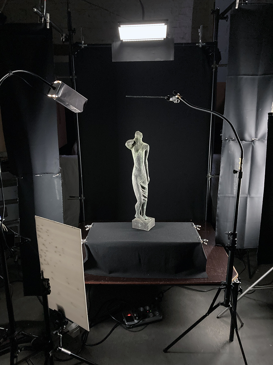

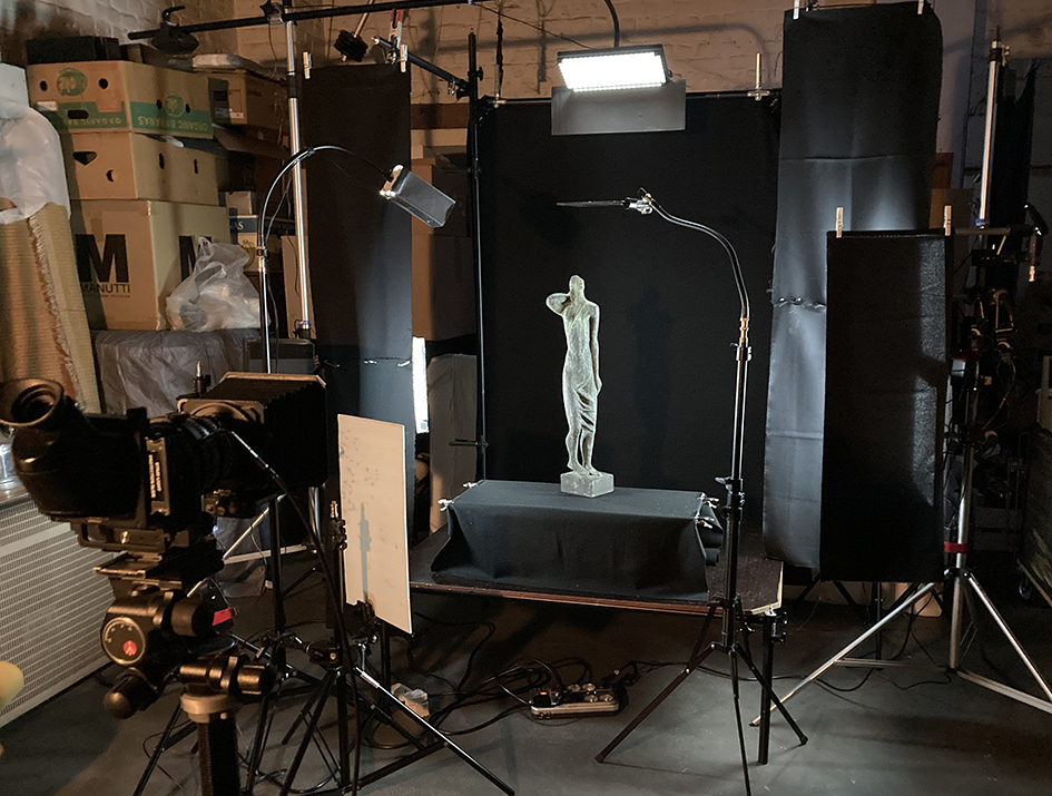

Right now in the studio, for a sculptor's portfolio: Hasselblad Flexbody + S-Planar 120mm on Fp4+ @ 64ASA, with ROSCO LitePad Gaffer's Kit LED lights.
Will be developed in ADOX XT-3.
