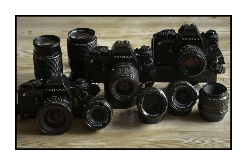

Ha, the Pentax LX, this was the best 35mm camera I ever owned, a real trustworthy workhorse, easy to handle, the best light metering system and affordable too.
I was so stupid to sell the largest part of the bunch :sad:
Hi Philippe-Georges, My parents gave me a Pentax ME for the Christmas of 1976. I was 16 and thrilled to have a real camera. From then on I was hooked on the Pentax line of cameras. I've had the LX since July 1984 and shortly added the MX too. I'm glad I kept them during my digital adventures.
