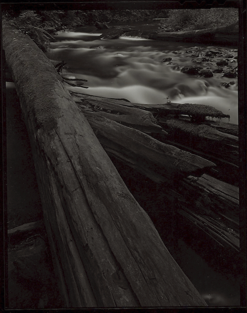

Gowland 4x5 PocketView, Calumet edition, 150mm lens (Caltar IIN 150/5.6).
Kodak Professional Copy Film, ASA 25, developed in PyrocatHD (2:2:100, 74F, 14 minutes, 3006 Expert Drum)
Example below:
Bridge Creek, Redwood National Park, 2022
f/64 @ 5 minutes
Carbon print
