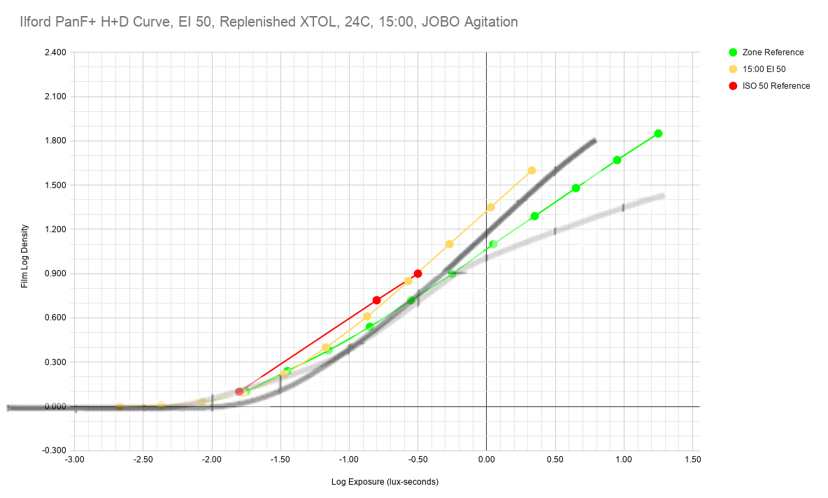

I’m using a 100mm transmission rated lens mounted to a 35mm camera and just filling the frame with an 18% grey card that is roughly the size of an 8x10 print. I’ve checked the grey card and it does reflect close enough to 18% that I’m well within my margin of error for being able to measure it. The lens has been measured and has the physical iris control on the barrel of the lens along with marks for each transmission step in full stop increments. I set the lens to infinity focus. The light measurements are taken with a sekonic incident meter at the plane of the grey card that I’ve also checked for accuracy and it is indeed accurate and measures in 1/10 stop increments. For faster films I have plenty of light to very evenly illuminate the grey card, its just the slower speed films that I have trouble getting the upper zones of light.
I’m not necessarily looking to reproduce ISO or manufacturing tolerances, but, with my current setup, am pretty confident that I’m easily within 1/10 of an fstop in terms of amount of light actually hitting the film in the camera, which for uses of determining development times and graphing an H+D curve is probably overkill, but I’d rather make it as accurate as I can within reason with what I have access to than just say my tolerance is +- a third of a stop. For somebody who’s just trying to work out a personal EI for stuff they shoot and develop themselves, a third of a stop is good enough to get them in the ballpark. Since I run film for other people, I want to know with a fairly high level of confidence that a given emulsion really needs x amount of time if shot at EI whatever.
Because I got bored, I quickly scaled both of Ilford's curves to match the plot Adrian has published and then shifted (very quickly and very roughly - I am not desperately inclined to spend hours cleaning off all of the artefacts of Ilford's graphs) the graph to line up with the b+f line. Pale grey is ID-11, darker is HC.
Discuss as you wish. The ID-11 curve checks out to G-Bar 0.62 pretty accurately I recall. Remember that in dealing with Ilford films, average gradient is what they design to, so these specific curve behaviours are likely there with good reason. Generally, if you get a result that significantly disagrees with the manufacturing data, you're more likely than the manufacturer to be making an error in your system of measurement or what you think the 'correct' density of a particular step should be.
well, there you go.... the darker HC one looks to have the same shape as I’ve published. I’ll bet if you stuck them on top of each other there’d be shockingly close if not dead on.

Give or take the approx stop of speed loss, yes.There's still the question over why ID-11 produces such a significantly different curve above 1.0 density, but it may simply be down to specific developer exhaustion.

also, looking a little closer, should the horizontal line on Ilford’s chart be at 1.0 instead of 0.9?
Ilford’s is relative log exposure. It doesn’t indicate what they actually exposed it at. I exposed mine at EI 50 and processed it to as close to G-bar 0.62 as I could reasonably get it.
The time they state for the curve from HC is the same as they state for an EI of 50, but the speed rating test is carried out in ID-11. On that basis, how they match up to your results, and that HC-110 type developers are cited by Kodak as delivering a slower shadow speed than D-76, and that there's perhaps 1/3 stop difference between D-76 and Xtol in shadow speed, I'd suggest a stop slower shadow speed in HC compared to Xtol is probably a reasonable starting point for testing.

I think they go from absolute 0.0 rather than b+f. I shifted their curve up so that both your & their b+f's lined up - which was about 0.1 I think.

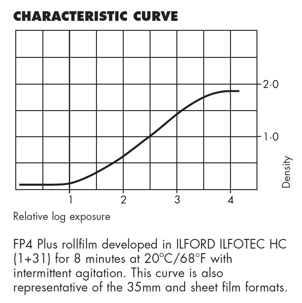

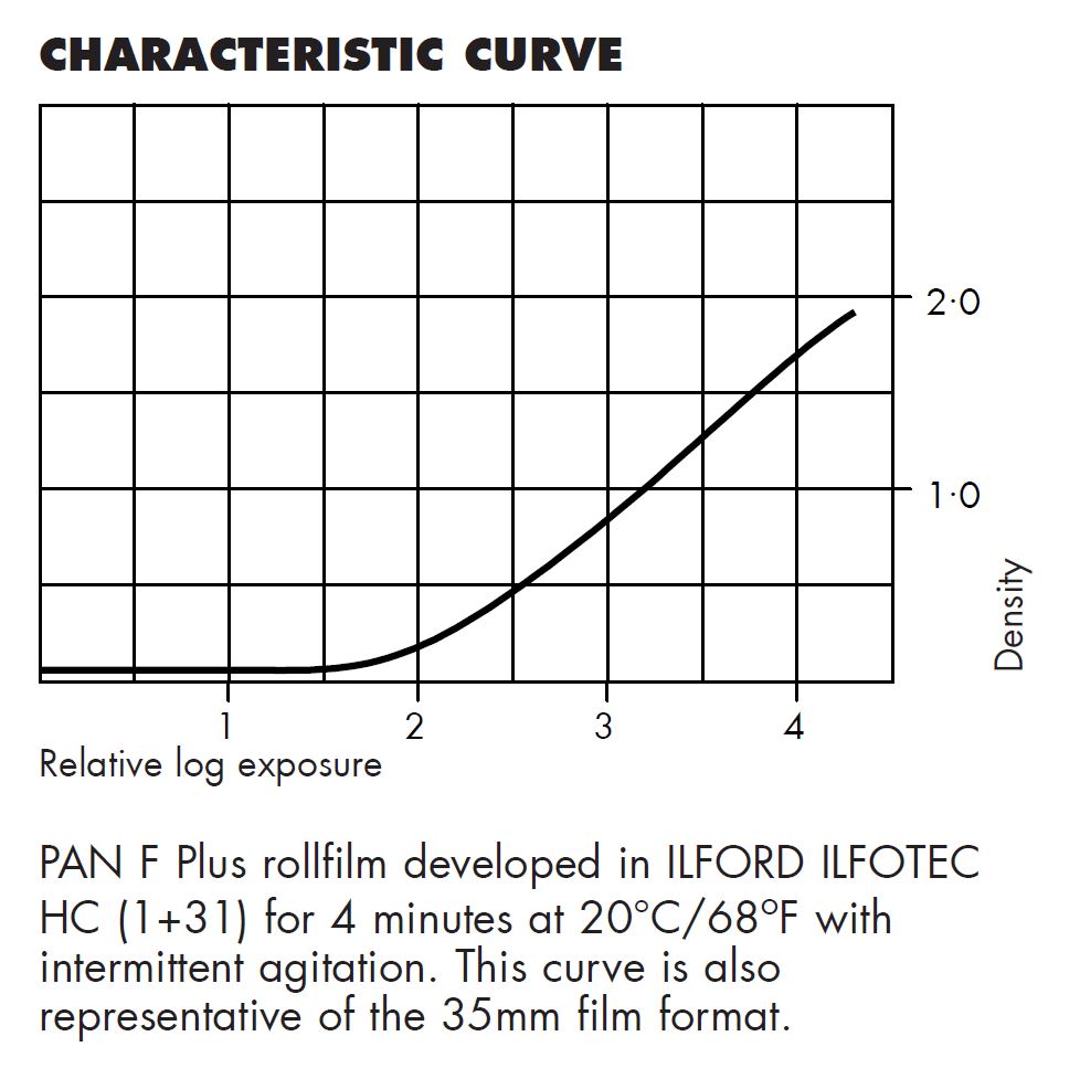

In retrospect, I should have mentioned the publications I was referring to, and they are Ilford's data sheets for Pan-F Plus from June 2010 and FP4 Plus from April 2004. The respective graphs (attached here) use the same domain, range, and units, and the same developer. I think a reasonable interpretation for Ilford's comparison is that the FP4 curve is more S-shaped than Pan-F's, and Pan-F has a longer toe than FP4, as I mentioned in my previous post.
Well I can certainly see an S shape in FP4+ whereas there appears to be no such shoulder on Pan F. I think Drew is saying that either Ilford has accidentally swopped the curves or is saying that Ilford's plotting is just too crude to show the Pan F shoulder?
At least we now have two Ilford curves that use the same developer and seem to cover the same range.
Perhaps Drew can indulge me just once more and just clarify what mistake Ilford has made

Both Adrian's and Ilford's data is plotted on log scales, they just needed scaled to match. What is clear is that with the multi-emulsion construction of modern films, it's possible for a developer to run out of steam on different emulsions at different rates, producing curve behaviours which may or may not be useful - as opposed to the ancient N-/N+ orthodoxies founded in the era of single emulsion k-grain films.
Average Gradient is arguably the least bad of the three methods of measurement (as opposed to CI and Gamma) in terms of accounting for the overall impact of the non straight bits of the curve, however I'd suggest that it's not just shadow/ highlight curve behaviour that's important to understand, but the fundamental impact that significantly raising or lowering the midtone gradient through attempts to soften or harden highlights and shadows will have on printability and overall tone. All too often I see boasts of extreme N- development on something like HP5+, usually followed up by whining that the subsequent negative is hard to print (often compounded by a stop or more of underexposure)...
The whole point I was making is that Pan F BEHAVES like an S-curve film, while FP4 behaves as having a moderate toe followed by a long straight section. These respective characteristics can be tweaked somewhat, but not really be fundamentally switched. ...HP5 has a substantially longer toe than FP4, but not an S-curve. It eventually shoulders off. I used it quite a bit in 8x10 format, but didn't like it any smaller format. PMK dev gave it esp high edge acutance, yet delicate non-gritty "watercolor grain". It did a fine job in "normal"but not extreme contrast scenes (too much toe for that). I'd deliberately over-develop it to expand midtone and upper microtanality, and then add an unsharp contrast mask to tame the overall contrast. That way the full crisp tonal range would come out in a hard grade print, whereas a traditional Zone System minus dev or compensating approach, or lower grade paper, would have forfeited that special quality.
