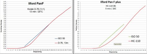

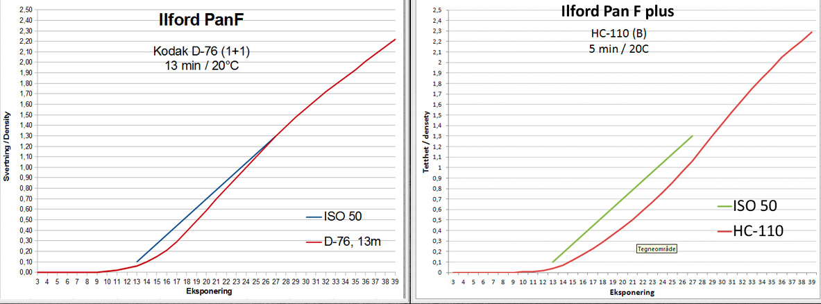

pentaxuser - No, Pan F is one of the least flexible films out there in terms of curve restructuring.
I think what Adrian was showing by presenting those two different curves side by side was the blatant discrepancy between the version in the latest tech sheet and all previous official tech sheets, which convinces me that somebody at Ilford recently selected the wrong one for use in that publication. But you could ask him.
Drew I think it was Lachlan and not Adrian who presented the two different curves. Adrian Bacon showed his replenished Xtol graph. In his there seemed to be no sign of an S shaped curve and in Ilfotech HC the graph was substantially different and pretty straight by comparison.
I was simply asking for an explanation which reconciled the apparently characteristic S shaped curve with these three different shaped graphs. I am unsure if you are saying that Ilford has made a mistake when you use the word discrepancy i.e. despite it being a different developer namely Ilfotech HC, the HC graph is wrong as well and in fact no matter what the developer there is no getting away from the characteristic S shaped curve that Pan F produces.
Adrian's "curve in replenished Xtol looked pretty straight to me as well
So as a disinterested outsider my conclusion based on what I had seen was that the developer appears to have a great deal of control over how the "curve" turns out unless both Ilford and Adrian have made serious mistakes.

Pentaxuser - yes, I am distinctly implying that Ilford made a mistake on their latest tech sheets graphs. Either that, or they've renamed FP4 as Pan F, and visa versa! It's pretty obvious, really. The relatively minor distinctions in common developers and dilutions thereof can somewhat alter curve shape; we all know that. But it won't turn a giraffe into a zebra, or a monkey into a lizard. Just compare every single previous tech sheet of these two respective films. I've made numerous families of curves for FP4 on my own involving different developers and dilutions, hundreds of plots overall. One can easily induce a sag in the curve with underdevelopment etc, extending the toe; but I've never ever gotten something reminiscent of the bullwhip-effect S curve characteristic of Pan F using FP4, regardless of developer type. Nor of the hundreds of shots I've actually printed from FP4 has a single one ever resembled the look of a PanF shot. Two totally different flavors of ice cream.

The geometry of those plots is non-standard, Lachlan. The graph would have to be re-tweaked to match the normal convention to form a valid comparison.

Drew you have concentrated exclusively on Ilford's graphs but made no mention of Adrian Bacon's replenished Xtol graph which seem pretty straight as well. What has he done wrong as well when plotting his graphs. If he has made a major mistake in his graph with Pan F then it calls into question his other film graphs as well, doesn't it
This is not an attempt to set you and Lachlan or you and Adrian at each other's throats but is simply an attempt to get to the truth about Pan F
pentaxuser
What you need to understand is that graphs have to been standardized between one another. For example, Ilford themselves have published graphs which, between different film tech sheets, don't span the same curve distance, so can be misleading if you don't look closely at the specific given parameters and exposure method. One might show the full extremes of a curve all the way from toe to shoulder, while another kind of film might just launch so far into orbit on the straight line that they simply lop off the upper end of the graph because it would equate to unprintably high density anyway. In other cases, a person might plot only the midsection of a curve - the part they consider usable. The vertical versus horizontal proportioning also factors because it reflects relative geometry; and densitometry in conventionally plotted logarithmically with respect to density. Or someone might have used a badly stained step tablet (lots of old ones are like that), or even a home-made step tablet or some other novel method that doesn't compare apples to apples. A person can devise a system that works fine for themselves personally, but which is not standardized for sake of convenient reading by others, like the examples Lachlan posted a bit ago. Many people use ordinary graph paper or some computer grid that is not geared to industry convention. I still use old-fashioned translucent Kodak plotting sheets and a pencil; but it comes out correctly and is better detailed than the tiny graphs on tech sheets and over the web. For example, what might seem like almost nitpicky differences between the toe structure of certain films might have quite significant practical ramifications if one views the graph in larger size and realizes everything is logarithmic. Lots of variables. That's why I recommend people get ahold of a basic sensitometry text to understand the primary variables. You don't need much chemistry or math. You just have to understand what a standardized graph represents, along with the key implications of curve profiles.

On the subject of DlogE curves, the reasons for using different developers are mainly historic and to do with the product developers/tech service personnel preferences of the time. In recent years we've concentrated on removing obsolete information, products and inaccuracies from tech sheets and updating anything new, but they really haven't changed a great deal at least since 2004.
Having a consistent development regime for characteristic curves is something we'll consider for future updates though, I don't see why we can't look at that.

that wasn’t me, except for the replenished xtol curve, yes, I have that posted under the resources section, but I don’t show anything above zone 7 or 8 because I didn’t have enough light to make the exposures.

there’s no need for that. I document how I generate the graphs when I post them so anybody can look and point out any mistakes made. I’m the first to admit that I’m a human being and if I hosed something up, I’ll just simply fix it once I know what actually needs to be fixed.
Thanks, Adrain. There is no contradiction in your graph and my statements because you simply didn't expose as far as the shoulder, so it doesn't appear. For anyone out there addicted to the Zone System, PanF basically only has a Zone 3 to Zone 7 dynamic textural range with common developers. One might be able to tweak a little more range, but it will still be less than nearly all other current black and white taking films. It could give me lovely silvery tones out on the beach today, with the fog present - our natural softbox conditions. But I'm shooting 8x10 this week, so it's going to be FP4.
I’m actually looking at modifying my setup a little bit to try to extract a bit more light out of it so I can get to at least zone 10, though I’d really like to expose up 7-8 stops over middle gray just to see what’s going on up there with replenished xtol. The slower films really tax my setup, but I think I need to make a couple modifications as I’ve got a handful of 80, and 25 speed films to work out development times for and right now I just don’t have enough light to make full 10+ zone exposures.
