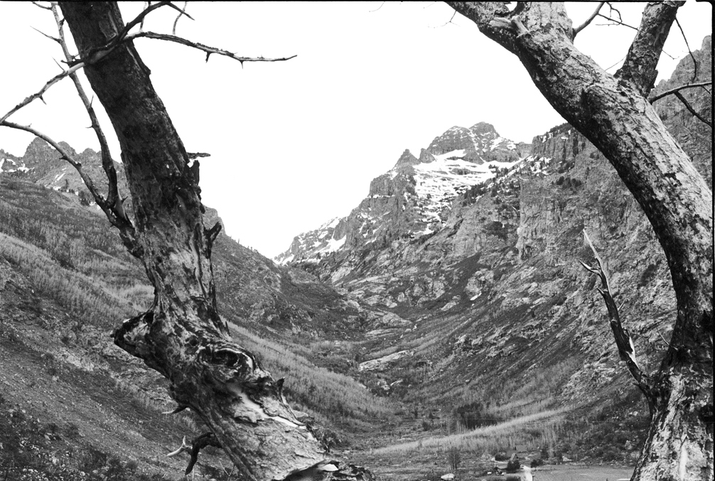

As others have said it is not a particularly easy film to shoot but it can return some truly astounding hi key images with a yellow-green filter. I almost always use it with a fast lens and focus on narrow depth of field because I can no longer hold those slow shutter speeds. If you have one try it with the Nokton 50 f1.4 on a Leica or a Zeiss Ikon. Play around with a few filters and you may be surprised what it can do.
Lately I've been using my Pentax LX with the SMC A 50 f1.2 lens and have been enjoying the results. This was shot with a Rodenstock #15 filter on an overcast day (it actually started snowing later that same day.) I metered for the snow on the peak but it was still blown out. Fortunately the other tones played nicely and came along. Straight print on RC VC paper.
