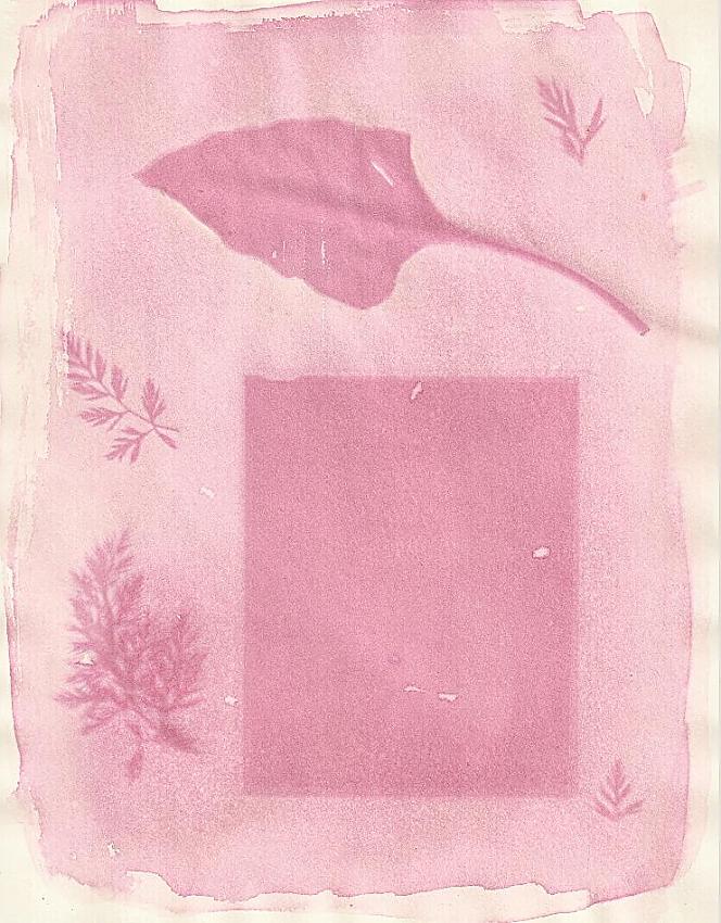

Beet juice anthotype, 4 day exposure. This wasn't really a planned composition, I was just testing various things to see how they came through. But I rather like it. Images are a bit blurred because they moved a fraction when I checked exposure. I probably only needed 3 days for this.
That rectangle is a 4x5 color negative in mylar sleeve. It was starting to print (you can see the sleeve around the edge and density irregularities within the frame), but because I like the negative I didn't want to leave it out in the sun for 2 months so I stopped at 4 days.
Wait I'm confused, why would extending the exposure to two months produce an image? You're saying that this works in reverse where the denser areas with then suddenly get later overtime? I'm a little confused about the time frames when you only did this for three days you said right or four days? maybe it's just late and I'm confused. Lol
Extending the exposure would bleach the pigment under the less dense areas of the negative, leaving...another negative image underneath. Which I hadn't thought about when I set this exposure up. Best to use positives for anthotypes, if you want a positive image.
The process basically works by bleaching what isn't covered, but there are some other chemical effects/interactions with plant material I think because I've seen some multi-colored ones . I don't understand much. This is my first one ever, and my second one, with blackberry juice, is still printing after 5 days. I put many layers of pigment on the second one, so I think maybe that is why it is taking so much longer. Hopefully it will be a more pronounced, contrasty image when done.
So... If you framed this, and then hung it near a window, would the image bleach out?
3 rolls of trix in d76 stock. Came out fine, one roll was from the summer, 2nd from a wedding this weekend, last was a short 12 exp roll to test a camera. Can't wait to look at them on the light box tomorrow.
Yes, this is essentially a direct positive process. Something that's not clear in most of the Anthotype literature. I also suspect it will work best with high contrast subjects.
