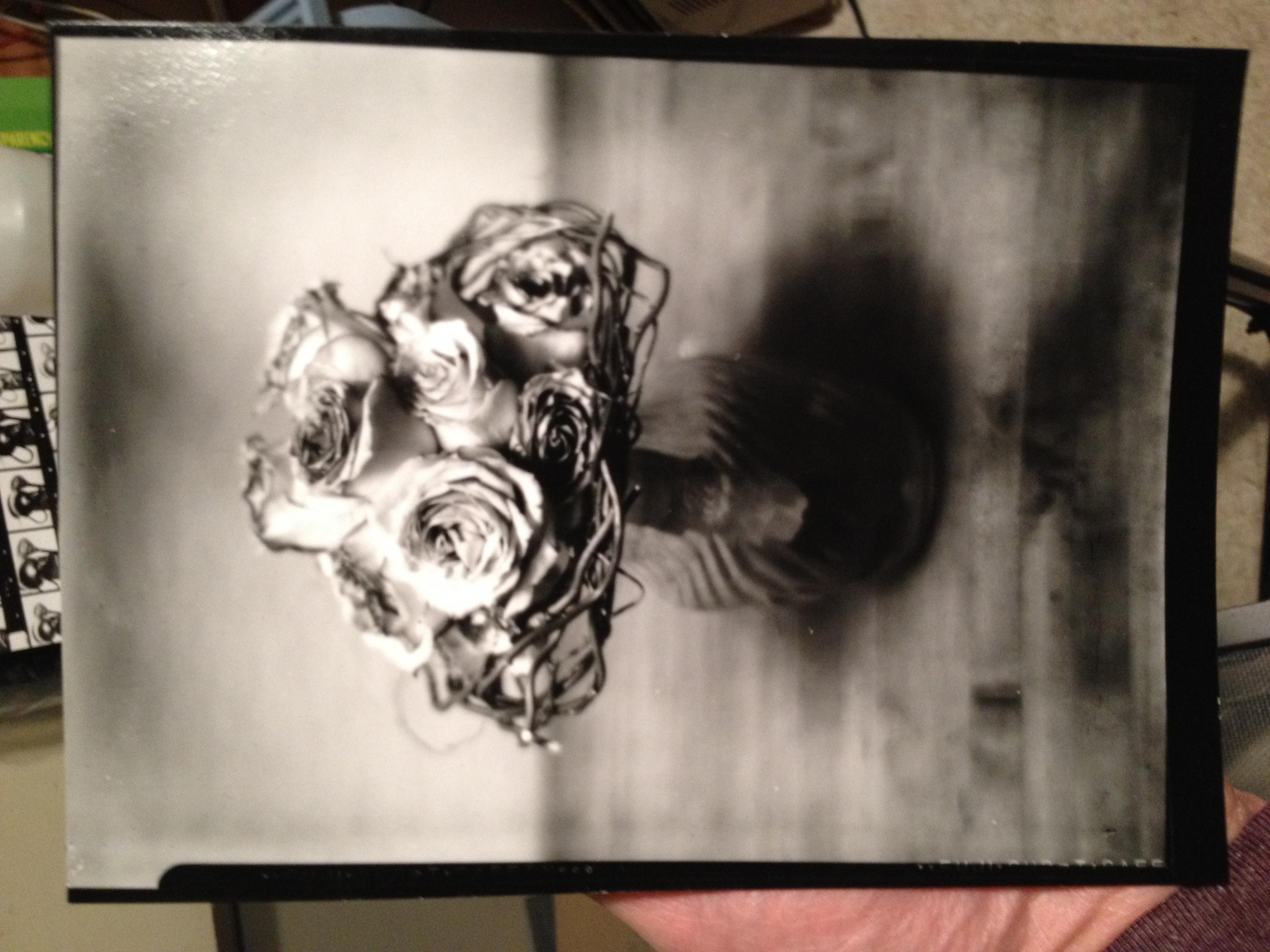

I got married recently over a month ago and I photographed my wife's wedding bouquet. Processed the film a few weeks back and over the weekend, I was able to do a 5x7 contact print. I was shot on an Ansco 5x7 camera with a 330mm BL Petzval lens. I got some amazing results with Fuji HRT xray film souped in XTOL.
Congratulations!
And the bouquet shot is beautiful, it looks great as a contact print! I think you will cherish it many years from now.

Congratulations!
Thanks Bill. This is the first time doing large neg contact print. My enlarger only enlarges up to 4x5. But I was thinking of Ed Weston when I was working on them. It's just so simple in terms of gear and technology, but still challenges me like making an enlargement. Still have to dodge and burn.

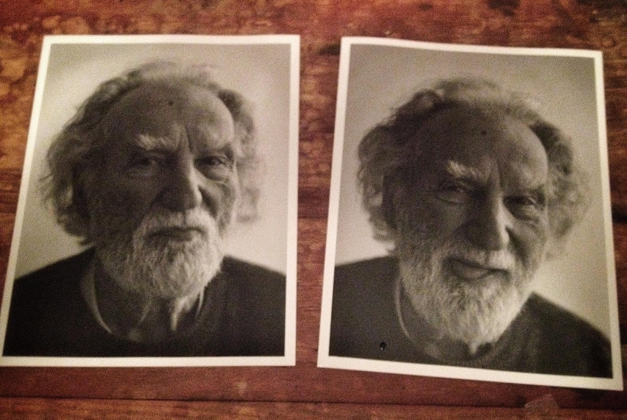

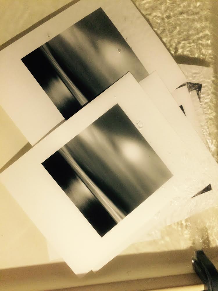

Made six more prints last night, of three different negatives. Printed 8x8" on 11x14" Ilford Multigrade Warmtone fiber semimatte, one picture from my 'Woods' series, and another one that was a 6x6 pinhole negative. Way fun, and I'm feeling like I'm really in the zone, churning out good prints.
Then I made one 5x5" print on 8x10" Ilford MGIV matte fiber of my grandfather, who passed away two weeks ago. My family back in Sweden has requested copies, so I made the test print last night. Today I hope to be making the 30 or so copies with the instructions I wrote down yesterday. It'll be a lot of work, but hopefully worth it to everybody.
