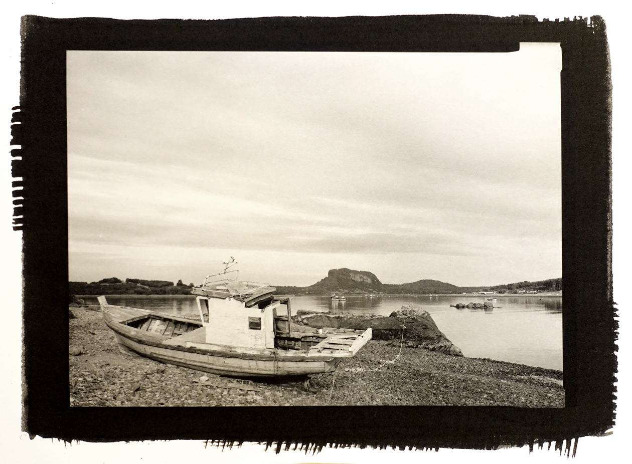

I made a 5x7 platinum/palladium print from an image from Chile a couple nights ago. I have been printing negatives from Zion, but had to sneak this one in. More printing tonight...again concentrating on Zion, but might squeeze another Chilean negative in! Boat, Hualaihue, Chile (southern Chile).
F22 at 1/8 sec, 180mm lens with yellow filter, FP4+ developed in Pyrocat HD in 3006 Expert Drum
Classic pt/pd formula but with no contrast agent, Hahnemuhle Platinum Rag paper, developed in Potassium oxalate, 110F

Vaughn, very nice.
Thanks...I have postponed tonights printing session until tomorrow -- I still need another day to recouperate from the last printing session (6pm Wed to 5am thursday)!

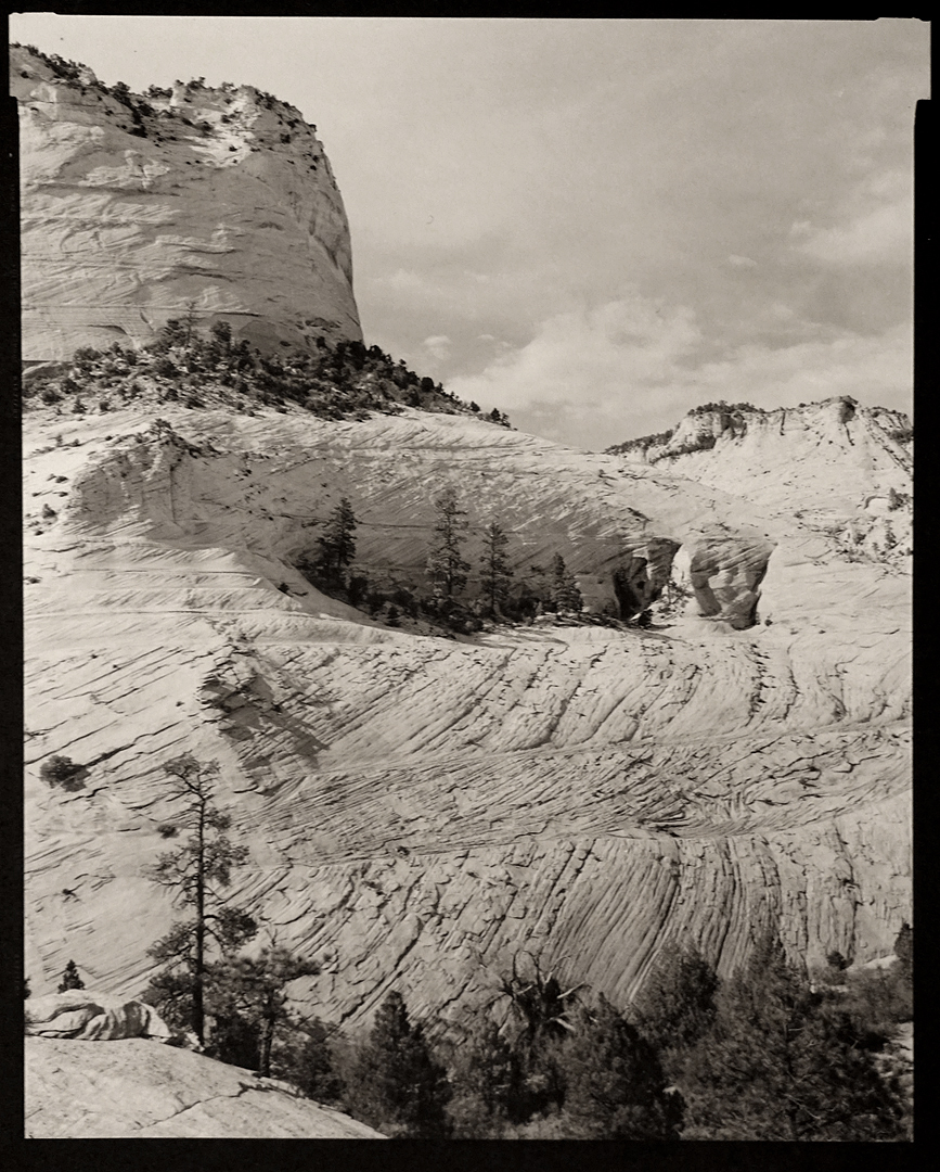

Also from the last printing session...8x10, Zion National Park
