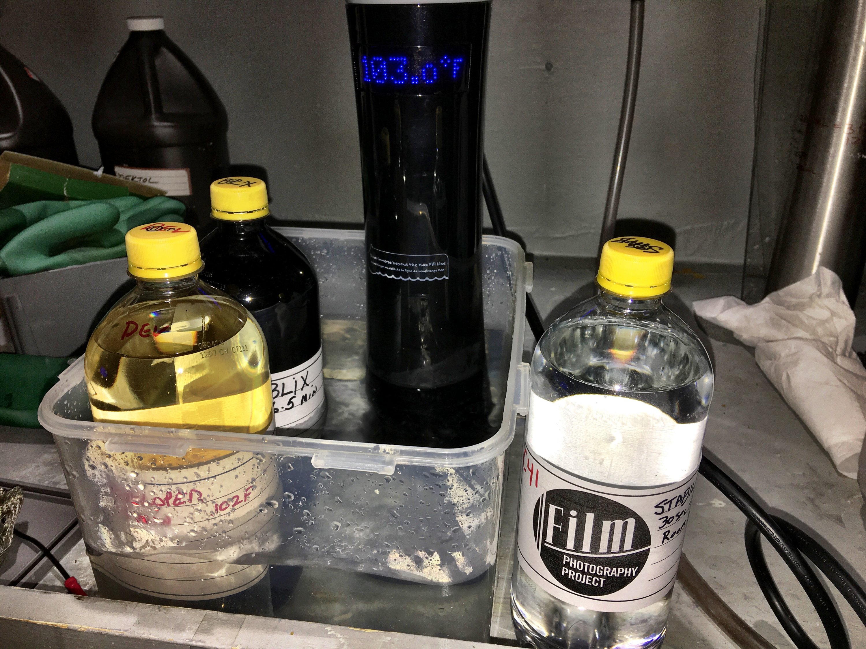

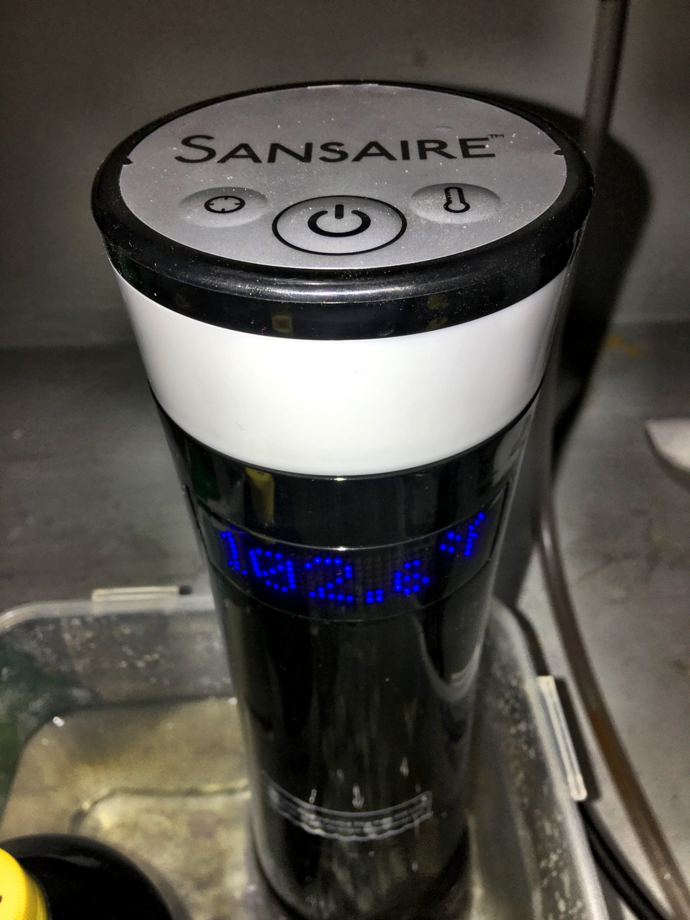

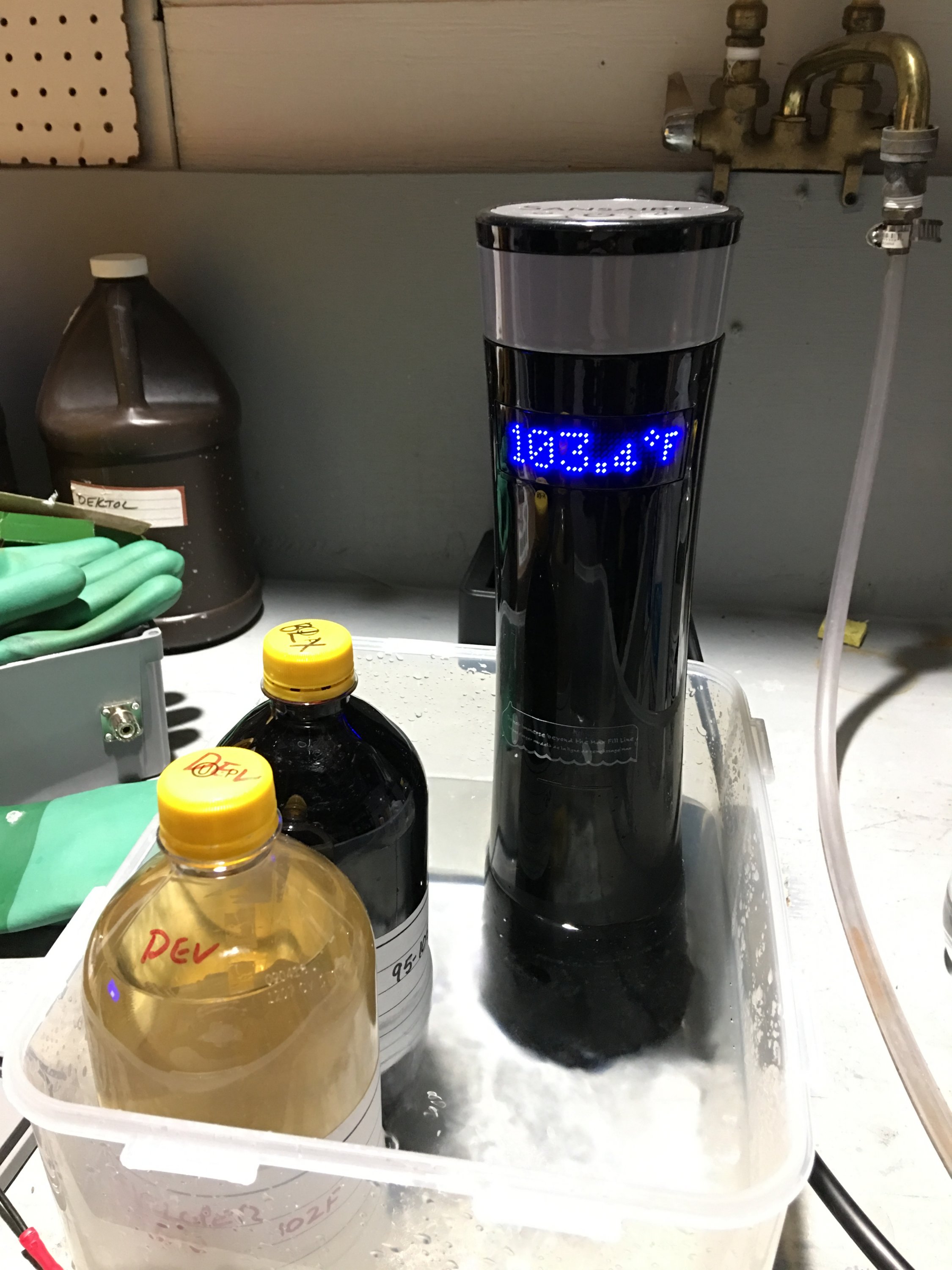

15 rolls of C-41 and two ECN-2 rolls over the course of three evenings. Scanning will take me a few weeks or more. Getting a Sous Vide was the best decision in a while.
