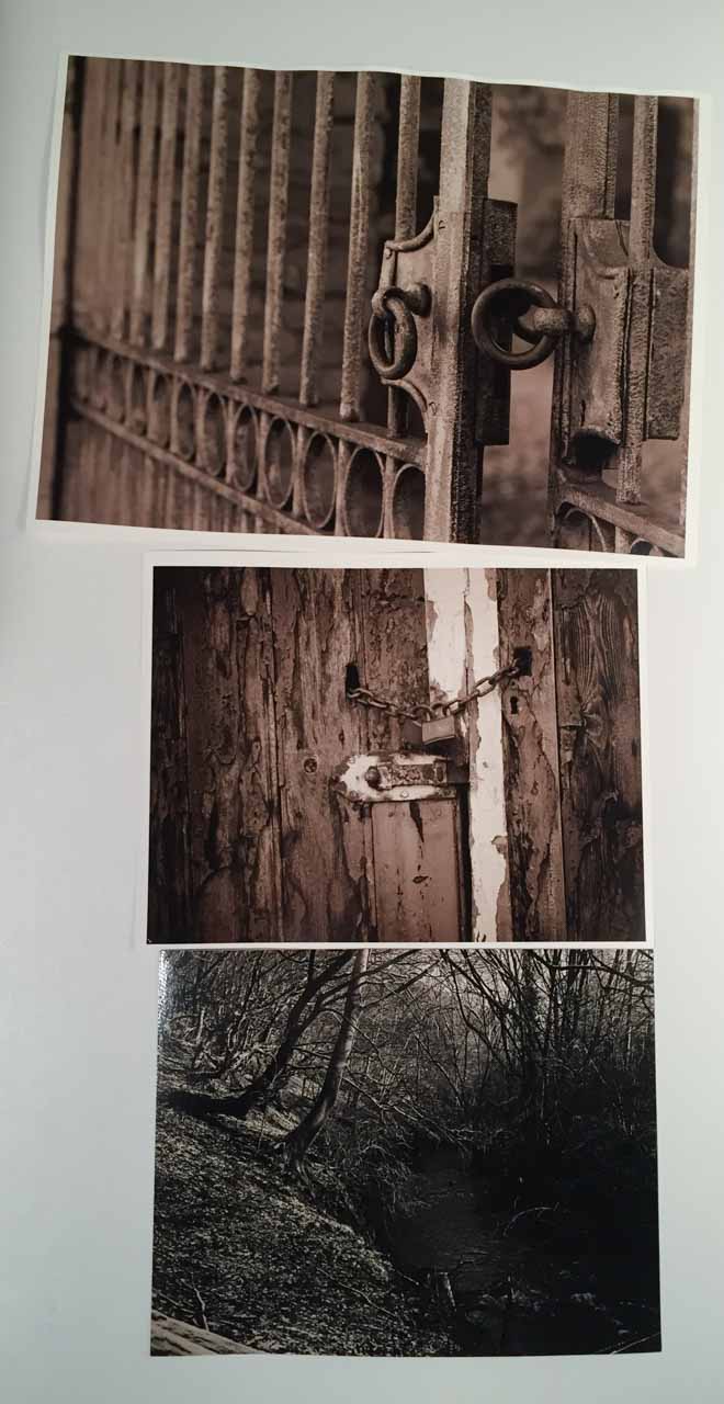

Last night I printed a 9x12 (on 11 X14 ) of a very old abandoned bridge. It is inundated most of the time by a reservoir. I used a 6x7 negative from RZ, TMY, XTOL. Did split grade exposures, using my miracle Metrolux II, and the last version of a Zone VI /Calumet VC cold light. Printed on Ilford Art 300, Bromophen 1:3 , toned in Kodak rapid selenium toner 1:3. Part of this was proving to myself that I could use old school hardening fixer to keep the print from sticking to the belt on my Pako dryer. I used 2 bath Kodak F6 fixer 4 minutes in first and second bath. Went right from the fixer into hypo clear, for maybe a minute, then directly into the Se toner, toned lovely at 68F in 3-4 minutes.
All the rubbish about hardener in fixer and toning, bah humbug! It takes a little longer to tone. The hardener keeps the prints from harm while washing and drying.
