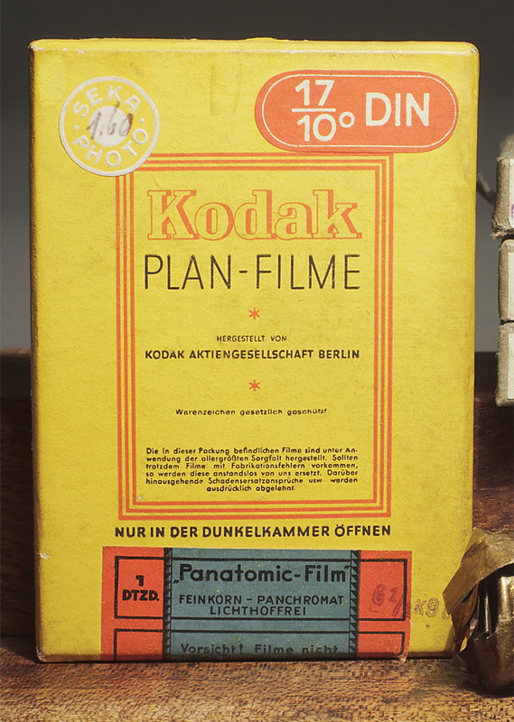

I exposed some sheets of old (expired 1943) Kodak Panatomic in 6.5 cm x 9 cm nitro film.
Made by Kodak Berlin, I didn't know that there was german made Kodak film those days.
Panatomic_1943
by Jens Hallfeldt, auf Flickr

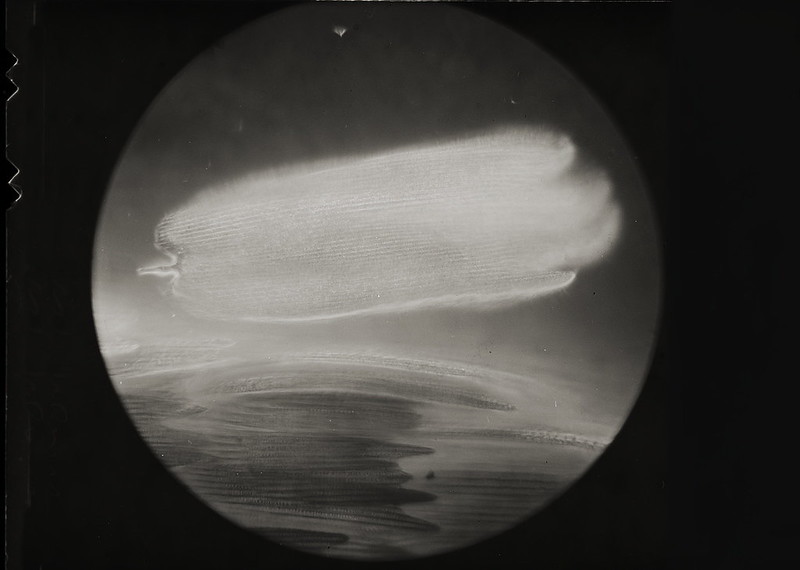

The images look fine for that old film:
MGBM_125 by Jens Hallfeldt, auf Flickr
Still a friendly Film, like low speed Tri-X.
Made using an vintage microscope camera for The Miflex Project: <a href="https://www.flickr.com/photos/136145166@N02/albums/72157686135321996">www.flickr.com/photos/136145166@N02/albums/72157686135321996</a>
Best
Jens
Looks nice Jens. What speed did you expose the film?
Thanks a lot, Wilmarco.
I exposed it at 0 ISO.
Development: 6 minutes in Rodinal 1:50 @ 18°C in a tray
A yellow-green filter was used with 100W lamp.
20 more sheets are still to be exposed. :smile:

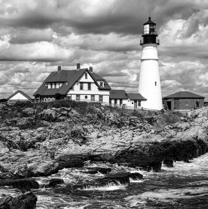

Reworking my darkroom space, so just scans for now... Bronica S2a, Zenzanon 100mm w/yellow filter, and Ilford FP4+ in Ilfosol 3 1+14
Portland head? I really want to come back there!
Correct :smile: I'm only 35 minutes away, but don't get there nearlyas often as I should.
