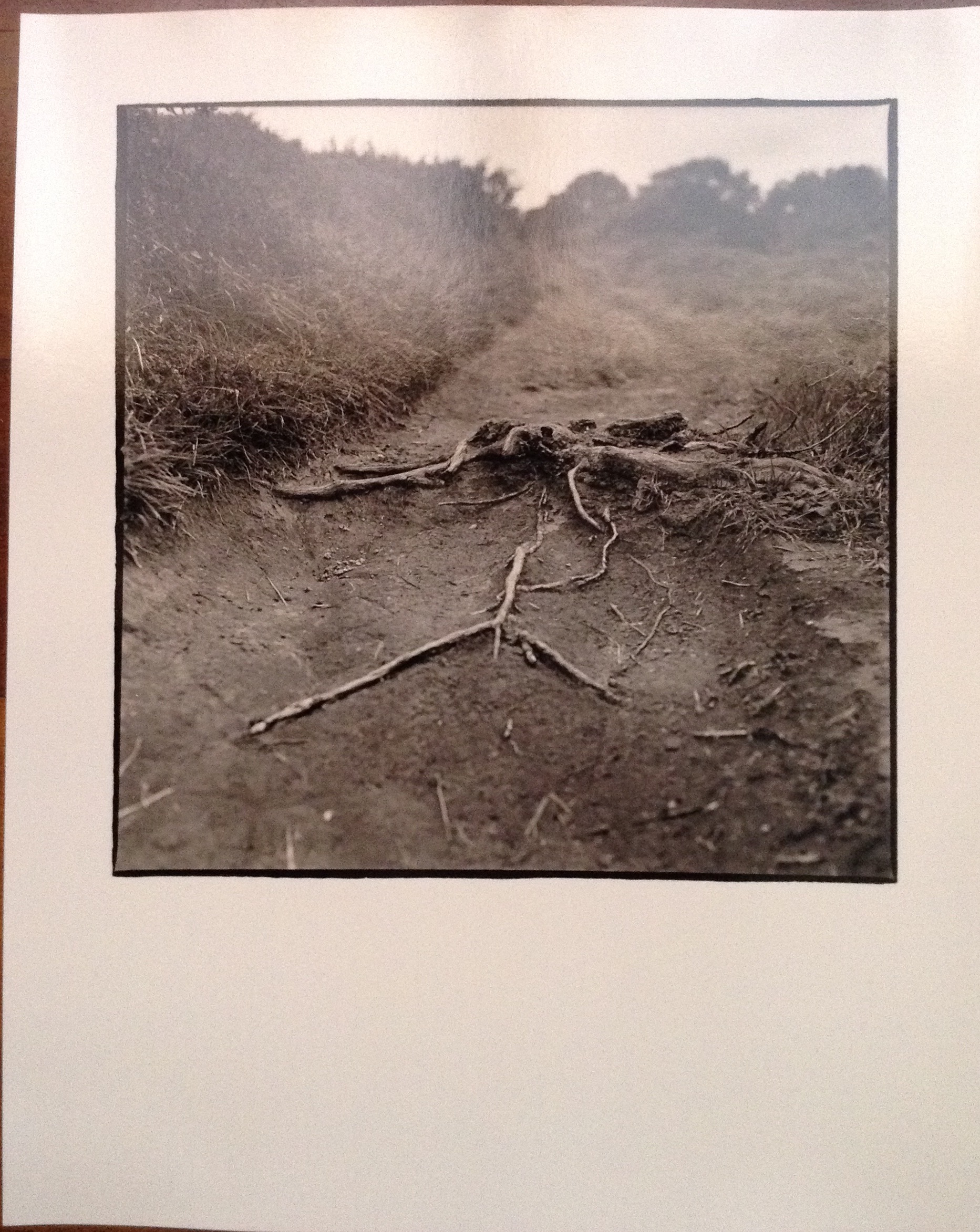

My last print was this past weekend, some copies of the same photograph, for an interchange between members of an Spanish medium format forum ( formatomedio.eu ). The print, in Ilford MG IV FB WT was, afterwards, toned in tiourea and selenium.
My apologize for the crapy phone picture I took.:sad:
