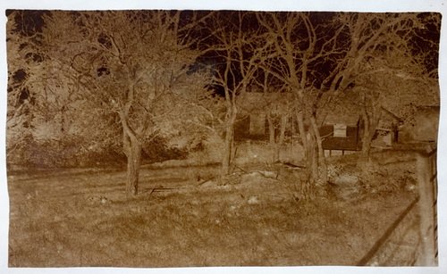

On Monday I exposed and developed a calotype on a new type of paper. I dried it slowly between blotters, and it just finished drying today. Will try a salt print from it soon. I'm excited because it looks like this new paper is going to work very well. I've got a really good feeling that this year it is going to come together.
Abandoned house calotype par Ned, on ipernity

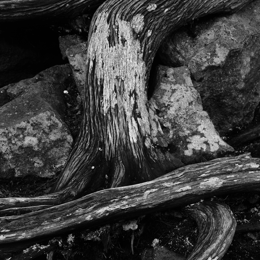

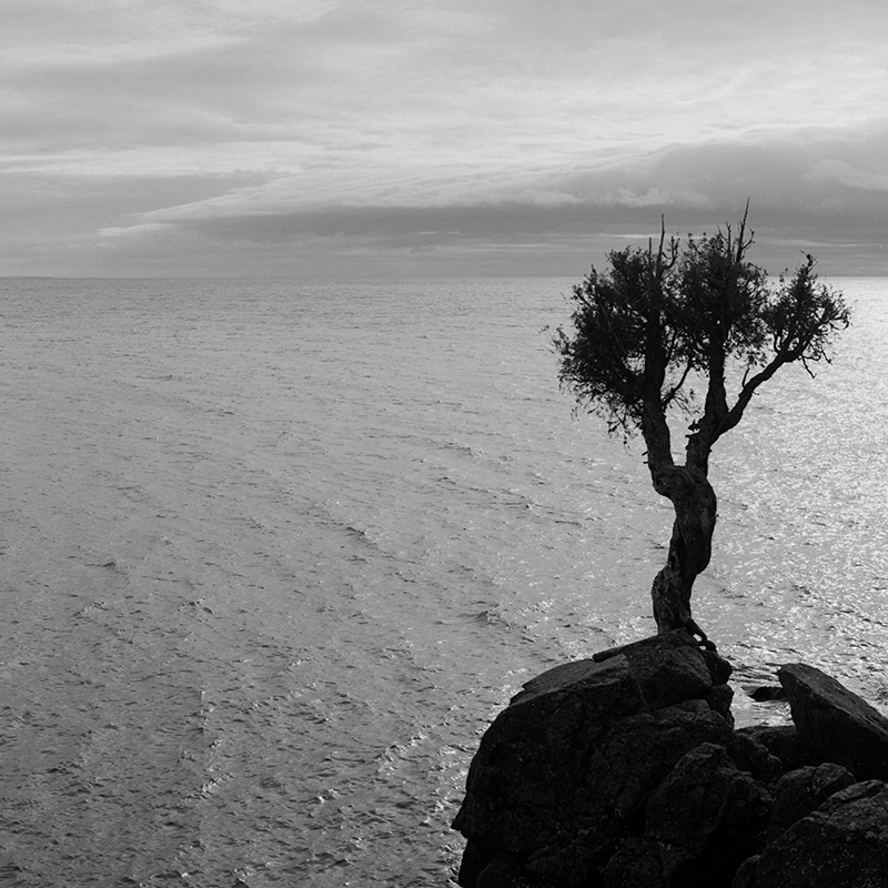

Hi Márcio,
I like #s 2, 4 and 6. And you seem to be getting nice tone in all, are these contact prints?

In the fourth one I like the distant hills and how they make counterpoint to the bench and person.
In the sixth one I like the overall pattern made by foreground, town, hills and sky!

Thank you for the comment :smile:
They are all contact prints which make a nice size, kind of postcards.

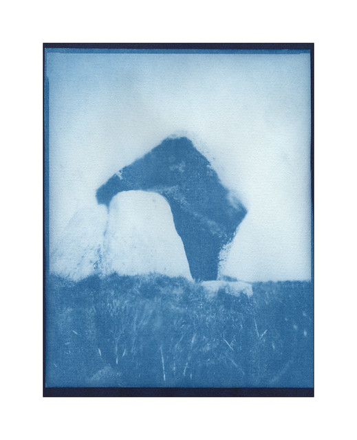

I realised I hadn't made a single cyanotype from a paper negative, so I made one today.
This is on Daler Bockingford (NOT) 150gsm, gelatin sized. It's a bit too thin and texturey for my taste, but it's all I've got that's big enough for a 10x8.
Rather a dense negative and it could have done with another 15 or 30 mins, but I am impatient (this is not a good trait for the photographically inclined :whistling:)
The neg was made in a foamcore pinhole camera.

I've got a salt print sitting in toner right this second, from a homemade calotype. I was already excited about the new paper I'm using for calotypes, but this is making me more excited. After 15 minutes facing away from the sun toward north open sky, this one had darks almost as dense as the border, but still has bright white highlights. I love the way the "upper half" of the print, the parts from the mid-tones up to the highlights have incredibly delicate detail in a salt print.
With a commercial paper negative, my salt prints usually face north for an hour or two, then directly at the sun for about an hour. This one was done after 15 minutes north, then I gave it just 1 minute at the sun to lock in the darks. ( It reminds me of split grade printing ) So I'm trying to get used to these new fast printing times!
