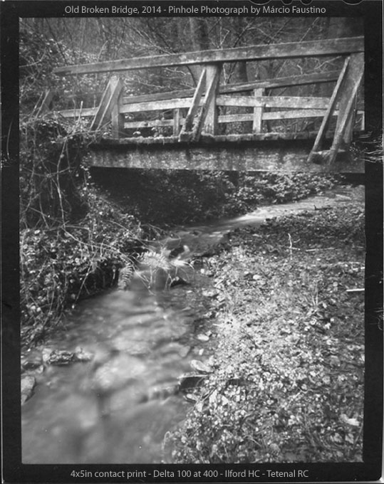

Here is mine:

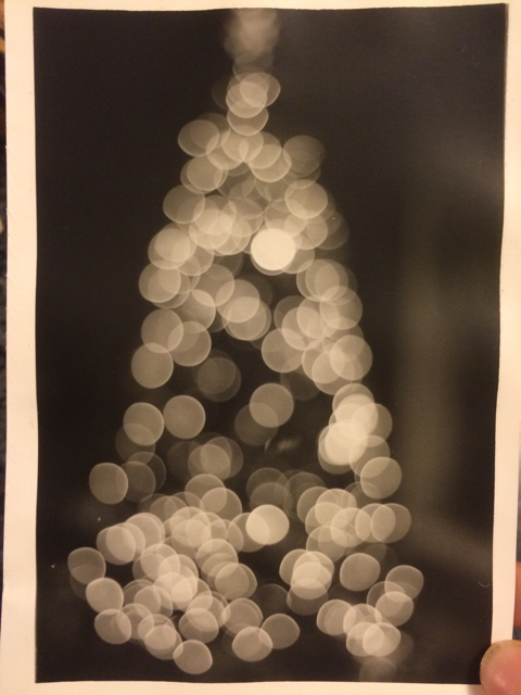

Couple of pictures from last night's darkroom session.
Old Kodak Tmax 100 shot at 25, developed normally in Arista Premium Developer. Unknown FB paper in PolymaxT. Luckily I have a lot of the paper because I like how it comes out (tone and the finish).

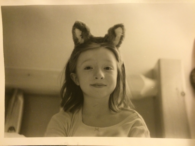

Confident kid:

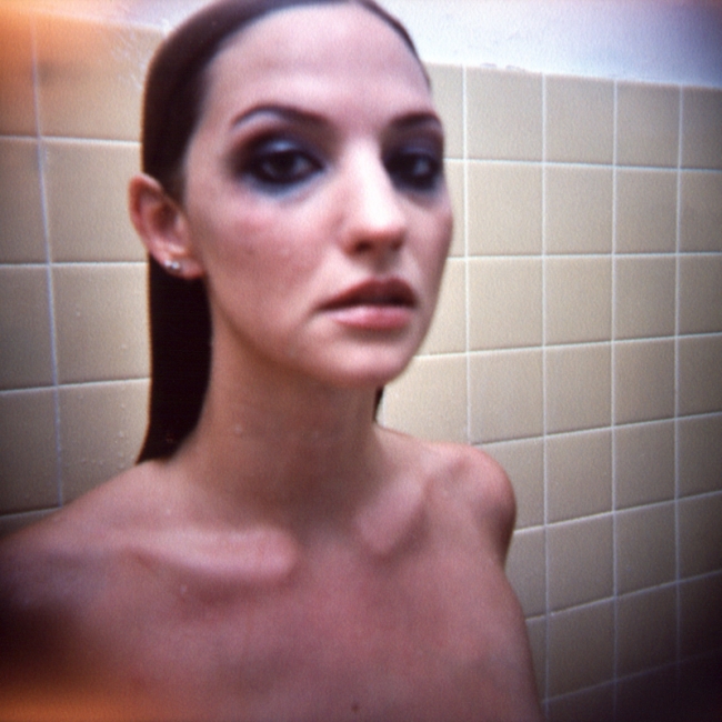

Thought I had taken this on color film lol:

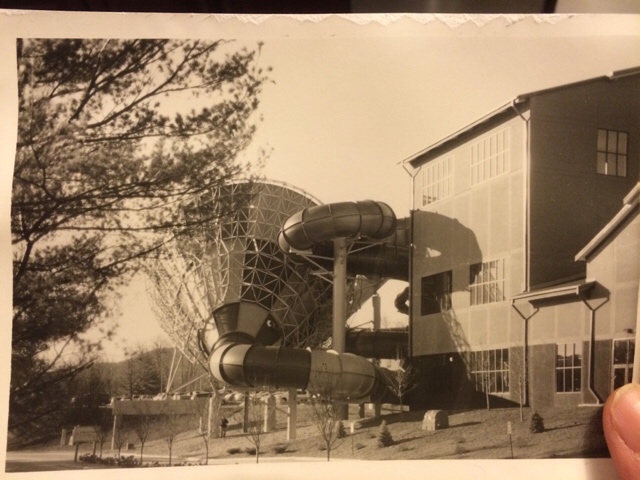

I went down the inside of that sucker many times with the kids. Water slide at Great Wolf Lodge in Fitchburg MA
Nikon 50mm f/1.8 all wide open. I figured out how to get the FB prints flat without any special equipment like a print press or dryer.

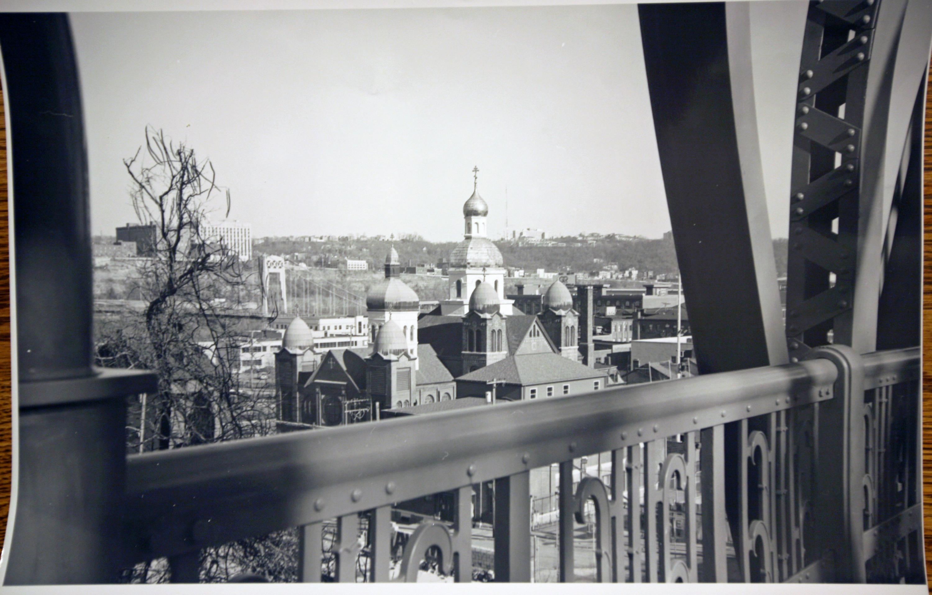

11x14 Kodak Polycontrast III RC paper I got a couple years ago for free when the local art center darkroom was shut down. PlusX 125 film that was also old but refrigerated was shot in a Zies Ikon Nettar camera at f16 1/125 second. Development of the paper was in straight Dektol 1 min. Development of the film was in D76 at 68 degrees F for 9 minuets. This print was photographed in a Canon 5D camera. The subject is a church on the south side of Pittsburgh, Dec. 26, 2014

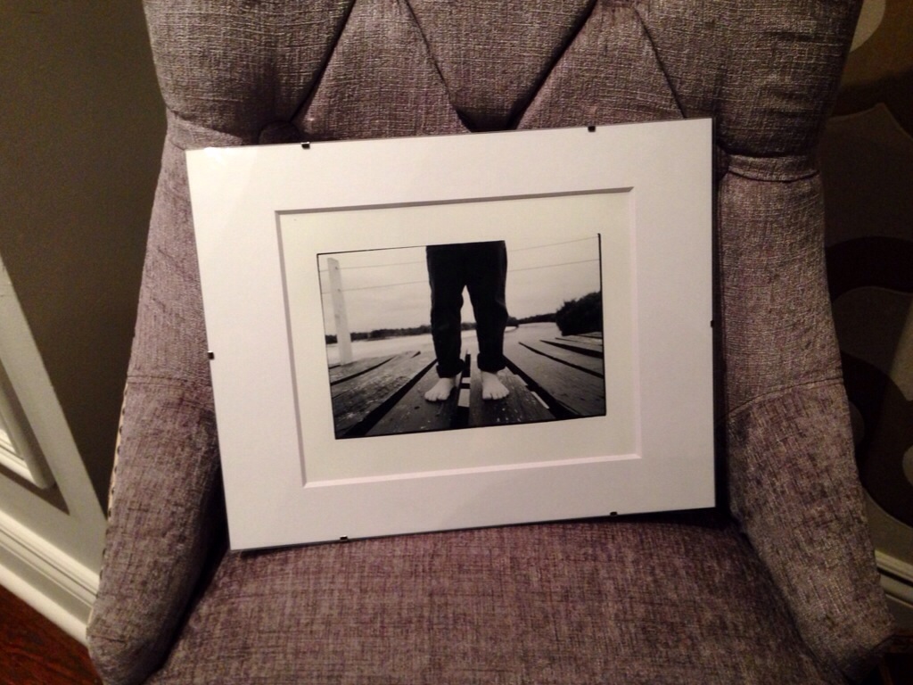

Purchased a bunch of 1$ brand new frames, ordered mats and printed a few 8x10s to try them out...

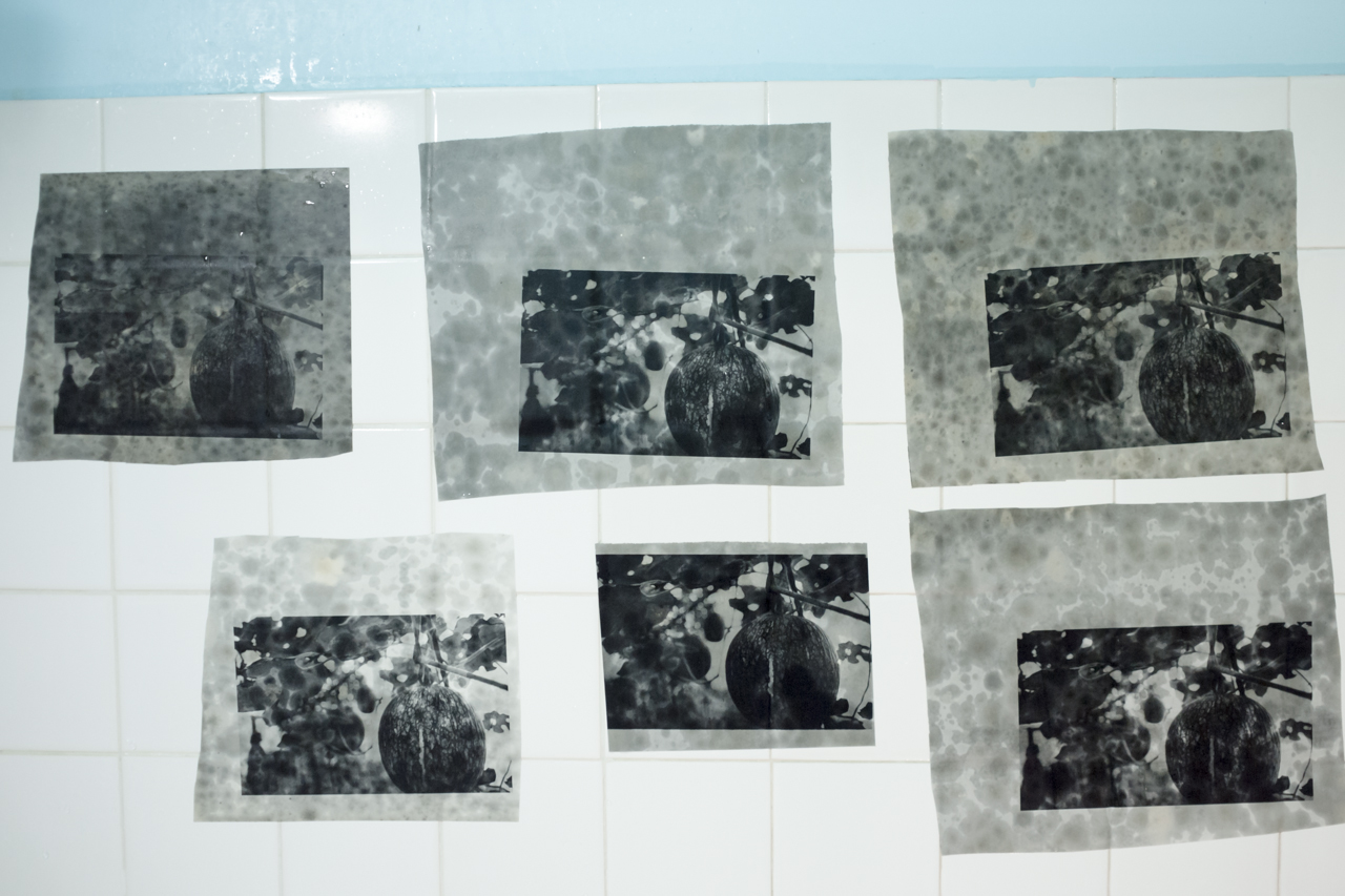

Kentmere Aphograph Bromide paper - 70 years old
I wondered what my roll of Kentmere Aphograph Bromide paper might be like after 70 years, so I tore a few squares off and tried it with increasingly large amounts of benzotriazole, the following was the outcome ... not quite like fresh paper, but then I expect I'll be a bit blotchy too when I'm 70-odd ... :D

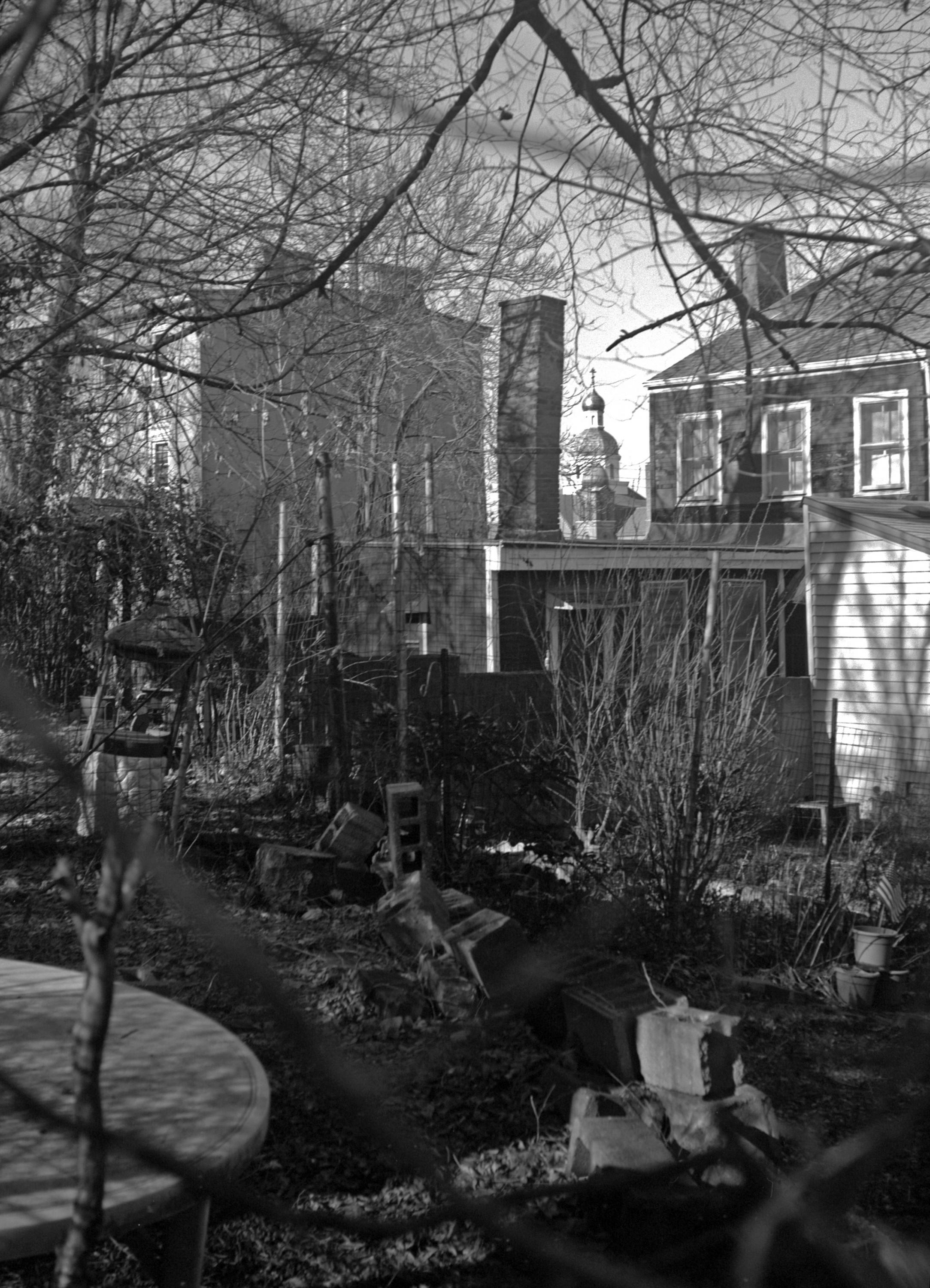

Tri-X 400 in a Pentax K2, taking pictures in the yard. I just got my tanks set up and chemicals mixed, so I needed a test roll. I exposed several frames each at 100, 200, 400, 800, and 1600. They all look pretty good on the negative. I love Tri-X.
After the test run, I'd say I need more time in the fixer. Otherwise, so far - so good. First roll I have developed in 20 years and I really can't complain about the results. Once I'm satisfied with my tank times, I can start running some 120 rolls through. Then I can get set up for contact printing. Enlargers are practically free on CraigsList, but I just don't have the space.
