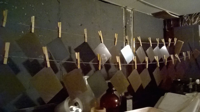

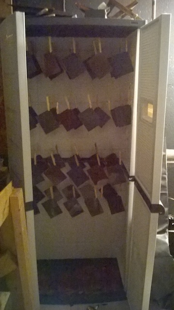

80ish E100 film ( 4x5 chrome ready loads )
2 ( #1 was around 35 films, @2 around 45 runs in dektol and then Dcaffenol
worked like a charm
i had barely enough clips to hang them !
weird stuff though, pre-wet was greenish dye, dektol started clear and was hot pink at the end ...

Blimey, that's a good work rate.

i have to remove the film from the line
and see what i caught maybe today ..
