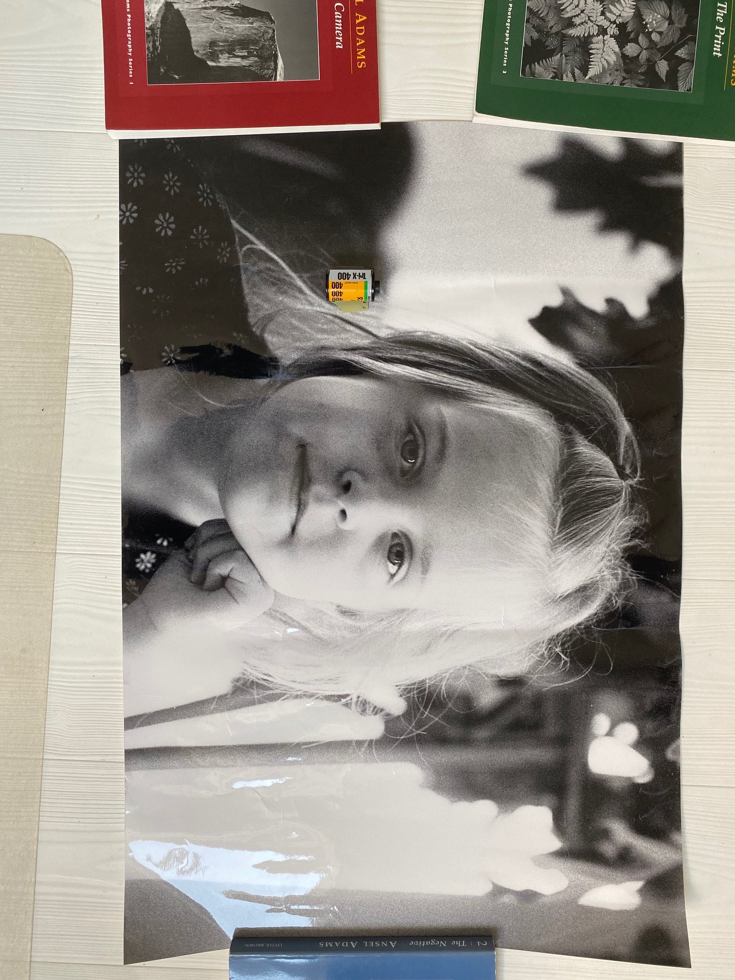

This is a 50x75cm (20x30 inch) print from a 35mm tri-x negative.
This negative was scanned, but you can do the same in the darkroom.
