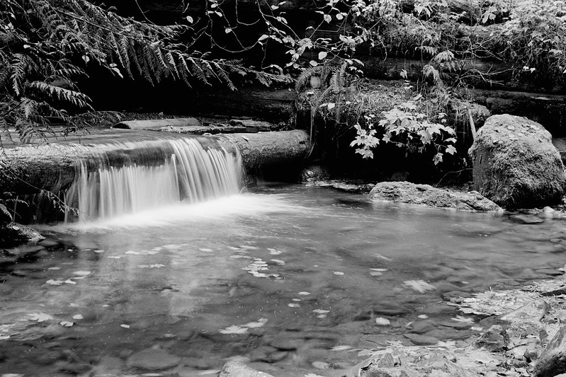

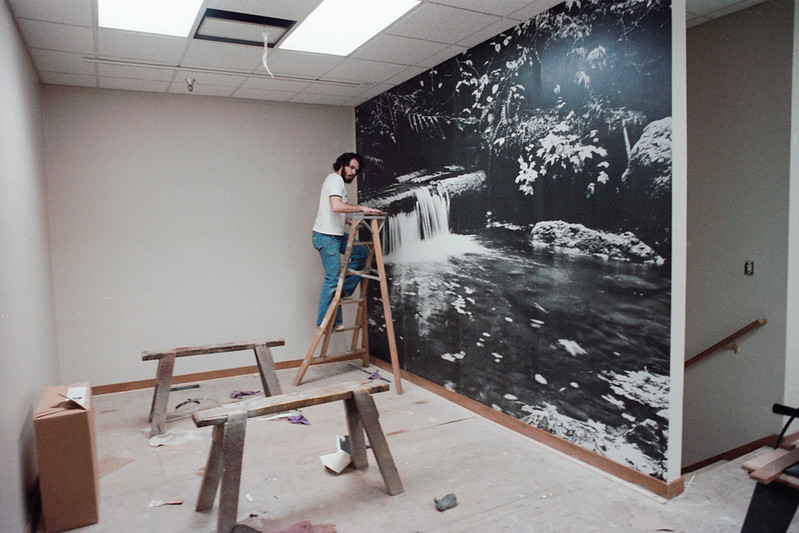

Back in the early eighties, someone wanted one of my images from a hike in the Olympic National Park, taken on 35mm Plus-X. He wanted to install it into a new bank in a town south of the park. No problem, I even helped install it.
In my bachelor days, I always wanted to coat a wall of my apartment with liquid emulsion, then expose the wall to my enlarger, and process it on the wall. The issue was the fixer stink...
How did you get the enlargement made, so you could hang it like wallpaper?
I only supplied the negative! My ex-wife's uncle owned a commercial display business in Seattle. He had the job of doing the display work for the construction of the bank. He handled all the production, by a method which I've forgotten and I took part in the installation of the "wallpaper". I do remember being very impressed with the quality, especially coming from a 35mm! The largest print (silver) that I ever did was a mere 16x20. Reflecting on it, I believe that I possibly gave him a very good 8x10 silver print that he used.
