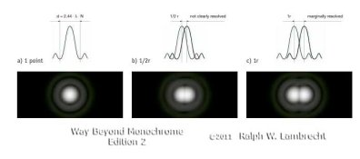

... lp/mm = line pairs per mm. lines/mm should equal the same thing, since the correct thing to do is to assume that it takes 2 lines to define, well 2 lines, 2 lines is going to equal 2 'points' in one direction. Therefore if the number of points per mm is equal to x, then lp/mm must equal to x/2, as 1 line pair = 2 adjacent points of detail. ...
The diameter of the airy disc is 2.44. By using a value of 1.22 the division by 2 has already taken place. The equation used by A49 and I is correct (see attached). If you call that 'pseudo science' too, you're on your own.

"The diameter of the airy disc is 2.44. By using a value of 1.22 the division by 2 has already taken place. The equation used by A49 and I is correct."

And it becomes diameter/4, so 1.22 doesn't account for that.

The equation 1.22 * wavelength * (focal length/aperture) gives you the diameter of the airy disc, not half the diameter. It is the smallest size of a possible single point, not a pair of points. A line pair is a pair of points. So as I stated, the many of values given by A49 are actually above the diffraction limit.

The equation 1.22 * wavelength * (focal length/aperture) gives you the diameter of the airy disc, not half the diameter...
Please indicate the source.
In all the literature I consulted the number is 1.22 and is associated with the first zero in the bessel funtion of the first kind, so is the radio of the cone.
Even in wikipedia is clear:
The factor 1.220 is derived from a calculation of the position of the first dark ring surrounding the central Airy disc of the diffraction pattern. The calculation involves a Bessel function—1.220 is approximately the first zero of the Bessel function of the first kind, of order one (i.e., J1), divided by π.
Source: http://en.wikipedia.org/wiki/Rayleigh_criterion#Explanation
This is not the central issue however that you are straw-manning.
Athiril
Your equation is still wrong. You are confusing diameter with radius. You'll find the equation for diffraction-limited resolution in many books on optics and photography. Please look it up!
Your DoF equation is still missing, by the way.
