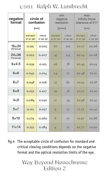

Thanks for the link. Looks like a good spreadsheet even that I find the mixture of metric and English units within one spreadsheet a bit odd. Also, the 'blur circle' (CoC) is a bit too liberal for my taste. These numbers aim for a maximum resolution of the human eye of about 4 lp/mm. Most eyes can do better than that and get to at least 7 lp/mm, and detection (not resolution) can easily go up to 20 lp/mm and more. A table with respective CoC values is attached.
Yes, the mixed units are odd, but not out of keeping with much of photography in that regard, especially in the US. The CoC values are suggested in F3:K3, but you have to enter whatever CoC value you want to use in the cell [B3] that's actually used for the calculations, so you're not stuck with the Schneider default. It's also easy enough to edit and apply a conversion factor so that results are in your preferred units.
I also find it nice that the spreadsheet comes from a source that most folks (I wouldn't dare claim 'everyone' on the internet) should find trustworthy.

As you can see,
f/4 50mm 35mm @ 2 meters focus;
close focus: 1.1818m
far focus: 2.222m
DoF: 0.403m
f/8 100mm 6x7cm @ 2 meters focus;
close focus: 1.812m
far focus: 2.231m
DoF: 0.419m
As you can see, we have the same DoF from the same aperture.
As I can see we have the same DoF at different apertures in terms of F-stops .
In my point of view it makes no sense to mess up the use of f-stop values. You are right: The absolute diameter of the aperture opening of a 50 mm lens at f/4 and a 100 mm lens at f/8 is the same: 12,5 mm. But there are not many photographers that uses absolute diameters in practice.
The negative format does not play any role for the resolution kept on the film. It is only important for the maximum, still sharp print size that you can later obtain from the negative. So Ralph is right, when he says, that the DoF in terms of resolution is fixed in the negative. But Ralph is not right, if you look from the print format´s point of view. Then the DoF seems not to be locked in the negative and the DoF we observe in the print changes with the enlargement ratio for the print. There is no antagonism or paradox in it.

Andreas
There is nothing wrong with your numbers! Athiril's statement that all of your resolution values are above the diffraction values is not correct. If you take the near-IR threshold of 650 nm, the smaller f/stops are getting close to being borderline, but take the average of 555 nm, and your numbers are just fine. Also, your lens resolutions stated are well within the system performance of good equipment and materials.
