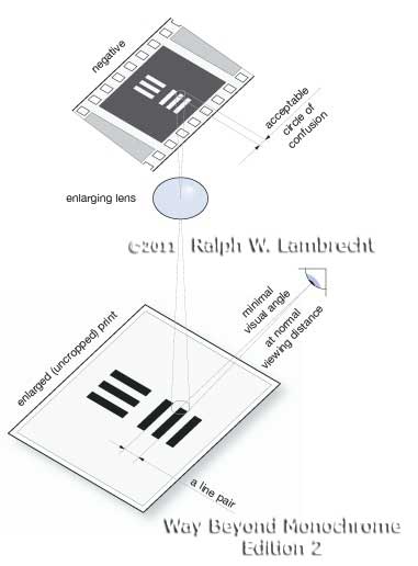

Nicely followed through! How did you calculate the CoCs? I get 0.022 mm where you've got 0.011 mm.
Ralph,
For the 0.011mm value I used:
c = (1/60)/57.3 x 10 x 25.4 / 7
i.e. converting 1/60 of a degree to radians and converting 10 inches to mm. But it's quite possible that I've slipped a factor of two somewhere by not allowing for line pairs or something.
Then I used:
(vn - v) / vn = c / d
from the Wikipedia page to get vn for the near focus point, and found the corresponding object distance 'u' using the thin-lens formula:
1 / f = 1 / u + 1 / v
as you will of course realise. Then I repeated the process for the far focus point etc.
Even if the standard viewing distance for a 10x8 print is of order ten inches or so, I might view such a print in a gallery from a distance of six feet, say, and I certainly wouldn't look at a postcard print from six inches. So DoF turns out to be a bit of a slippery customer!

... But it's quite possible that I've slipped a factor of two somewhere by not allowing for line pairs or something. ...
That's it!
There is another minute error in there, because the viewing angle should be halved first, to calculate the tangent, and that value should be doubled again afterwards, but with tiny angles, such as these, it's negligible.
None of this changes your point, though.
Nice job!

That's it!
I'm more accustomed to hand-waving, order-of-magnitude type stuff...
Nice job!
Thanks!
