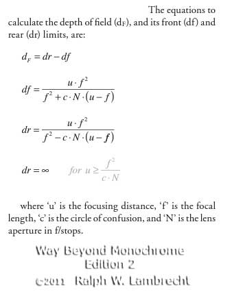

In reading the interesting comments to the tests carried on by the site theonlinephotographer, quoted by Lee, I ended on Wikipedia, normally not the best place where to look for reliable information admittedly, and I found this at the voice "Depth of field"
A subject distance is decreased, the subject magnification increases, and eventually becomes large in comparison with the hyperfocal magnification. Thus the effect of focal length is greatest near the hyperfocal distance, and decreases as subject distance is decreased. However, the near/far perspective will differ for different focal lengths, so the difference in DOF may not be readily apparent.
[formulas here, that don't cut-and-paste well]
so that for a given magnification, DOF is essentially independent of focal length. Stated otherwise, for the same subject magnification and the same f-number, all focal lengths for a given image format give approximately the same DOF. This statement is true only when the subject distance is small in comparison with the hyperfocal distance, however.
This somehow justifies the images published by Ralph with the apparent inconsistency of the principle in the macro world. The "advantage" of the higher DoF would exist only from somewhere near the hyperfocal distance on.
In the macro field, lenses work at distances that are much below the hyperfocal distance and, in that working range, the DoF advantage of shorter focal lengths disappears.
Hence the success of 100mm macro for field work, and let's say the fact that the 4:3 camera are not considered more suitable for macro work than the 135 cameras. If the DoF advantage of shorter focal lengths had applied to all focusing distances, 4:3 users would have enjoyed a "free meal"* so to speak, and the other formats would be at strong disadvantage, and macro photography would be a selling point for 4:3 material.

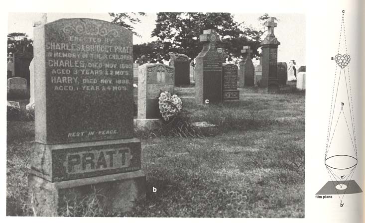

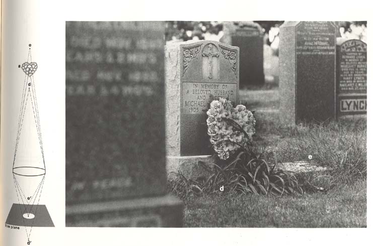

I am trying to up;oad the pages from time-life the camera which helped me.
cowanw
Aug 29, 2006
2,235
Hamilton, On
Try again
image on the left 28 mm lens
Image on the right 135mm lens
The hole in the film plae schematic represents the COC

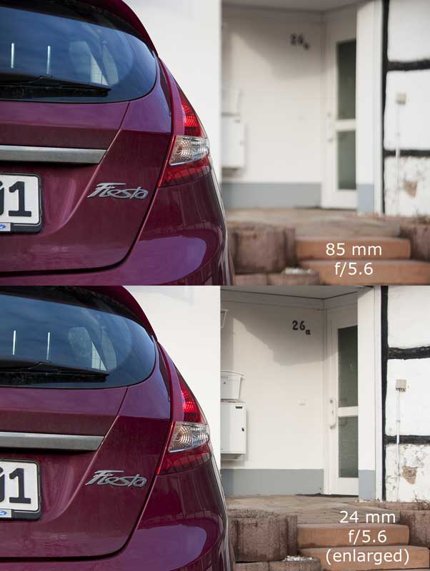

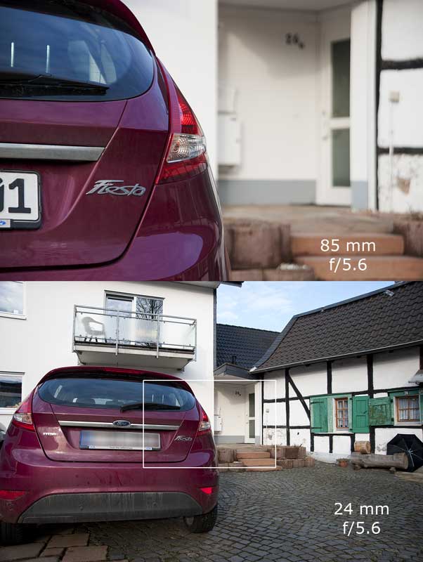

... PS Athirill, that is what I was thinking myself, but the pictures posted by Ralph showed that even after enlarging the difference in "out-of-focusness" is quite apparent. One would expect that, after enlarging a section of the wide-angle picture, the CoCs would be similar to the ones of the tele-lens picture. Ralph, the way I see it, did bring the "equal magnification" factor into the test, and the DoF still showed a difference.
I should have provided the math for these images:
24 mm 85 mm
focus distance 2 m 2 m
f/stop 5.6 5.6
CoC 0.022 mm 0.022 mm
DoF front 1.41 m 1.94 m
DoF rear 3.46 m 2.07 m
total DoF 2.06 m 0.13 m
Strictly speaking, the back wall is out of focus in both images (so is everything in front or behind the tail lamp). The point is, the DoF is much larger with the shorter lens (see the numbers above). Using such a lens, one has a better chance to get much more acceptable detail (definition of DoF) into the image. The math hints at it, and the images prove it.
One could claim that after enlarging the 24mm image to fit the 85mm image frame, the CoC should be corrected accordingly and thereby reducing the DoF. Well, the enlarging factor was roughly 3.5, so, let's reduce the CoC by it and let's see what happens:
24 mm 85 mm
f/stop 5.6 5.6
CoC 0.006 mm 0.022 mm
DoF front 1.79 m 1.94 m
DoF rear 2.26 m 2.07 m
total DoF 0.47 m 0.13 m
The DoF for the 24mm image is now significantly reduced but still almost 4-times larger than the DoF of the 85mm image!
No matter how you slice it, the statement that there is no DoF benefit from going to a shorter lens is incorrect, and every owner of a miniature-format camera has experienced it. As they can tell you, this benefit can be a disadvantage.

Unfortunately, that won't get the focal length out of the equation either. (see previous post).
A 50mm lens at f/8 has the same aperture dimension as a 100mm lens at f/16 (6.3 mm), but the 50mm lens has more than double the DoF at that setting. Indeed, you have to stop down to f/32 with the 100mm lens to match the 50mm lens at f/8.
It does however work when the two lenses are used on different film formats:
For example, a medium-format 80mm lens at f/8 and a small-format 40mm lens at f/4 have the same opening (10 mm) and produce the same DoF, because the medium-format CoC is twice as large as the other.
However, there is no need to make it that complicated. The above equations work well and show the influence of subject distance, focal length, aperture (setting) and film format. Arguing that one or the other variable does not matter if compensated by another is just a stealth way of arguing for argument's sake.
We heard it all now: 'same enlargement, same DoF' or 'focal length does not affect DoF'. Yet, the math and the pictures tell a different story.
