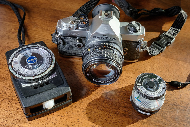

I am back to using my 55 y/o Gossen Super Pilot CdS. It is still accurate with the proper voltage (WEIN zinc-air cell or #386 silver-oxide in MR-9 adapter) and is very capable, including down to EV -6. I also have two defunct Gossen Luna Pro SBCs. Therein lies the problem - no one in N. Am. or elsewhere will repair "legacy" Gossens, not even Gossen in Germany. So, if anything happens to my Super Pilot I'll be looking at Sekonic - they do have US service.
What is the "FE"?

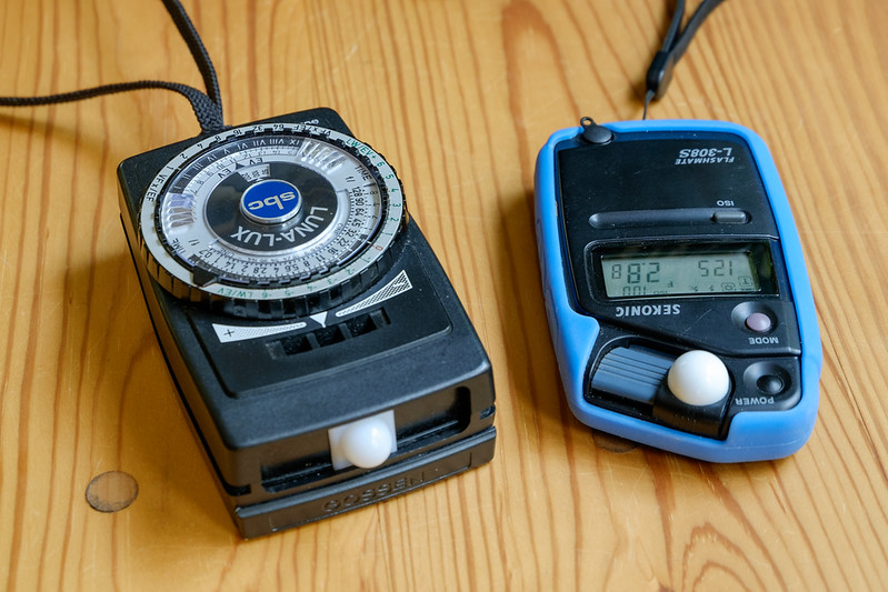

In this photo, the two meters I have don't look all that different in size, but in real life the difference is more noticeable.
And here is the Luna-Lux compared to the smaller L-208 mentioned in posts #15 and #17
yes I see . Thank you. That Luna Lux is almost as big as an SLR. The FE is the Nikon FE SLR camera that has a very very good meter.

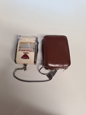

This is the kind my dad left me. Is it selenium? Even though it doesnt have the bumpy, glass block type lens on it?

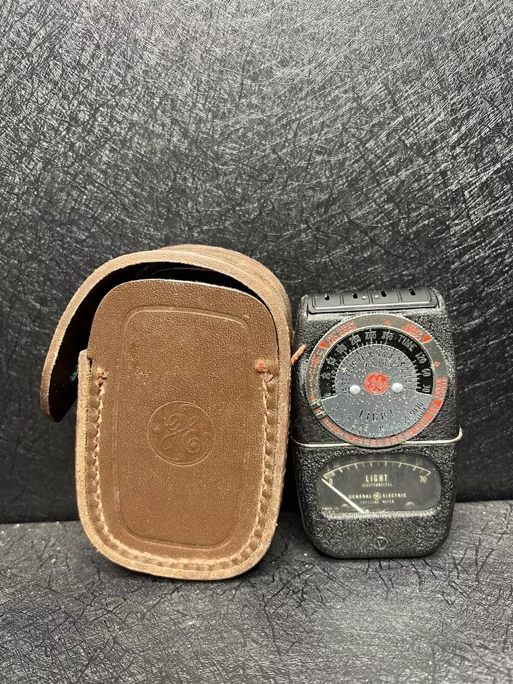

I use a Weston VI, it is selenium, I just checked against my Gossen SBC, spot on. In low light the SBC is much better. If you are for cheap then look for a working GE DW 68, it is a selenium cell, comes with hood. In goodlight the lid is closed, in dimer light the lib pops up, in very poor lighting the hood comes off. I have one, I still use when shooting with my Argus C3, although it matches my Watson and Gossen and I could use it all the time. The trick is making sure it is working. Somewhat fiddley to set the ASA.

It's a CdS meter. Anything old(ish) that takes a button cell battery uses a CdS element for sensing light. The meter will also have a press-to-read switch on the side - not definitive as Se meters with trapped needle movements can also have a switch on the side that releases the needle so you can get a reading.
