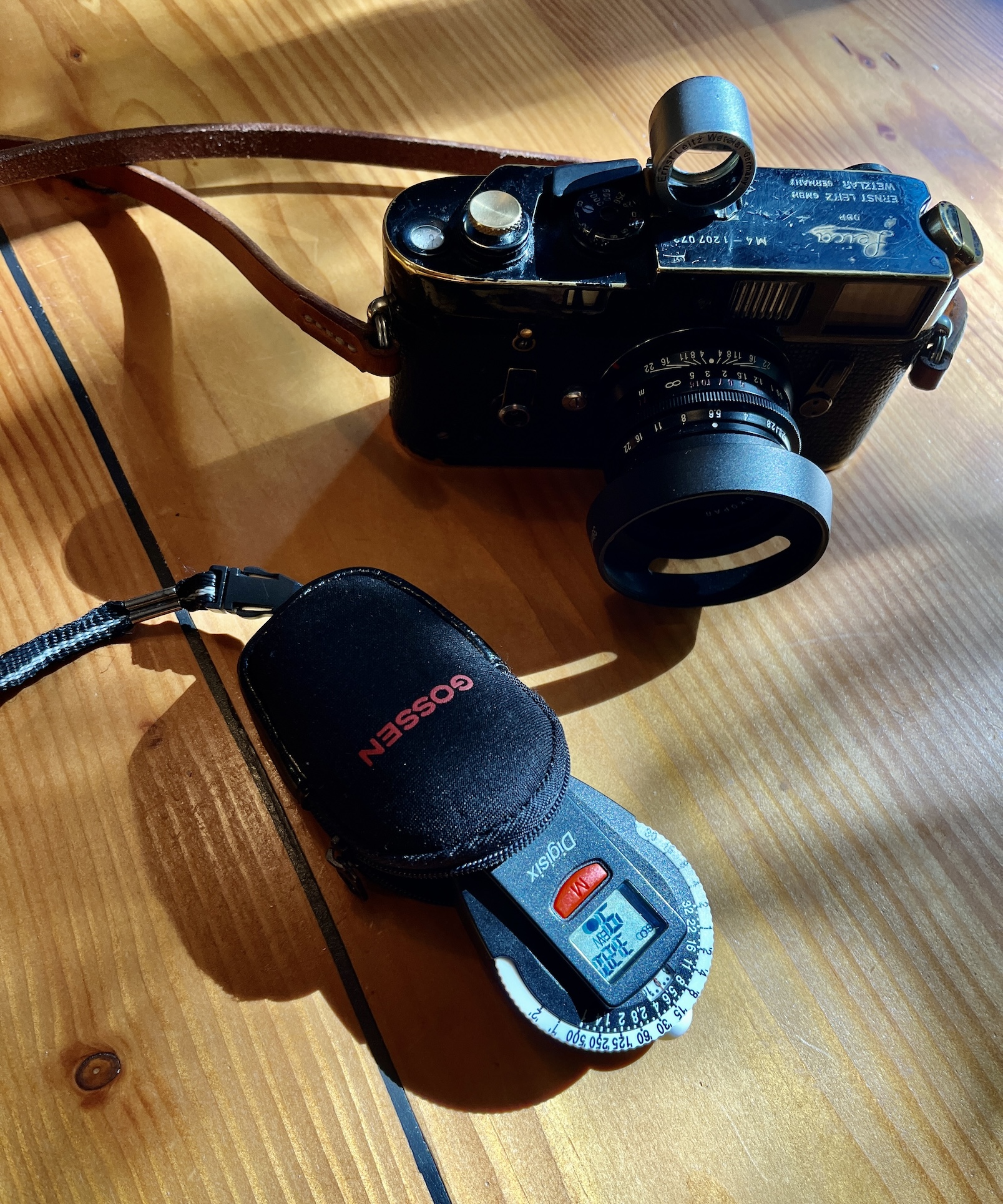

I have found the Gossen adaptor marketed by Gossen to be the best solution. I have owned my LunaPro from the 1970s and its reading is spot on. I also have a LunaPro F that takes 9 volt batteries, which I find just a little too large. And as with the Gossen Digisix, it eats batteries.
On the other hand, I find my Gossen spot meter impractical unless used as a shilely, preferring the more elegant smaller Pentax spot meter.
Until i started using it regularly, i found the Digisix to be a pain. Now i just carry extra batteries & have it pretty much dialed in. It's proven to be remarkably accurate. I mostly use it in incident mode. I far prefer it to any of the older much bigger Lunasix/pro et al. If i were replacing it, i might go with the Gossen 308. I just came back from a trip to Italy......i brought only the digisix (typically i carry both the Pentax digital spot meter as well). It worked very well and i'm happy with the negative densities. Personally i wouldn't mount it on my camera....but it's light and hangs around my neck or fits in a shirt pocket.
I use my Digiflash with a different pouch than the one supplied by Gossen. The pouch I'm using has harder sides, which makes unintentional pushing of the buttons difficult. The pouch also has a pocket big enough to hold an extra battery in a tiny "Ziploc" type plastic bag.

Yes, in practice I almost never use it in the shoe. I keep it in the shirt pocket and mostly pull it out for incident metering.

The Gossen Digisix meter has a 25-degree incident reading plus the ambient reading. Didn't you want something more narrow?
