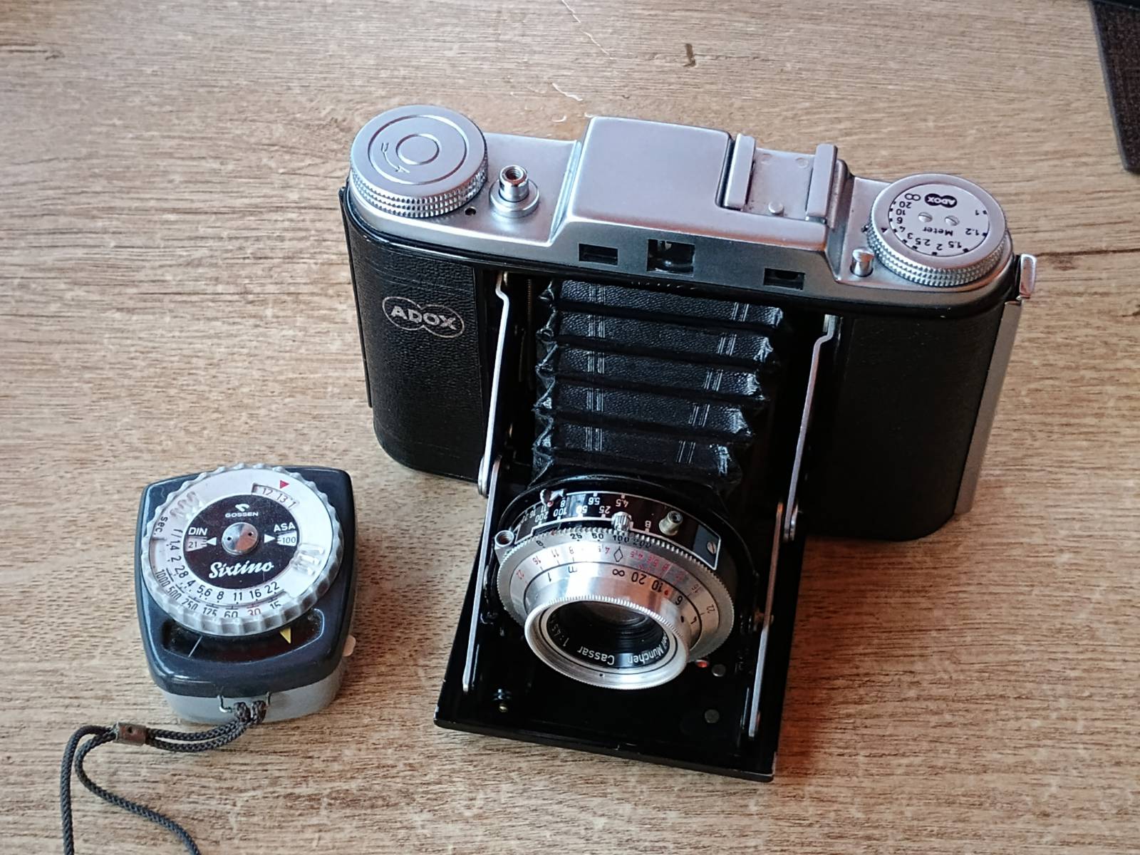

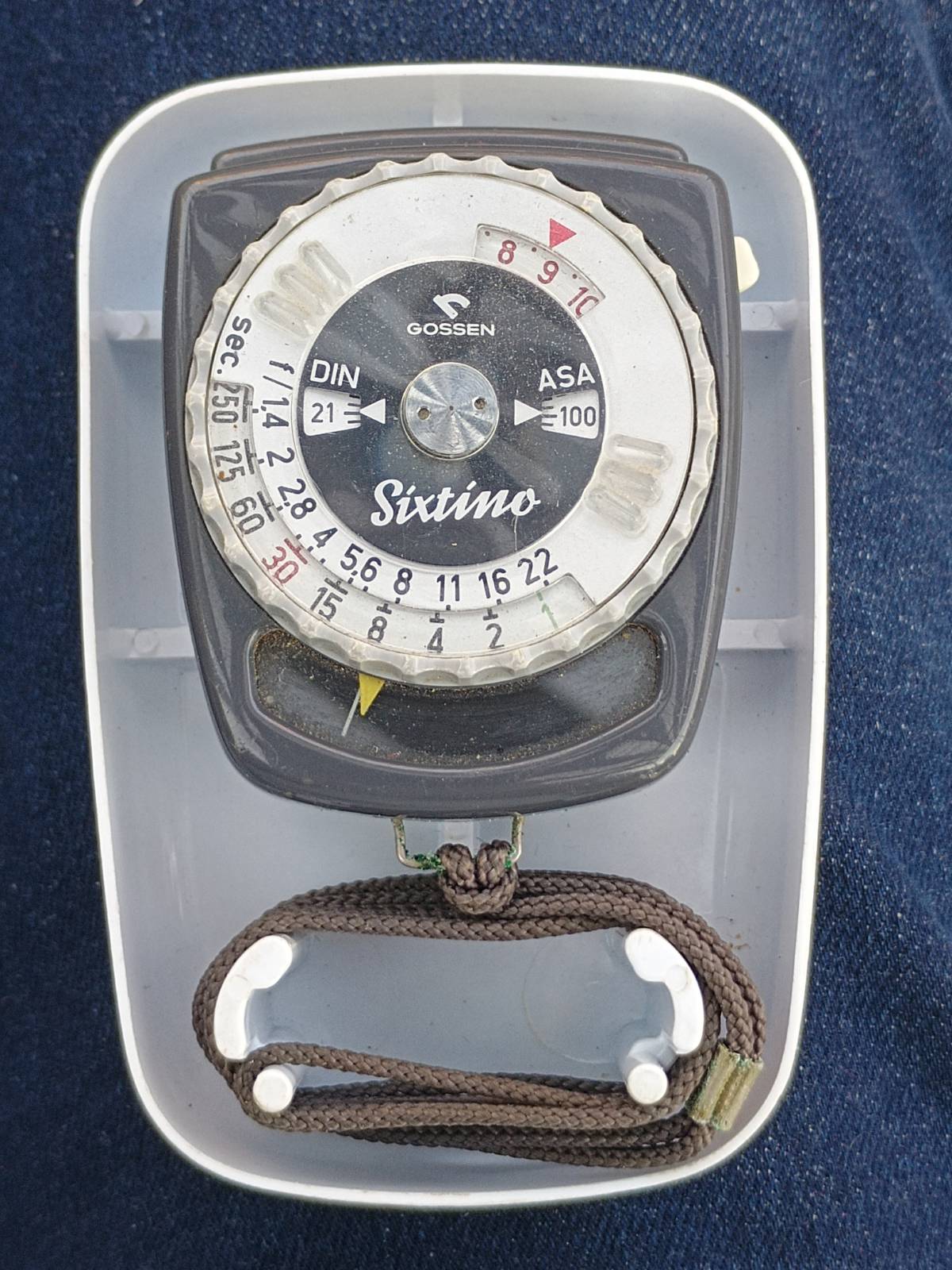

I can recommend the Gossen Lunasix 3. A battery adapter to replace the mercury cells is available from Gossen directly.
Small, lightweight and even cheaper is the Gossen Sixtino (Selen cell). My go-to meter for outdor use with the Canon 7, Rolleicord or Adox Golf.
In the USA market, this was sold as the Gossen Pilot. There are 10s or 100s for sale on the big auction site. The newest Pilot 2 versions are likely pretty good meters if the limited low light capacity of the selenium is adequate for your work.

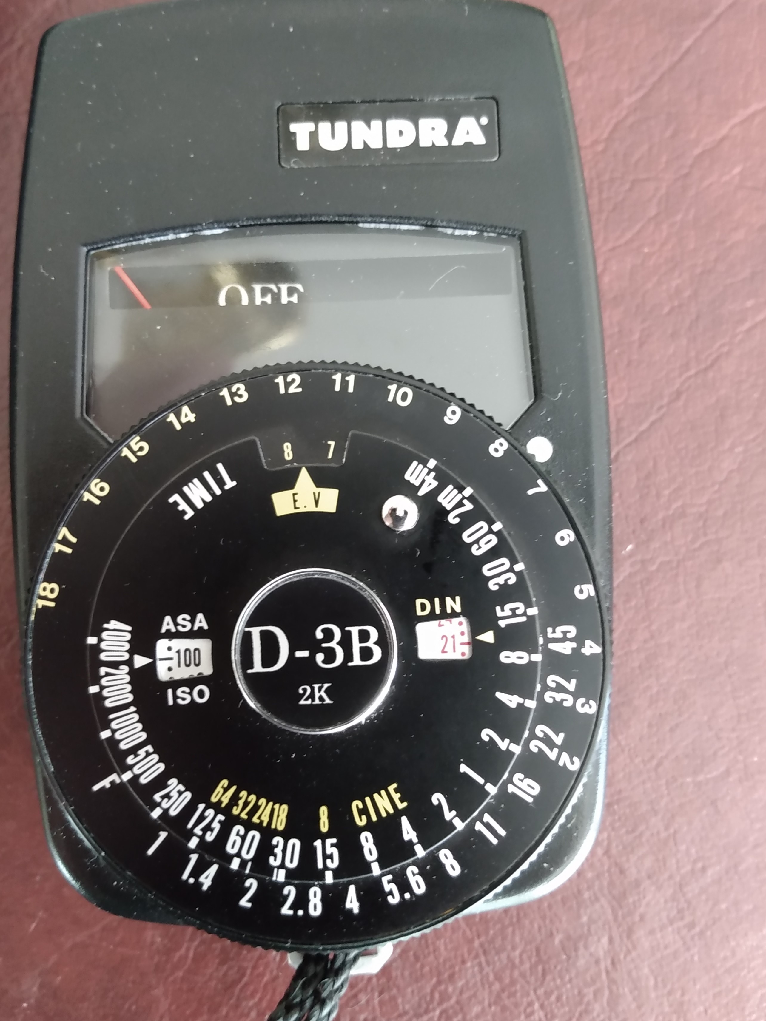

You want REAL cheap? A "D-3B 2K" CdS meter made by Capital (JA) and sold as Tundra (US), Bower (US), Jessop (UK), HAMA (DE), and likely many others. It is a dual scale (HI/LO) transfer setup, measuring EV then transferring that number to the exposure calculator. It has a wide range of sensitivity, is accurate and includes an incident lumisphere. And, it uses a silver-oxide SR44 battery, no a defunct mercury battery. They are all over eBay and dirt cheap - I got my "out-of-box," new, never used meter for ten bucks, many are less than that. It's my backup and works perfectly with my Kodak Retina IIc which sets up using EV.
BULL sends.
