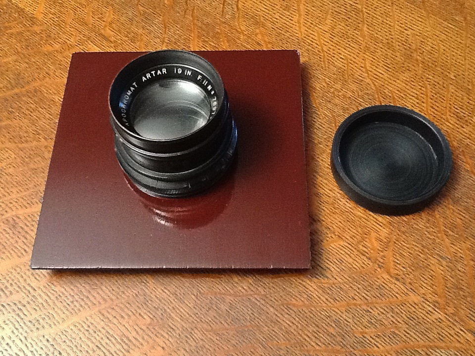

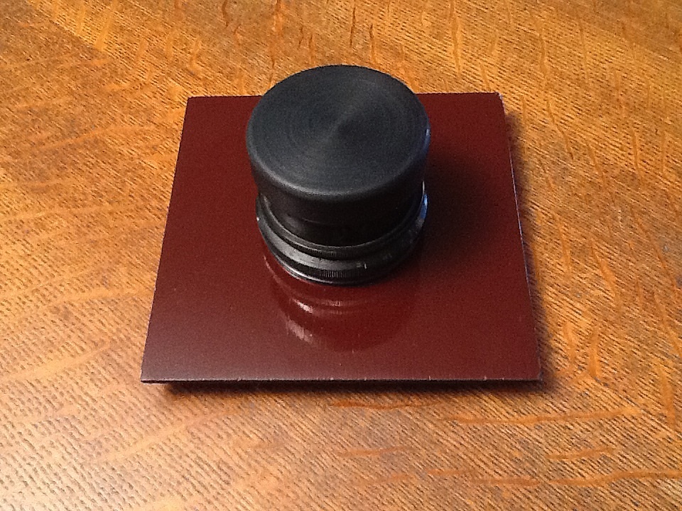

Lens cap for a recently acquired Artar, plus a quickie plywood lens board. The cap was made from a 2" ABS pipe cap, turned on a micro lathe and lined with some self adhesive velvet. The cap will also serve as a shutter. The boarded was made from a scrap of 1/2" Struct 1 plywood which I planed down to 3/8" thus giving the plywood a smooth finish and consistent thickness. I then cut the rabbets and bottom edge chamfer with my table saw. No flange for the lens, it just threads directly into the lens board. All my fears about this type of mounting have been aliviated now that the lens is frozen in the board. On the plus side the front element which was frozen is now free thanks to efforts to remove the lens from the board. Guess the lens is now dedicated to the 2D until I decide to destroy the board.
Roger

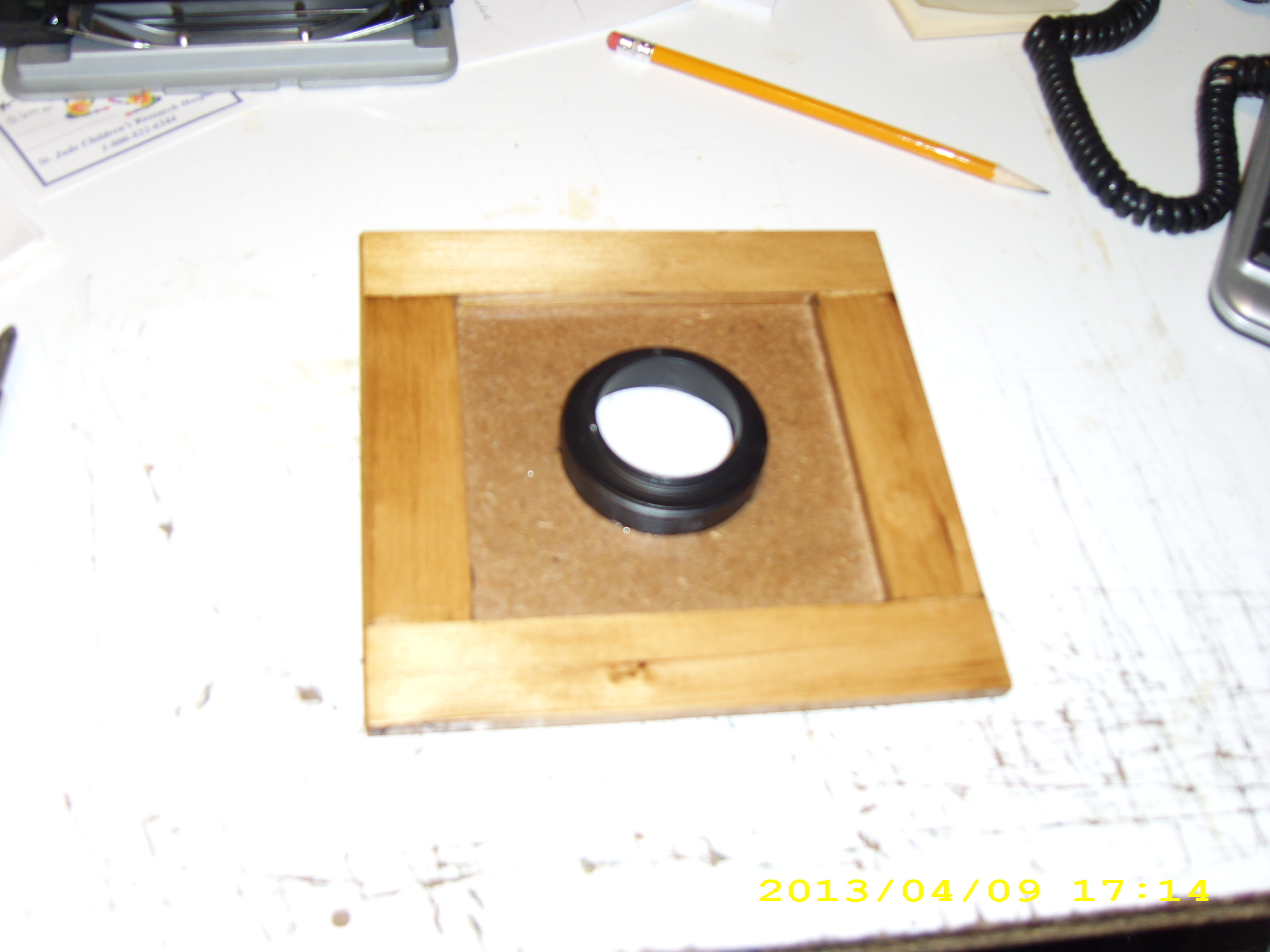

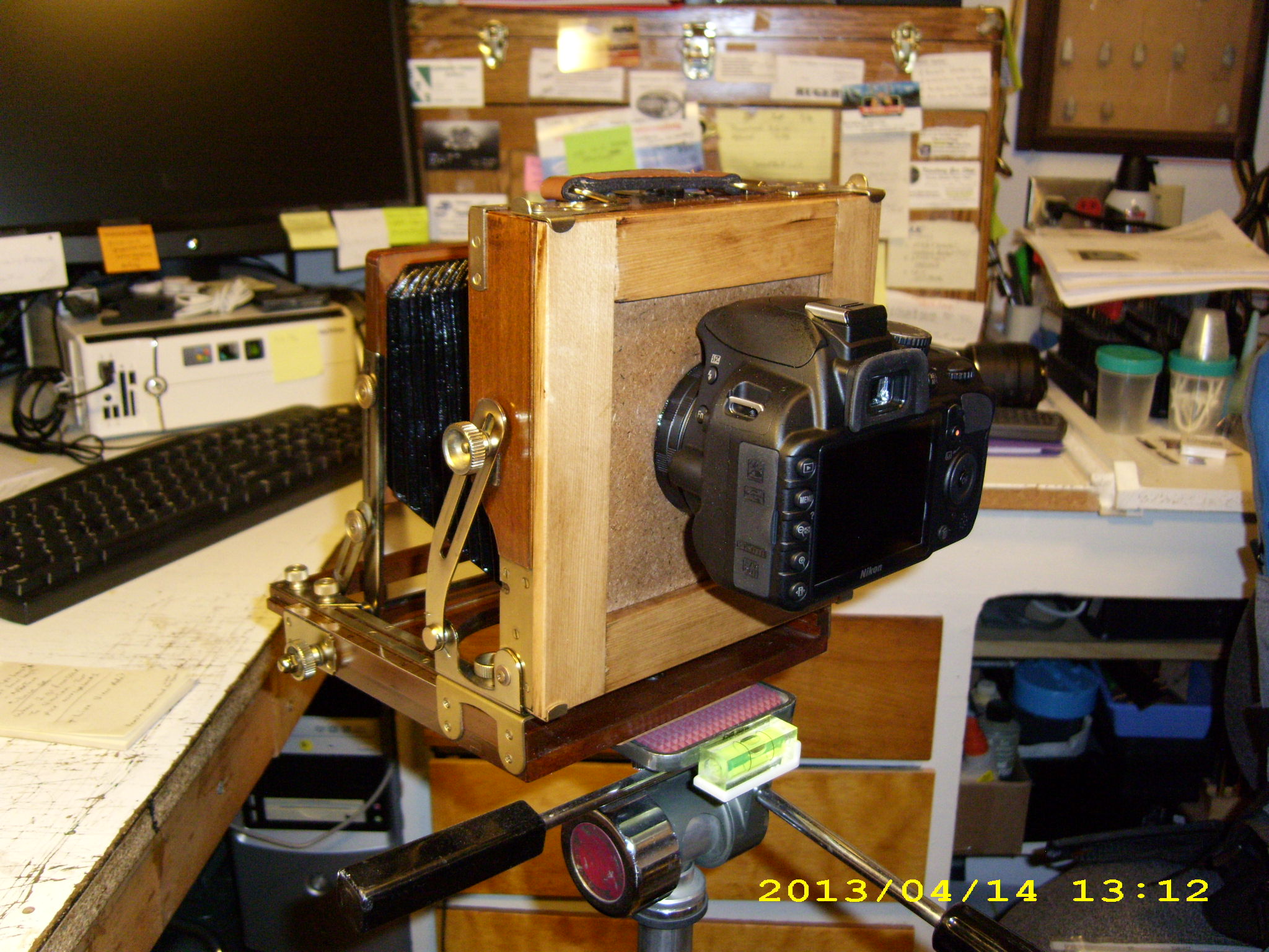

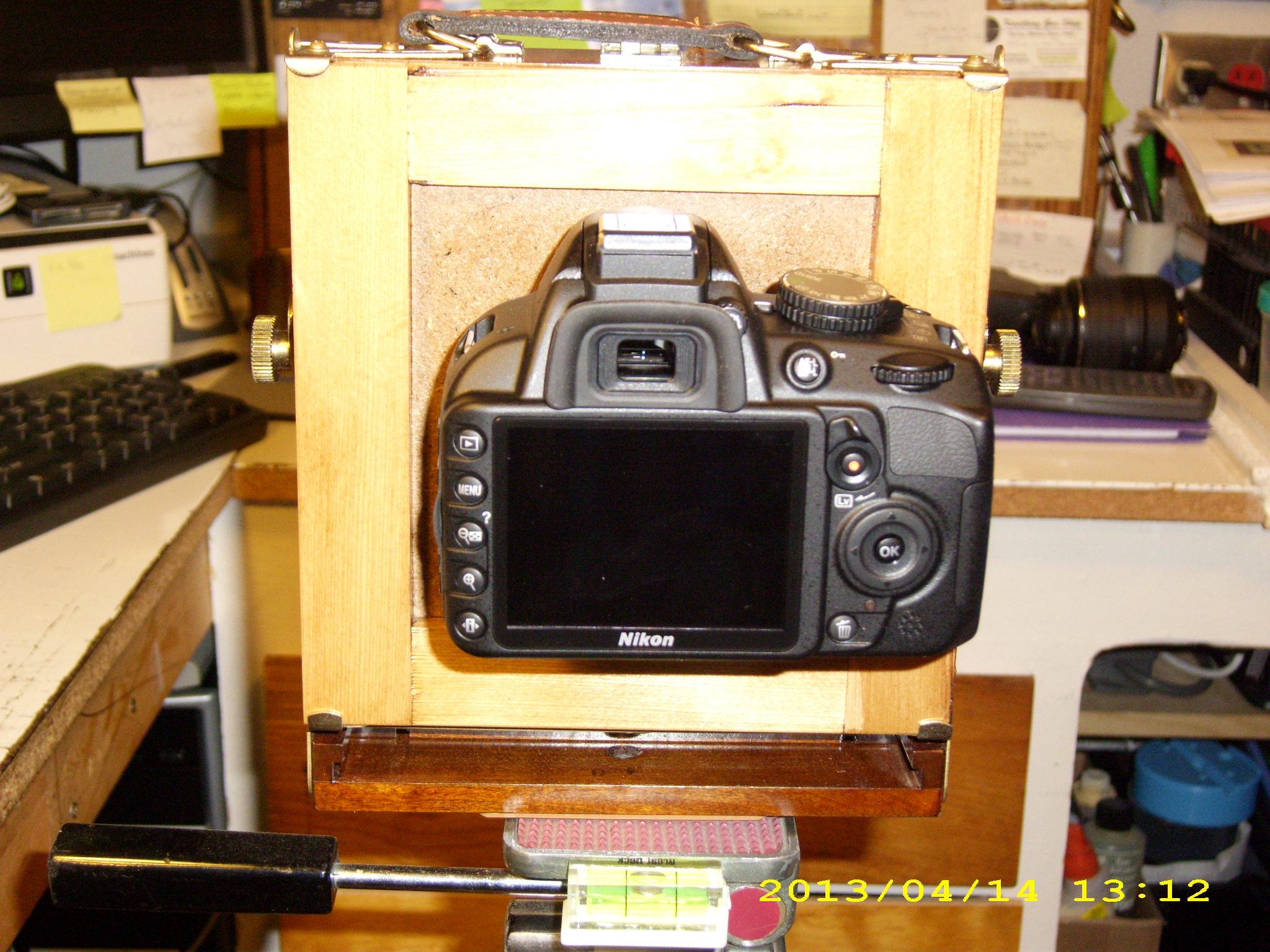

Digital to 4x5 Large Format
I have just recently jumped back into photography as a hobby. Photography was a large part of my life for about 20+ years
Then children and responsibilities took over. My 12x14 foot darkroom became more of a storeroom rather than a place to
develop film. Anyhow, I was looking through You tube, and there was a gent attaching a digital camera to a 4x5 field camera.
I was hooked! Even though this was put together badly, I knew that I could do on better. Not to mention the fact that I had two 4x5's and a vintage 8x10 field camera that was begging for a new life. So I did my homework, and found as much as
I could about the subject ( of which there is not that much ) I made a prototype to mount my newly acquired Nikon D3100
digital camera to my Calumet Wood Field 4x5 camera. I put the hole thing together, and it looks great. Now the hard part starts. How to make an image? I have been working with film for what seems like forever, but the new technology of digital cameras with all there buttons and bells---Frankly I'm lost. Included are picture's of my project. I need some pointers on the mechanics on getting a image on my camera. Any information would be greatly welcomed . Feel free to pass this along to other members that might have some information that they could share. My thanks to all the groups, and for the information that I have picked up that could never be matched. Thanks again, R delung ( from Seattle Washington ) where gray days are common.
