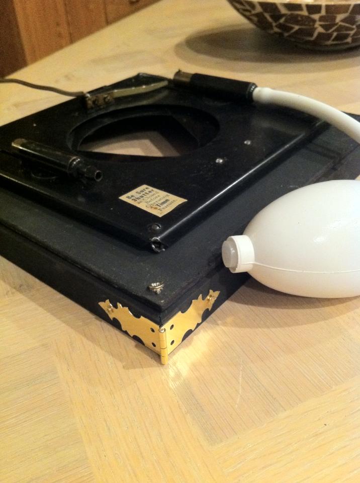

I finally made a housing for my giant (6 1/2") No. 8 Packard Ideal shutter so I could mount it in front of my shutterless lenses.
It only took two years of procrastination and an hour of actual work.
