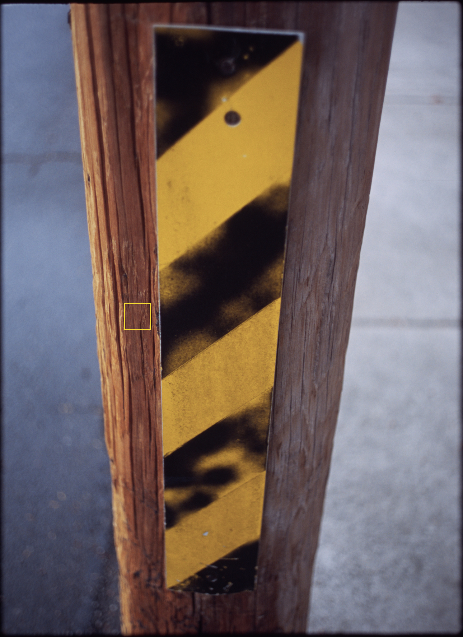

In fact, I'm impressed even with half-frame on a stopped down Olympus Pen D from 1965.
1 x 1 mm crop of Velvia 100 from the Olympus Pen D (24x18mm). Even at f/2.8 here, the lens and film outresolve my 7200 pixel long-side ability to digitize it, using Pentax K-1 pixel shift technology that combines 4 frames with a slight sensor shift.
I can see moving to larger formats if the grain bothers you. But with careful forethought, the resolution itself is not an issue.

What you've just posted, L., is mush, not detail. That tells me your "proof"scan isn't in focus at all. I'd rather see distinct grain than mush. I know what Velvia grain looks like; I've shot the darn stuff in multiple formats clear up to 8x10, although I've never considered it a versatile film.
That was the point: the half-frame film and lens is outresolving my ability to pick up all the detail even with a high end digital camera. It is correctly focused. I don't add any sharpening to my images.

Please don't complicate this with how pixels interpolate things. Film isn't pixels. Oranges versus apples. But yes, film can be a limiting factor. The point is, grain is apparent with even Velvia at enough magnification, especially in the darker areas. And Velvia wasn't even Fuji's finest grain slide film (Astia 100F was).
