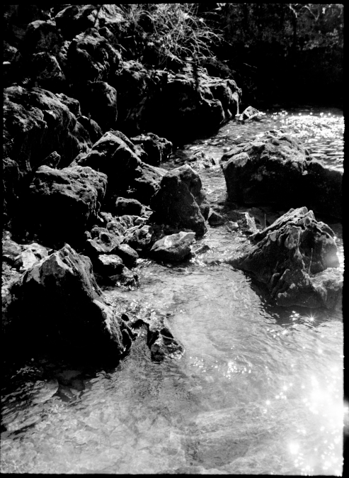

This is using it with half frame. It's only on crazy scenes like this where I wish I could just get a little more midtones. The shadows on the rocks have detail before my contrast curve, but I find if I try to make them look how I like, the water loses its good tonality.

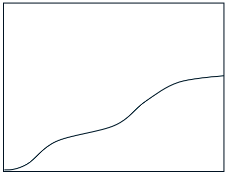

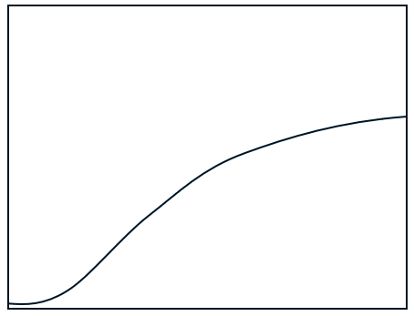

In reality, what you may get with (semi-)stand is something like this:
I.e. a strong compensating behavior that favors shadow and midtone contrast, but sloping off as density increases. Differentiation in the highlights will consequently be poor.

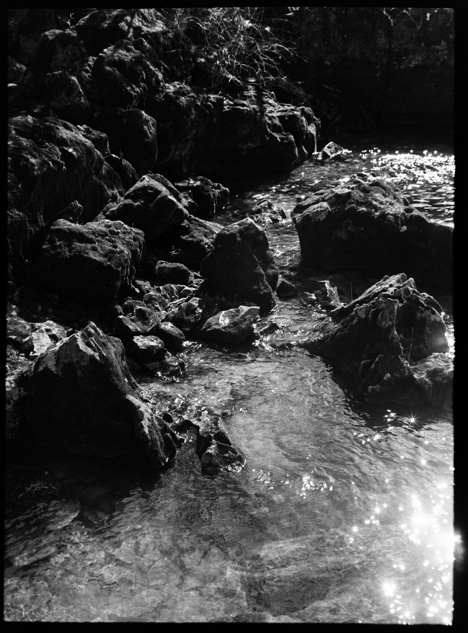

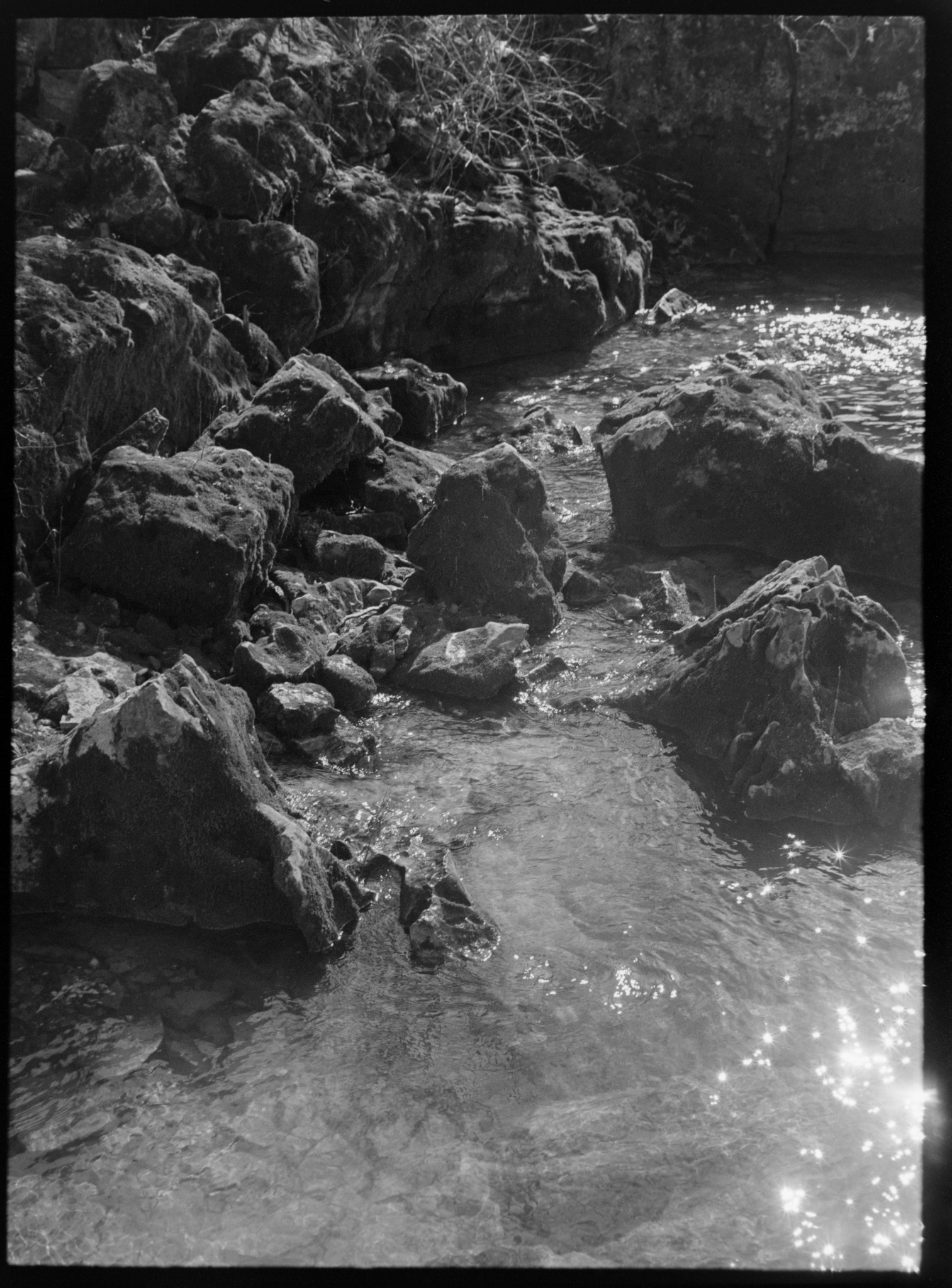

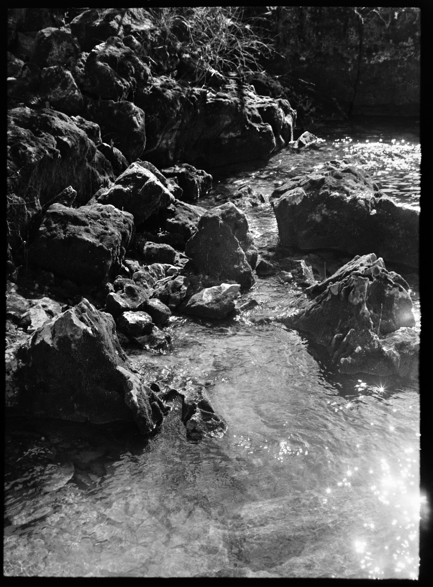

Thanks for all the discussion, it's been helpful. I tried a quick test of dodging the shadows up. I'd say it could definitely be worthwhile to do for an image like this. This was about five minutes of very basic painting the shadows and then applying the dodge blending mode, it could be improved with more time spent.
Unadjusted
Original contrast curve
Localized edits
