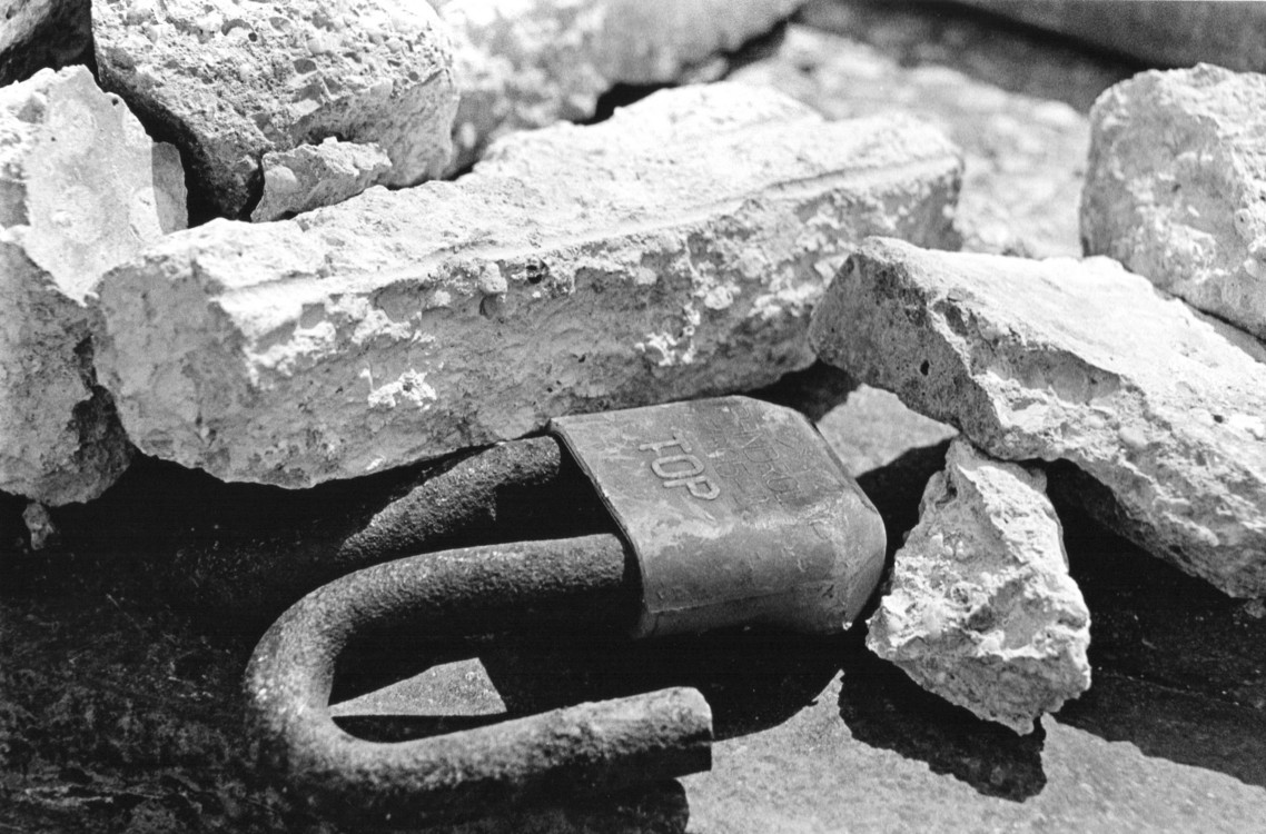

How "harsh" it is, in my experience, has everything to do with the manner of exposure and printing. You have to give it enough exposure to get onto the straight line of the curve, control the highlights, and manage local contrast. I do this through a combination of long, high dilution development, and split VC printing.
Here is a scan of a split VC printed silver print. The negative was from a hand-held Nikon shot with the film shot at full box speed and developed in Pyrocat-HD 1.5:1:300 and developed using Extreme Minimal Agitation with an initial agitation and short agitations every 15 min or so, with a total time of 60 min. I do not find this harsh or gritty:

chuck - It's obviously hard to correctly judge a print, let alone negative, over the web. But what you just posted does really look like "soot and chalk", with empty shadows and blown out highlight texture. And yes, I'd call it conspicuously "harsh".
Crysist - published curves in tech sheets are often abbreviated to conserve space, especially in terms of the shoulder being lopped off. They also tend to be printed way too small, with a minimum of grid intervals. They still help, but are no substitute for full scale curves done on logarithmic graph paper. Really, "families" of curves need to be plotted for any given film and developer combination to get the bigger picture. Certain important features which people have trouble even detecting in tiny tech sheet examples become quite evident on larger scale plots.
I see lots of detail in both highlights and shadows, except the most extreme (which *should* be approaching full black and paper white).
