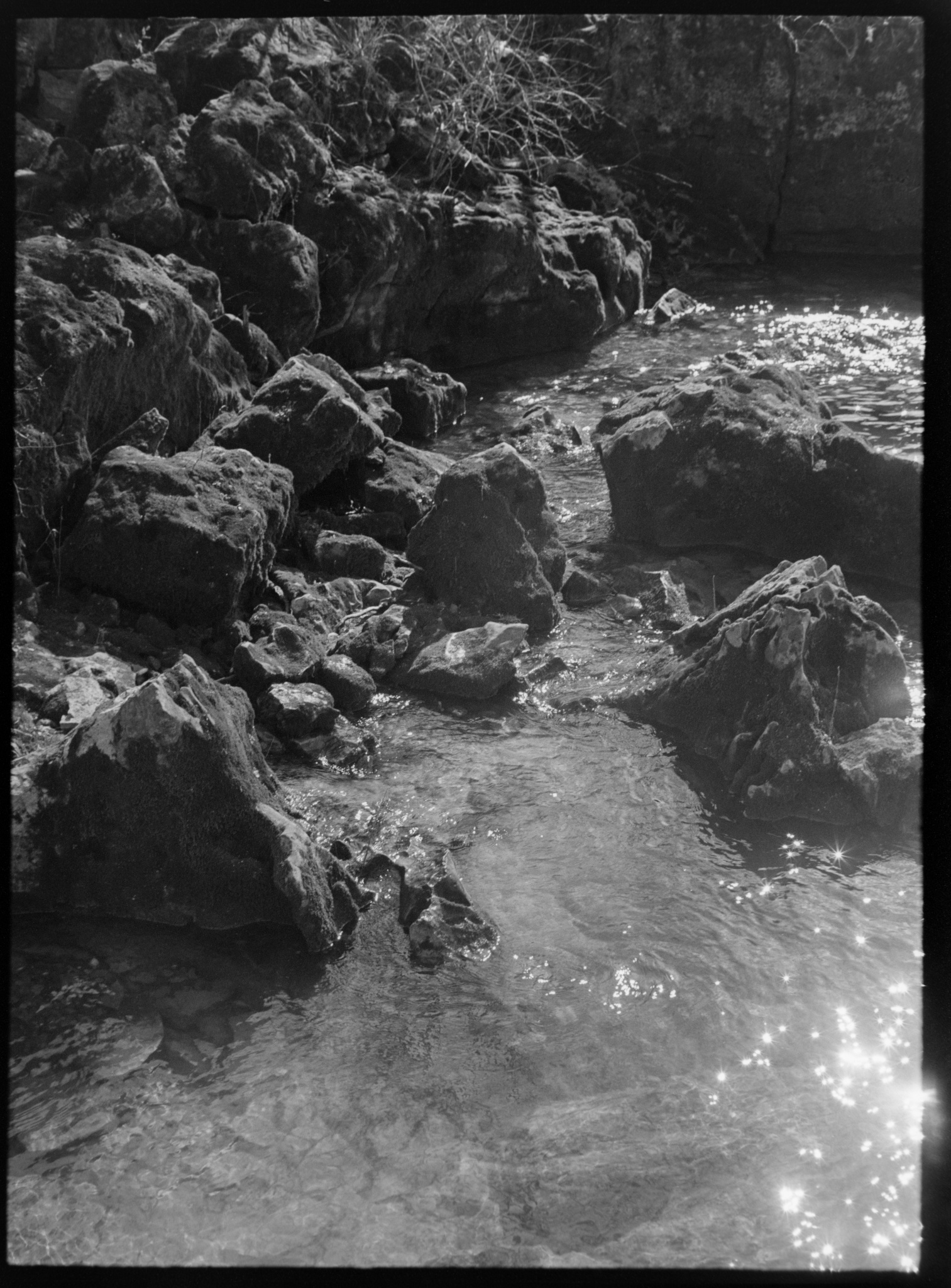

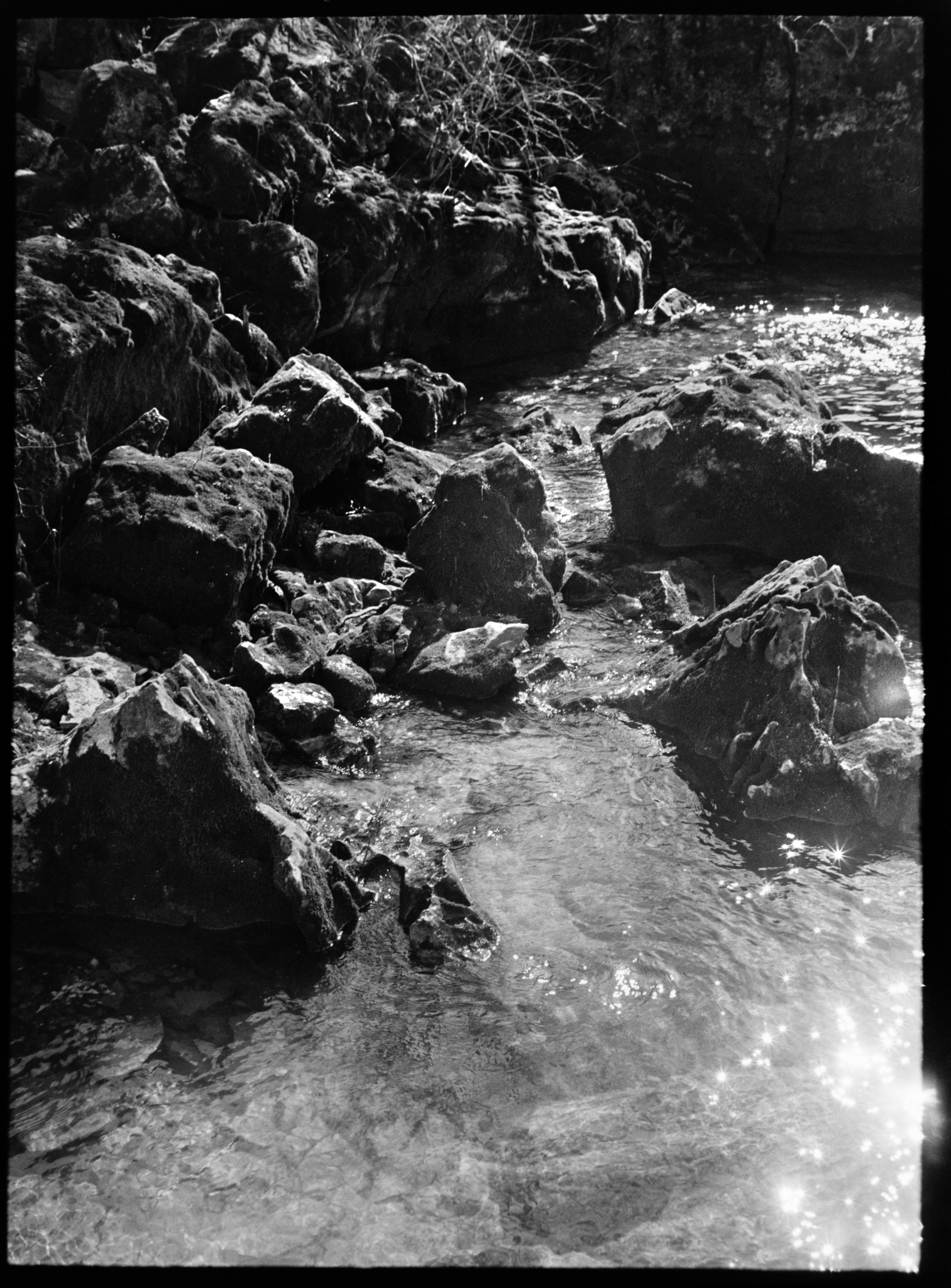

Thanks for all the discussion, it's been helpful. I tried a quick test of dodging the shadows up. I'd say it could definitely be worthwhile to do for an image like this. This was about five minutes of very basic painting the shadows and then applying the dodge blending mode, it could be improved with more time spent.
Unadjusted
Original contrast cu
Localized edits
Aaand...That shows how tastes differ, once again! For me, your unedited top image is by far the most interesting. The other ones are much worse. I just don't like the forced contrast, those crushed blacks. As I expected, playing with the curves did nothing of relevance.
