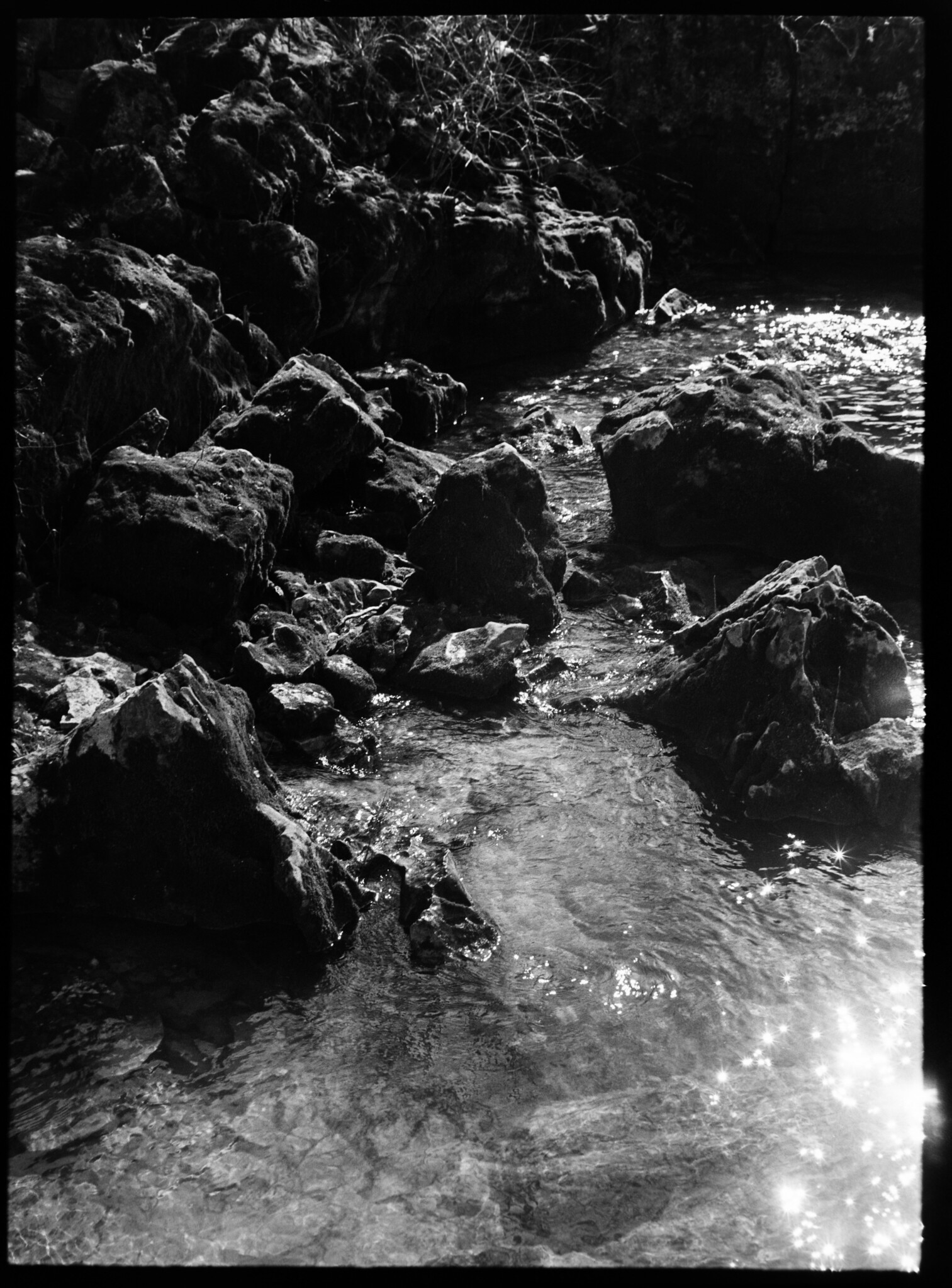

Aha! I stole my Rodinal HR-50 recipe from him. It's a good one.
This is using it with half frame. It's only on crazy scenes like this where I wish I could just get a little more midtones. The shadows on the rocks have detail before my contrast curve, but I find if I try to make them look how I like, the water loses its good tonality.
Maybe a job for selective dodging and burning? But I rarely adjust local contrast on my photos, I don't usually have the time.
Get very close, and place a nice incident meter near those rocks top of frame. Set the meter for half box speed when using that HR-50. Cut development time a little wrt what you used here. I think a little trial and error will get you there.
Making a good print (or digital version) takes some effort. I'd try to let go of the concept that a straight print/scan should somehow always result a satisfactory result.
Getting pleasing tonality in a print virtually always in my experience involves printing at one or two grades higher than what a straight print requires, and then selectively burn/dodge areas. With a photo like the one you posted, you could smash the entire scene flat through compression - but it'll be just, that: flat. If you want to bring out the 'drama' in the rocks while retaining the sparkle in the water, you'll have to expand the tonal scale in both areas. Since you can never do that in a single exposure, this means dodging & burning (or the digital equivalents thereof) will be necessary.
