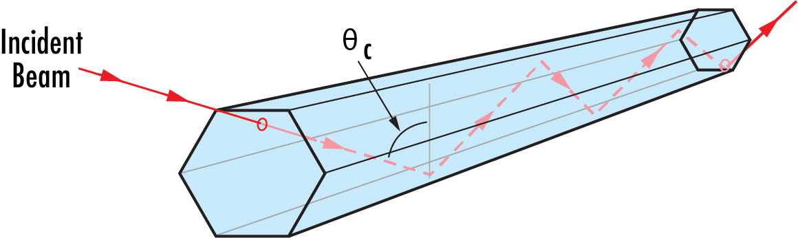

I was wondering if this enlarger has the fascinating optical light pipe. I believe it is made of optical fibers that are random and it scatters the light, like a mixing box would, but with less loss. For those that don't know, since the filters come in from the edge of the frame, if the light is not 'mixed' before it gets to the negative, only one side of the frame will have the color. Seems like a great enlarger; worth saving.
Yes, this is the enlarger that was gifted to me. I came with a 50mm Nikon lens. I have a Schneider that I use in my Beseler for my medium format that I plan to refit to the Vivitar.
I have one of these, they are actually a nice enlarger. The light pipe is not a bundle of fibers, just a solid what looks like an acrylic rod.
Ok, thank you for the correction. So it is maybe more like a light pipe homogenizing rod?
