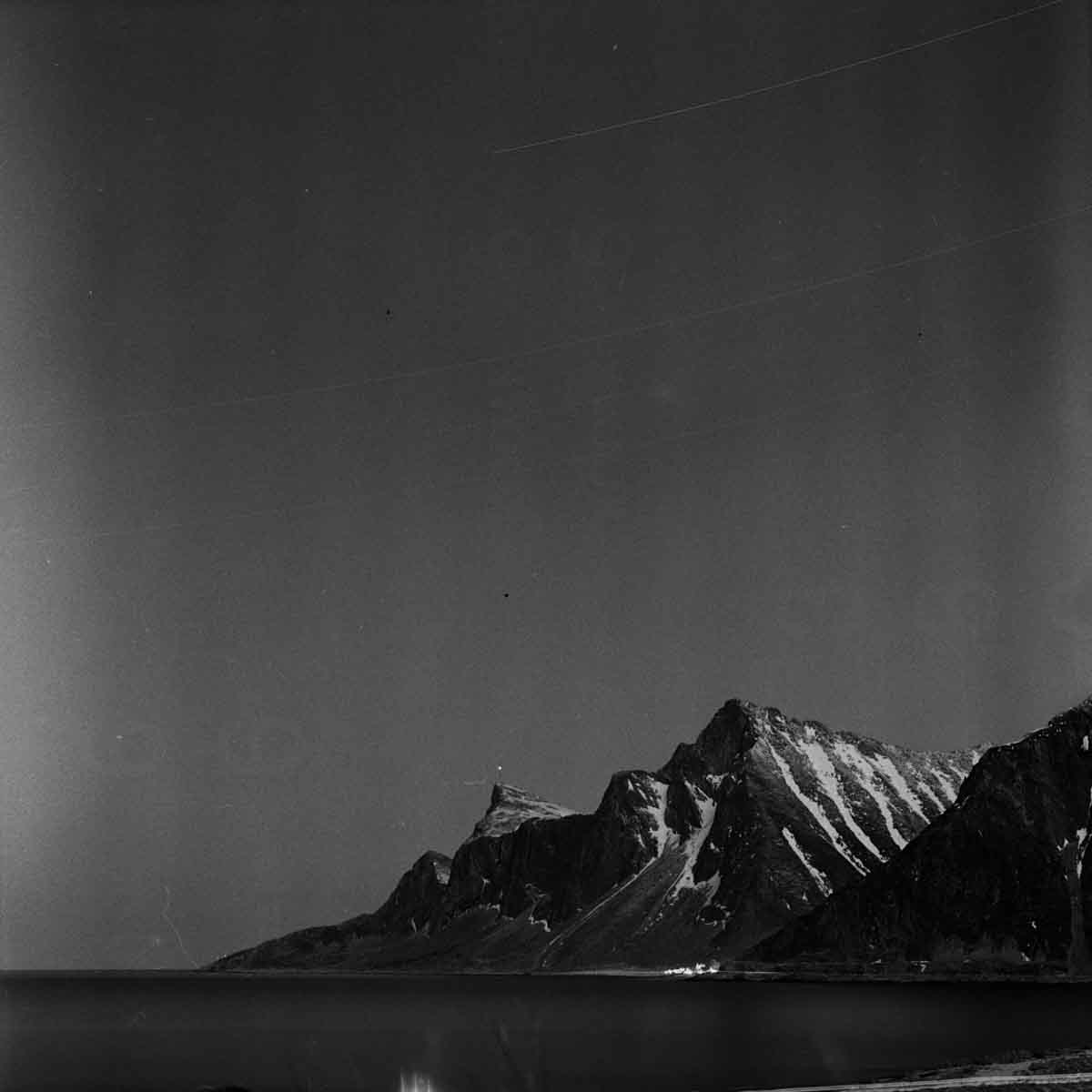

I just found this site yesterday after unsuccessfully goggling this problem and not finding any information.
I have had this same problem with Kodak TriX 400 consistently over the last 12 months since I started shooting film.
I have shot more than 50 rolls of 120 TriX 400.
I did email Kodak early on but did not receive any response.
My camera is Hasselblad 501cm with A12 film backs.

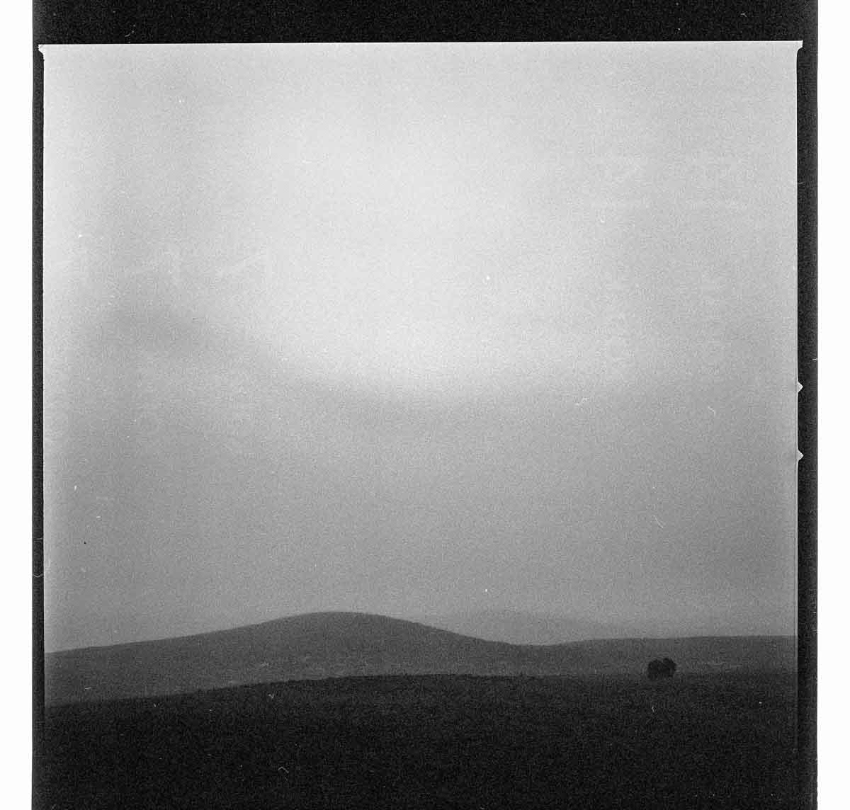

Here are 2 photos, not the best and have increased contrast to make it easier to see the imprint.
I am from Qld in Australia.
I store the film in my fridge and sometimes freezer until ready to use.
I have very many photos on many rolls of film with this problem, it seems to me that it is on a lot of photos but most you may not notice due to good exposure. it is more noticeable in areas of flat grey sky and when you add a lot of contrast or adjust a lot for bad exposure but has also appeared on good exposure shots as well. The point is that even though you may not notice it, I suspect the imprint is lurking discreetly in the image when this shouldn't happen at all and can become more noticeable when the photo is pushed more in the editing phase.
There is some banding in these photos as well, this i have narrowed down to my scanner having a problem (due to be fixed) and is unrelated to the negitive.
I am not getting up Kodak, I am just trying to understand why I am getting this problem.
OK, so its not X-ray, its not light leak because my film backs do not have any red window, could be due to hot Australian weather, also it does get humid here, the film was in my Freezer - perhaps fridge would be better?
