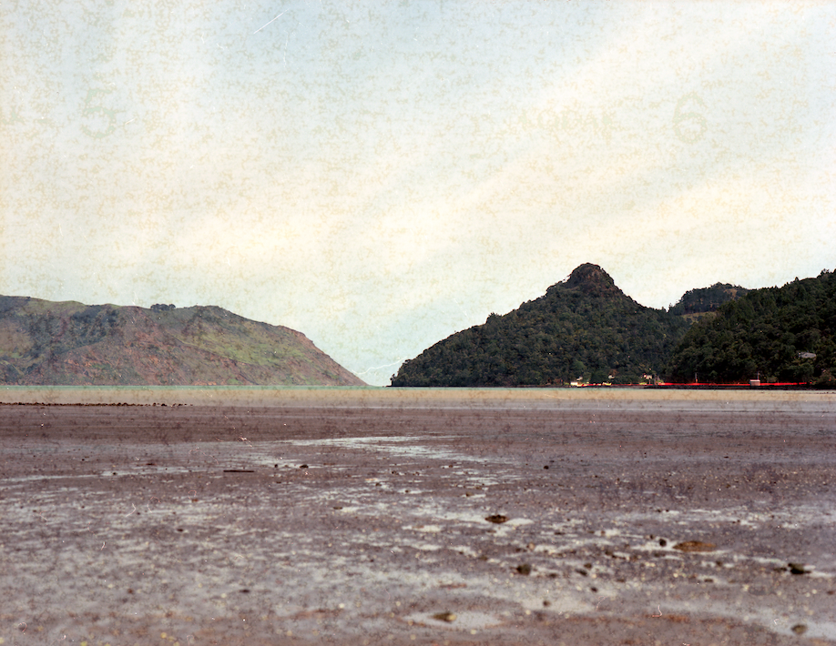

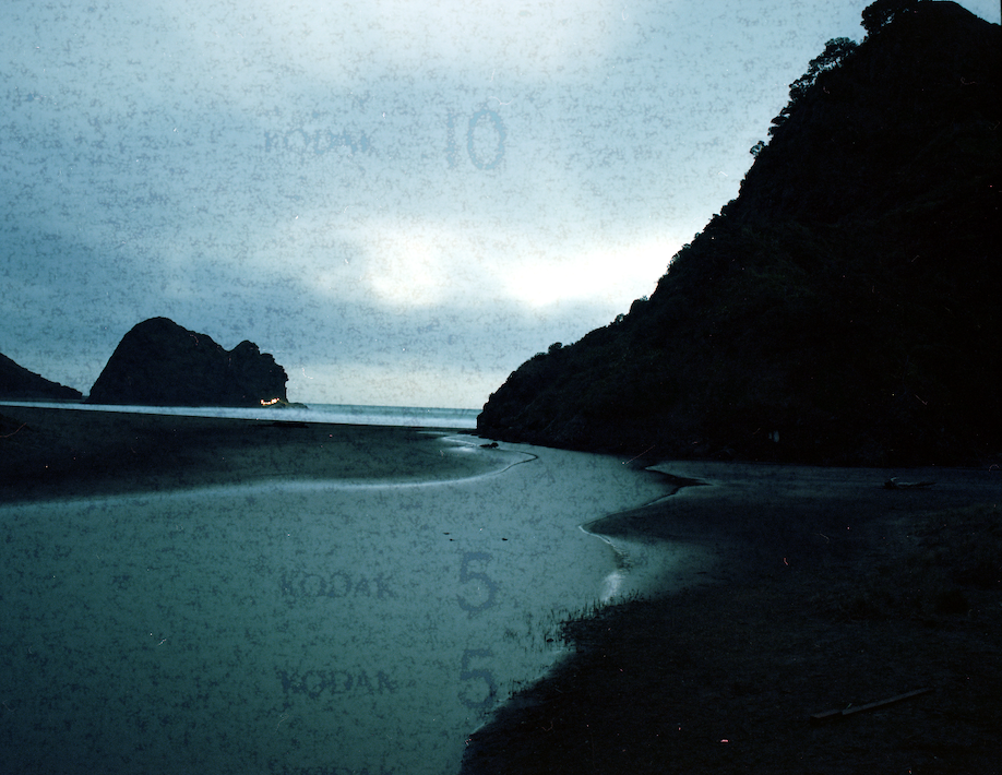

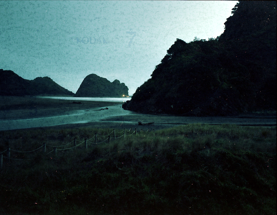

I am living in Auckland, New Zealand. I have just seen this and it has been my first encounter with this problem. The exposures with the problem were long exposures. Between 6 minutes to 15 minutes. Film I used was Kodak Ektar 100. I have attached some examples. Pretty keen to get to the bottom of it

Aaah. Another victim of the wrapper offset. Contact your national Kodak Alaris rep and they should replace all the film you have from the same batch.
Short version: this has been a known problem for some time, with something in the printing on the backing paper reacting with the emulsion. Obviously, only 120 is affected, and it's already been fixed (at least, last I heard).
These color images were clearly not on TMax 400 -- but I seem to recall that Kodak had unified their 120 backing -- all film stocks get the same paper -- as a cost control measure after having to switch backing suppliers.
Yes, the longer the film is in the roll, the more likely it is to show wrapper offset -- and Kodak is technically off the hook once the film is expired, but (presumably because this was a known, admitted defect) I read they had honored the warranty for these films as recently as earlier this year.

Thanks, good to be here, glad there is some information on this. I bought the film about 6 weeks ago and to my knowledge it was not expired. I thought it may have something to do with the length of exposure time being quite long ?
The artefact is caused by interaction of the backing paper and the emulsion of the adjacent layer, when the fillm is in spooled state.
There is no hint of the exposure being part of the issue.
Kodak Alaris either had no knowledge of certain batches being affected or did not bother. All it seems is that all films from that period went into retail without being called back. Some films showed the artefact, others not.
This policy of Alaris may be the cause that affected film is still in retail.

The problem is complex, there are several reasons for this different behaviour other than exposure time.
Can you give us the emulsion number and expiry date of the affected Ektar 100 ?

I do not have the packet that it came in or the box. I can just go off what I can see on the negatives.
Look for really tiny letters and numbers in amongst the edge printing near the end of the film.
Yes the negatives should have a batch number “engraved” rather than exposed, in one place on the edge (that way even if there was complete failure to develop you can still read the number).
You may be able to deduce whether the issue happened before you shot, vs after you shot. That’s because the numbers are rolled against a different spot on the “fresh” side vs the “rolled through the camera“ side
Send those to Kodak Alaris please.
Definitely contact Kodak Alaris. These days transportation is so much more of a variable, smaller shipments longer transit times. Kodak Alaris has been quite good about responding to technical issues. I shoot a lot of Kodak 120, I always order in the cooler months and refrigerate until use. I've been very lucky as a few years back this was happening to a Lot of folks.
It may be present in certain frames but obscured. Too bad looks like you put a lot of effort into your shots.
