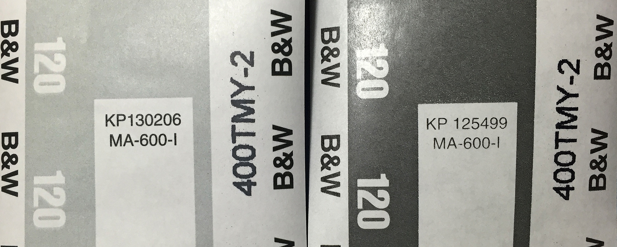

I just got done running 10 rolls of TMY-2 in 120, all came out flawless. I did notice that the color of the backing paper was different roll to roll, not sure which is the newer style but I attached a photo of them either way. The numbers shown on the paper were the same within the same color ( light grey VS darker grey ).
I'll just keep on using the product and keep an eye out but so far, it's business as usual.
