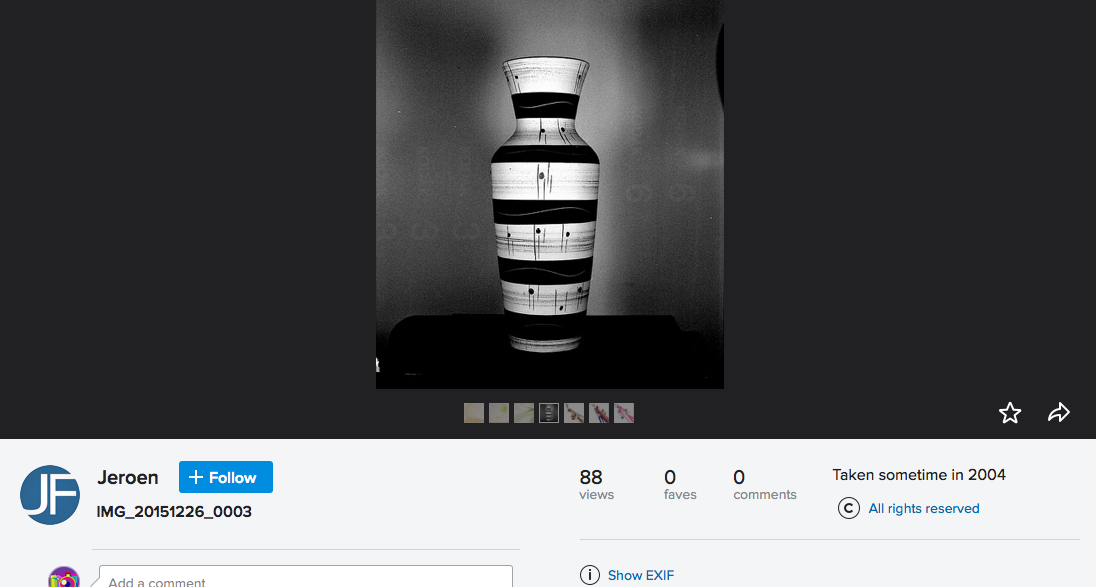

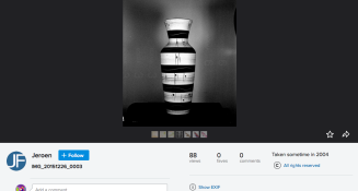

Here is an another example of the same issue, taken from the Dutch analogue forum. Even though it is written in Dutch, the link to the flickr account shows the issue clear enough.
Hallo allemaal,
Ik ben nog niet zo lang geleden bezig met analoge fotografie en ik zit nog behoorlijk in de testfase :smile:. Nu heb ik vorige week een 120 rolletje laten ontwikkelen en de negatieven thuis gescand. Nu bevatten de eerste drie foto´s cijfers en het woord KODAK. Ik neem aan dat dit niet door mijn fotografie komt ::smile:. Heeft iemand enig idee wat dit heeft veroorzaakt? (Ik heb de foto zo aangepast in photoshop dat de letters en cijfers duidelijk te zien zijn). https://www.flickr.com/photos/fortgens/23983342495
Bedankt!
Hello all, I am not so long ago in progress with analogue photography and I am still quite in the test phase . I now have a last week 120 film to develop and the negatives scanned at home. Now include the first three photos figures and the word Kodak. I assume that this is not by my photography is :. Does anyone have any idea what has caused this? (i have the photo as adapted in photoshop that the letters and figures are clearly displayed).

No:The flickr photo (https://www.flickr.com/photos/fortgens/23983342495), which Huub referred to in post #140, says “Taken sometime in 2004”, so not related with the recent paper facelift and most likely due severe storage abnormalities.
It was posted the day before yesterday, with the text that the film was acquired recently, processed by a commercial lab and good until 2018. So not from 2004 and definitely related to the current problems.
So it could have happened while it was in the mail to the photo finisher, right? So the only thing you can do, besides stewing in your own juices, is to contact Kodak and ask them if sending in a scan is good enough or should you send in the negatives.
Technically, anything can happen once the film is out of my hands.
In Shanghai, it costs all of $2 for same day courier delivery. I shipped the film in the morning and it was in the lab's hands by 4pm that day.
I'll let you speculate on how probable it was that the problem developed during the 7 hours the film was in transit.
So, he mistyped the year.
